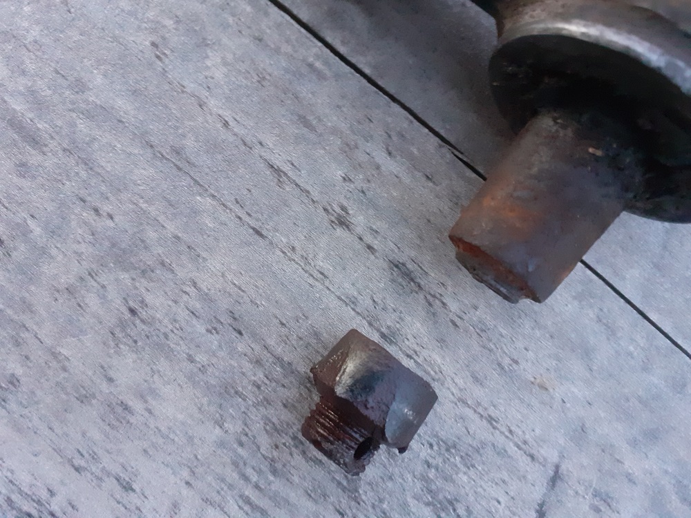

Hi all, my tie-rod broke at the thread. Can anyone confirm the size of the taper? Mine is 17.5mm to 19mm and the rod ends I've seen on line are a 14/16mm. The thread on the ram is 20mm.
The small piece I think is the remnants of a nut? It may have a slight taper.
   / Jinma 254 LH tie-rod #2
Why is the nut so worn?
   / Jinma 254 LH tie-rod #3

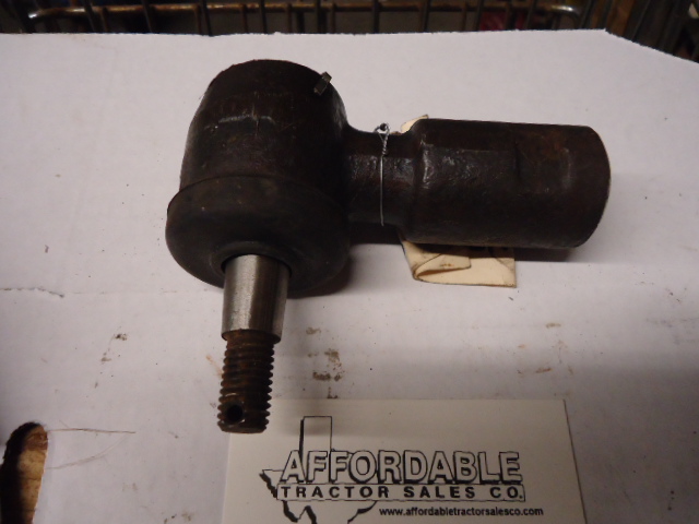

That rod end doesn't look like it's been connected to anything in years. Or it's been rattling around in the arm. Don't match that part. Match the new rod end to the size of the arm taper. The arm is probably hosed too if the rod end looks like that. :eek:
You may have to take a tapered reamer to the arm to clean it up. In the U.S. the tapers are designated in inches per foot. I don't know what that thing would be. :confused:

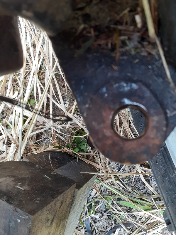

Picture not the best. what is the standard dia of the hole, and could it be sleeved?
The tapered section seems to be ok.
