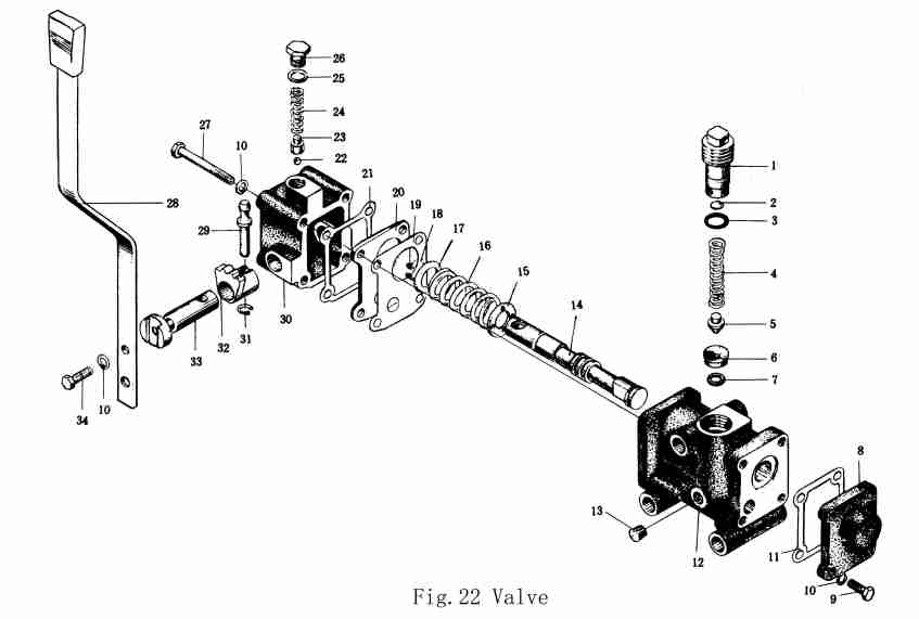

Like spiker said, make sure that valve down in front of the seat is not screwed down all the way. It has a round handle like a garden hose faucett. The setscrew he mentioned only needs to be removed to completely unscrew and remove the main valve shaft. It screws down into a notch in the main shaft to keep you from accidently unscrewing it too far.
I have an 05 Jinma, and the 3PH relief valve is located on top of the 3PH control valve block. It is a square headed pipe plug. The relief point is set by the number of stacked washers on top of the spring held down by the plug. You can take it out and put it back without a gauge as the plug screws down fully. But it is a good idea to verify the 3PH relief pressure. Mine was way too high from the factory...
If yours has the female quick connect comming off the 3PH valve, checking the 3PH relief pressure is no more difficult than screwing a 0-5000PSI pressure gauge into a male quick connect and plugging it into that rear QC fitting. Then you screw that control valve in front of the seat all the way in which sends all the fluid to the rear QC, which causes a deadhead and forces the relief valve open. The pressure read on the QC port is the relief pressure.
As to your problem, if the control valve in front of the seat is open and the lift dosn't start operating, the fluid must be going somewhere. Either it is still bypassign thru the valve into the reservoir, it is going thru the safety relief, or it is going into the cylinder and past a blown piston seal. A mechanics stethescope may help here. If you listen on the block in front of the piston down in front of the seat where that regulating valve is located , you may be able to hear fluid "wooshing" into the cylinder when the 3PH is commanded up(bad piston seal). or you may hear it on the 3PH control valve either thru the relief, or the valve internals are not even trying to divert the fluid to the cylinder. It is a rack and pinion affair thet moves the valve body. Here is a diagram of the valve from John's Jinma website(great reference info there:))
http://www.johnsjinma.com/files/HydValve.jpg

Update:
I finally found some time today to check into my 3 pt. lift issue. Thanks to Ron and Spiker I had a lot to go on. The adjustment of the valve under the front of the seat helped quite a bit. It had been turned nearly closed, so I opened it a few turns and the lift came back to life. There is something strange, however. When I first start the tractor from being cold, the lift barely creeps up (goes down no problem). But really slow upward even with the front valve opened almost full.
Seems like after about 10-15 mintues, it will start working better, but not great. Like I say, even with the vavle opened almost completely, the lift raiser "really" slow. I don't expect it to be fast, but this is noticably slow. The oil being used is #303 from O'Reilleys, and was just replaced a month ago by the previous owner.

Denny, I am assuming #303 is a type of Universal Tractor Fluid or UTF? The system operating better when it warms up is a clue that the hydraulic fluid is too thick. UTF is too thick for this type hydraulic system. You need some simple AW-32 hydraulic fluid for this system to operate at it's best.
IF you look closely at the back of the lift box, at the toplink structure which is bolted to the back of the lift box, you may see something unusual if you look closely in the lower left corner. Disguised like one of the toplink plate mounting bolts is the hydraulic reservoir drain. It may even have a dab of red paint on it, which they do on many of the drains and fills to help you identify them from the factory... Inthe case of the hydraulic sump it helps to have the tractor parked with the front uphill(and wheels blocked) to assist in draining all the fluid out.
Got no help with tightening the leaking plug, other than you can pull off the banjo fitting when you drain the sump to changeout the UTF:)
DId you go ahead and remove that setscrew and the speed regulating valve completely to examine it? IF not, it is probably hiding one last secret. The pointed tip of the valve is pinned to the end of the threaded shaft with a slot so that tip can move up and down. Installed the tip hangs down at the end of the slot. When you lift the 3PH, fluid flows up against the tip, pushing it out of the way so you can get full flow to lift. When you lower the 3PH, the tip, now down in the way, restricts the exit of the fluid helping to keep a heavy impliment from slamming down. If it is screwed in a little too far, it will allow the impliment to raise, then act like a check valve and keep the impliment from lowering. Since it is now locked with hydraulic pressure, you cannot then unscrew the adjuster. The fix is to back the impliment up onto a hill or jack it up to take the weight off of the lift, and the hydraulic pressure off of the speed reg valve allowing you to unscrew it...
