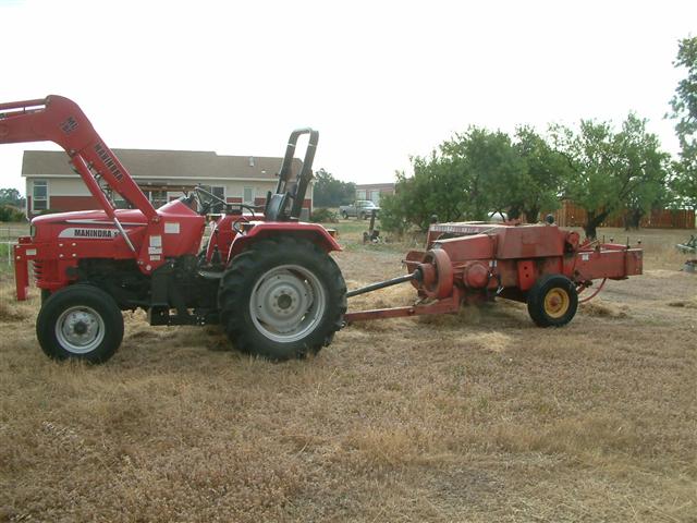

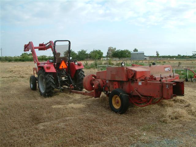

Looking to get into baling hay, i have about 4 acres on very flat river bottom ground.
Want to do square bales, any suggestions on what the tractor will be able to handle?
Your tractor weighs about 3000 lb and puts out about 24 hp (pto). The usual size square balers (14"x 18" x 30-50" long bales) like my Massey Ferguson 124 baler weigh about 3000 lb and the recommended pto hp ranges from 30-40 hp. That said, people have run this size balers on much smaller tractors like the Farmall Super A in this video (the baler part starts about 6 minutes from the start of the video). The Super A only puts out about 16 hp (pto) and weighs 2400-3400 lb depending on how much added weight is included.
FARMALL Super A - YouTube
So you could operate something like my 124 that cost me $2K about 5 years ago, which is a typical price for one of the old JD or NH balers similar to my MF.
The back and forth plunger motion from the baler can give a rough ride on a small tractor like yours, but you only have a few acres to bale, so that probably isn't an issue.
Good luck.
