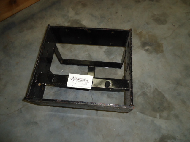

The only problem I have had is some overheating by the gauge on the dash. It seems the battery blocks over half the radiator. I replaced the fan belt today and added a set of gauges ( temp and oil pressure ) that way I will know for sure what the temp is running at. I have plans to relocate the battery but haven't had a chance yet. I am thinking of welding a bracket to the loader mount and setting it next to the motor in front of the brake pedal.

Will the new battery box work with the loader? If so how much.
   / Jinma 284 PTO HP for a finish mower #10
If you will send me pics of your I will confirm it for you, there is a bracket on there now that you remove, bolt this one in place of it.The only thing extra you have to do is make 2- lower hood mounting brackets that can come off this new bracket.
The drop down battery box was made for the flip up hood yours is the clamshell right ? only the top opens right ?
