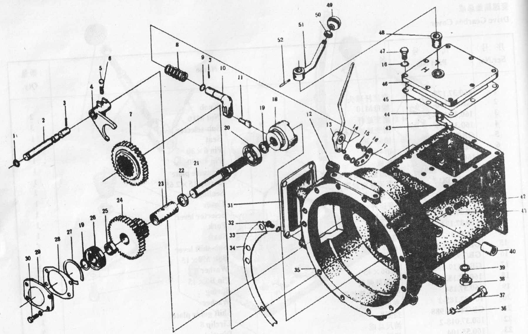

I see Ron caught it. You said Hi/Lo, and I immediately thought range select. I missed the part where you said "near the front top". That would be the creeper gear select. But Ron got caught up like I did - talking hi/lo instead of creeper engage/disengage - so I'll take another stab at it.
Yes, there is a spring and ball arrangement involved. The outside creeper lever (51) is connected to an inside finger (43). That finger fits on top of a fork (4) that moves a sliding gear (1) back and forth on a rail (2). The position of the sliding gear on the rail determines whether the creeper is engaged or disengaged.
The fork has a hole in it, and the rail has two grooves in it. One groove relates to engaged, the other to disengaged. The ball/spring (5/6) fits inside the hole in the fork. Although I don't agree with the diagram; I'm pretty sure it's ball first, then spring. The ball then sets in one rail slot or the other, depending upon where you move the lever. Note also the rail roll pin (3). If that's missing or broken, the rail will not remain stationary. Rare, but possible - that would cause the rail to move with the lever, rather than the gear sliding on the rail. And if/when you find that anything is missing - especially that steel ball - find it before operating the tractor. I had one fall into my transfer case once, which involved not insignificant tractor downtime and repair costs.

Hi Guys,
In reference to the diagram posted in Greg's post. The positioning of the detent spring and ball (5&6) is correct. The spring is installed before the ball. The spring and ball rest in a blind well in the shift fork and are captured in that well by the shift rail. I don't believe there is any way to inspect the spring or ball without removing the shift rail.

+1, the spring is in the bottom, and the ball is pushed down on top of it with a punch, then the rail rod with the grooves is slid in over the compressed spring and ball. The top right hand pic in the link I posted shows the cast pocket where the spring and ball go fairly clearly... No way to inspect the spring and ball, unless you remove the fork from the rod. But the hole in the top does allow you to see if the fork is moving far enough to align the hole with the grooves.
   / Jinma 284 transmission jumps out of gear #9
Ok, I think I get it now. The other spring and ball slide rails I've worked on detente from above or from the side. If I read you right, in this application the ball and spring install below the creeper rail. Thanks for the clarification
