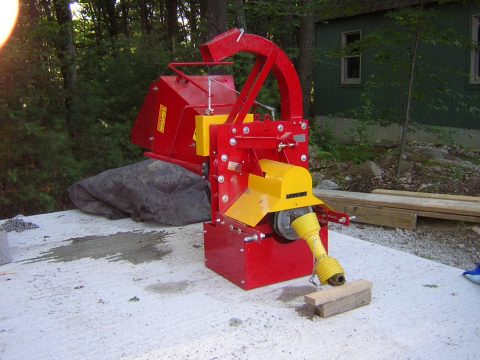

I posted pictures and a review in the implement section a couple of days ago. You'll have to wade through some real uninformed opinions on Chinese Labor if you read through the end of the thread, but the first half dozen postings are pictures of my 6" Chipper. It's down in the middle of page 2 last time I checked.
DIYGuy (MarkS)
