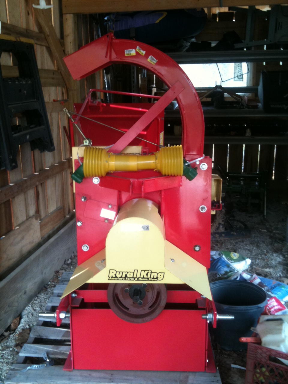

I was really holding out for a wallenstien but at this price I had no choice!
Now that I have it I know there are some things to address before using it.
Bought quality replacement belts
Tighten every bolt on it
Adjust and torque the blades
change the oil in the feeder gear box
put 6mm set screws in the feeder drive shaft
Anything I'm missing?
