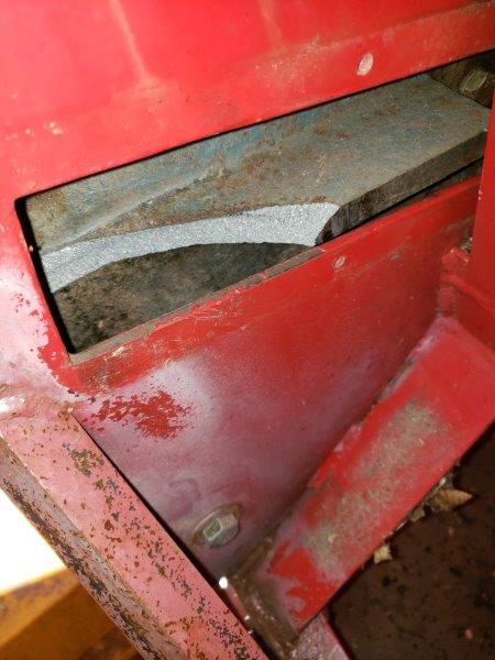

Looking at that knife, I'd say it was bad heat treat. They have to be through hardened but then stress relieved of they will fracture. You can actually 'normalize them' yourself in your wife's oven (if it's electric). Normalization of through hardened steel takes about 450 degrees for an hour or so with a gradual cool down to ambient.

I had no problems with this for years. A final post mortem and thinking about the root cause is that the anvil or knife or both cracked from hole to hole along the length...from a small stone last summer I think. As the crack progressed the anvil final separated and ran into the knives flying by and eventually tore off both of them. Flying debris took a chunk off the back of the flywheel.

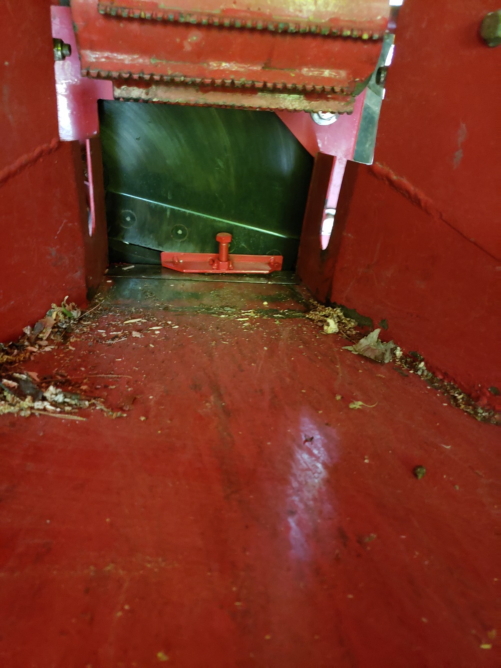

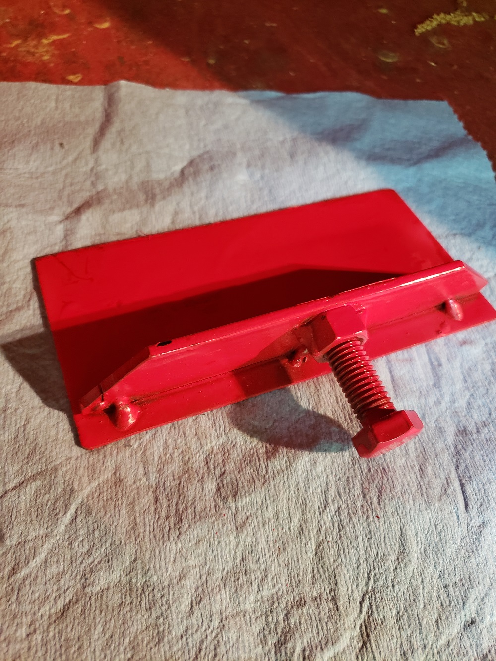

I made a simple gauge to set the clearance. It was always a PITA to check with feeler gauges so I had some stock around .070" and made this gauge, complete with a removable handle. It worked great.
