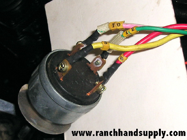

I have an intermittent bad connection in the wiring of a JM 224, such that no power goes to the ignition switch, dash is dead, and no power to starter solenoid. tractor will turn over when the solenoid is shorted across the terminals. Poor connection seems to be in fuse panel. Tapping on it will bring power back but I can't find a bad connection. HOw do I check it out further.
I note recommendations to replace ignition switch and the instructions on one of the links refer to wire numbers, where do I find these wire numbers on the actual wires themselves?

jboyce, I have tried to attach a picture of the back side of the ingition switch.

excellent photo; thanks
