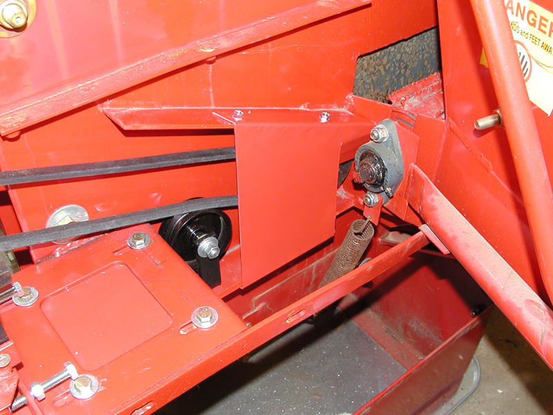

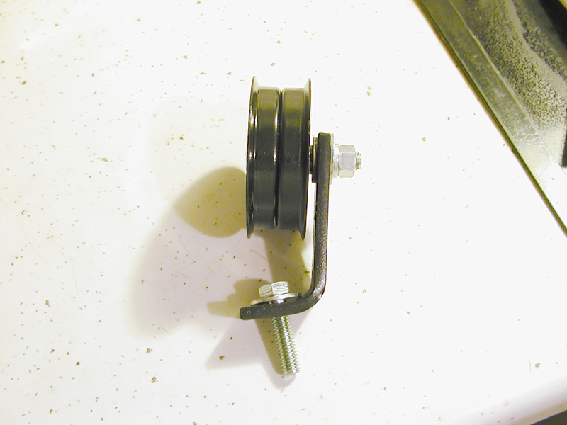

Here is a photo of the cover plate. It shows the plate, the idler pulley and the long v-belt. It also shows the relief that had to be made to accommodate the spring action. Another photo shows how the idler pulley bracket was made.

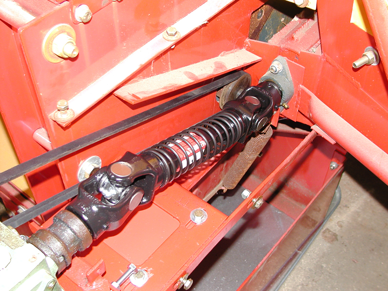

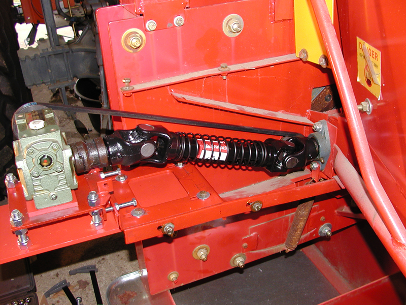

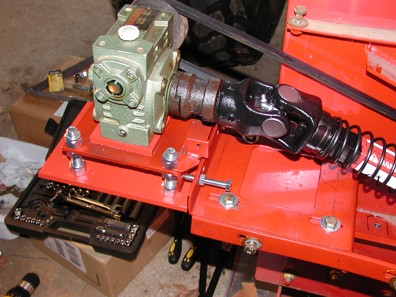

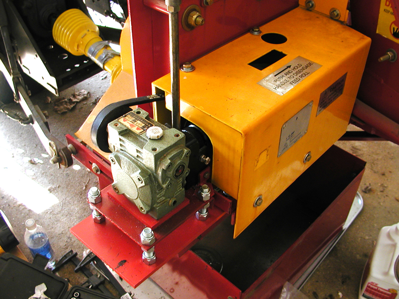

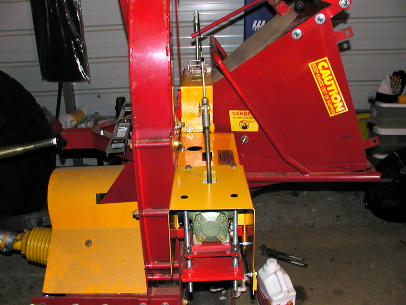

Here are some views of the drive shaft mod. It shows the set-back of the gear reduction unit, the elevation screws, v-belt tension screws, etc. The gear reduction unit is sitting on a 5/16 thick by 6 inch wide cold-rolled steel (very strong) plate that is bolted to the chipper frame using the original adjustment holes. This allows the same v-belt adjustment as before. You may also notice that the plate that the gear reduction unit originally sat upon has been turned upside down and the direction reversed. This allowed the use of the bent piece of the plate as the push-point for tightening the v-belt. I had to drill and tap two holes for the adjustment bolts. I used all of the original hardware (exept for the knub joints and shafting) and bolted the assembly rather than welding it as it will be disassembled later for the hydraulic mods. You may also notice an additional small plate under the gear reduction unit. This plate gave me an extra 5/16 inch clearance to keep the v-belt from hitting the chipper frame during flop. However, after I put the idler pulley on to prevent flop, the plate became unnecessary as the idler pulley lifted the belt 1 inch above the chipper frame and prevented any flop. In one of the photos you can see the marked location and mounting hole (under the drive shaft) for the idler pulley.

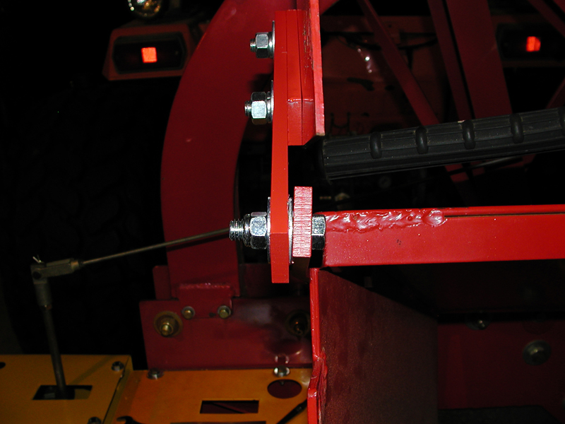

   / Jinma (Farm Pro) chipper mods

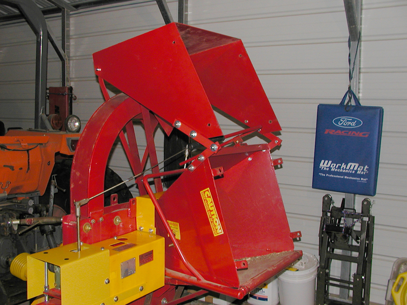

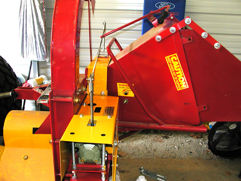

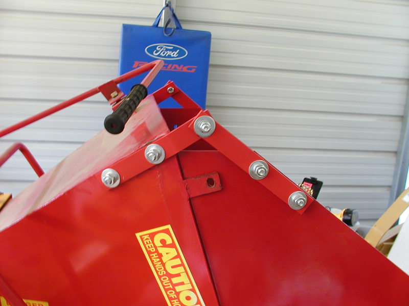

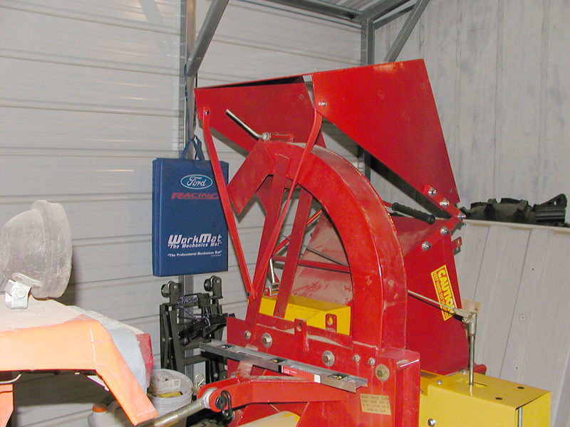

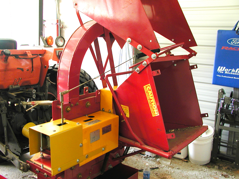

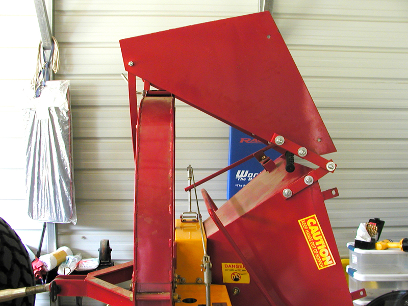

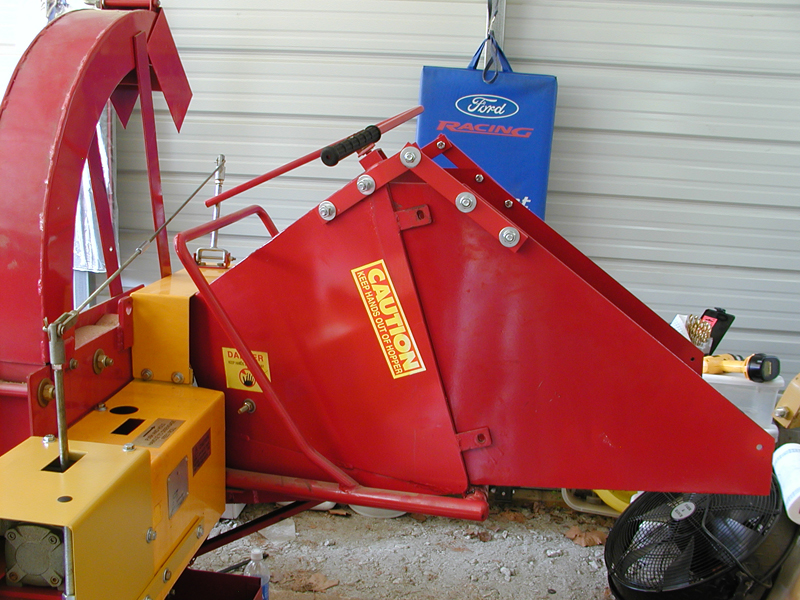

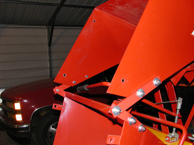

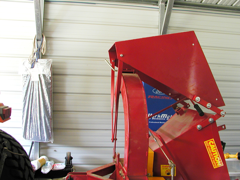

Here are some photos showing how the feed chute can be raised or lowered. The photos show it in the up and down positions. When down, the feed chute is secured to the chipper using only the two bottom sets of bolts/nuts as the hinges serve to secure the top of the chute. They also show the hinges that allow this and the bracket that secures the feed chute to the exhaust chute support. The bracket is made of two pieces of 1-1/4 inch by 1/4 inch cold-rolled twisted steel. This is a very rigid Vee shape that allows the chipper to be either transported or stored in the up position without having to worry about safety (having it fall unexpectedly). You may also notice the little metal enclosure that was made to cover the gear reduction unit. Anybody know where I can find matching yellow paint?
#9
Here are some more photos of the hinges that allow the feed chute to be raised or lowered.

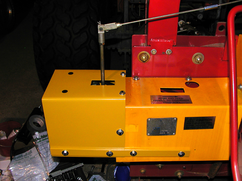

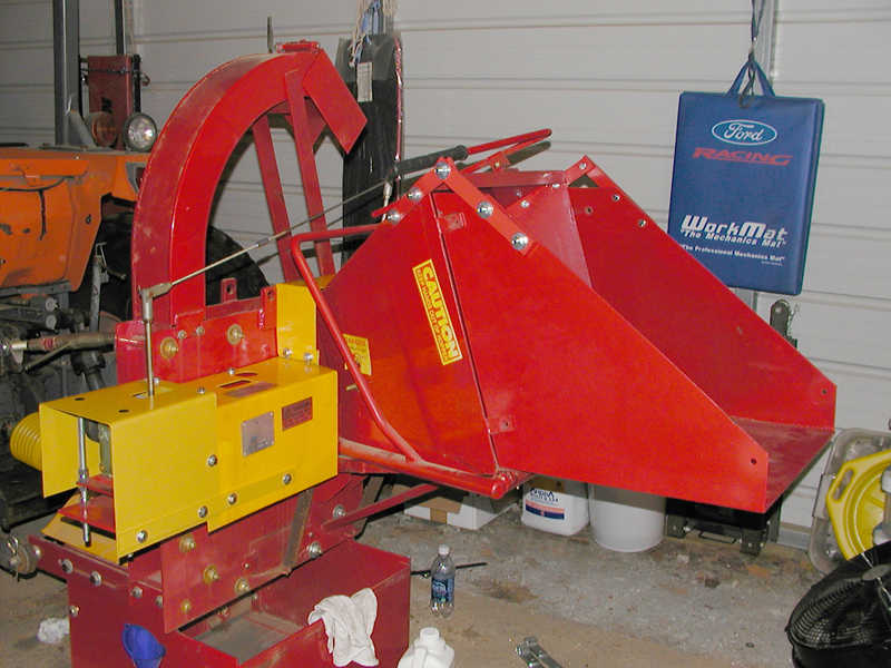

Here are some more photos showing the cover I made for the gear reduction unit. The first photo shows the reduction unit sitting outside of the original cover. It also shows the cutouts I had to make in the original cover to accommodate the drive shaft and v-belt.
