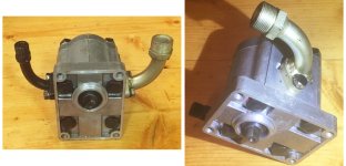

Another thing I did was have custom adapters made for the pump so I could put quick couplers on the hoses. Saves a lot of mess as you can see by the video.

That filter is on the return line from the sump to the pump and It is probably(should be) a strainer and not a filter as filters on the suction side can cause issues by restricting flow. My JW-03 did not have a filter, it did have a strainer(#100 mesh) on the pump suction line inside the tank. I added a 10 micron filter, but you want to push fluid thru those so I placed that filter on the return line coming out of the control valve and back to the tank. I had to do one other small modification also as they used a restrictive banjo bolt where the return line connects to the tank. This line should have no restriction or back pressure on it but that fitting caused enough back pressure at full flow to blow the seal out of my filter assembly till I replaced the fitting and line with a plain elbow and hose barb. been working fine for years now.
Thanks for the VERY timely reply! I was heading to our hydraulics shop to get the filter installed when I read your great post. I was able to get rid of the banjo fitting as you advised. Thanks very much for all of this info, Ron, and I'd love to see a video of how you reinforced the bucket.

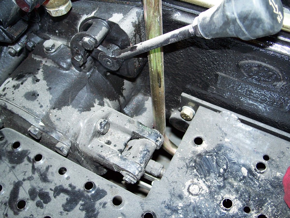

Ok, I got everything hooked up for the Jinma JW-03 backhoe. I put 5 gallons of hydraulic oil in the tank. At this point I'm confused about which levers have to be engaged for the backhoe to work. What is the sequence for getting the backhoe ready to operate? The manuals are quite confusing for someone who has never operated the tractor before. It's a forest of levers to an old man's eyes, ha ha. Thanks.
   / Jinma JW-03 backhoe manual desperately needed ASAP #17
If the pump is mounted and plumbed properly, you have to turn on the PTO. There should be two levers to do that. One by your right foot, Step on the clutch, all the way down and push down on that lever. You may get a little gear grinding so make sure the tractor is at idle and hold the clutch all the way down for a few seconds. Push the lever down quickly to keep the grinding to a minimum. You may need to adjust the clutch, but that is another subject entirely.
The second PTO lever is near the back of the tractor and should be marked 540 and 1000. It has 3 detent positions. 540 - N - 1000. This lever only controls the speed of the PTO shaft itself and has no effect on the PTO driven pump for the backhoe. Just put this lever in the center (N) position to keep the PTO shaft from turning.
Once you have the PTO engaged and the pump running the hydraulics will be live on the backhoe. On mine the levers were plumbed differently than every other backhoe I had ever run, so I swapped a couple of the hoses around at the valve body. The labels are now wrong, but it works the way I like it to.
just move one lever at a time until you figure out which lever does what. I will look tomorrow and see if I can find any diagrams that describe the functions of the levers.

According to his picture he's using the upper tang drive live PTO, which turns all the time at engine speed. Or am I missing something?
   / Jinma JW-03 backhoe manual desperately needed ASAP #19
You are correct. The lever in this picture turns on the PTO system. Push down to EN-gage. This must be engaged in order for the internal tang shaft to be used.
The lever at the back is a speed selector for the 6 spline PTO shaft. It has a neutral position so that you can stop the PTO shaft from turning while still powering the internal lug at engine speed. This is handy for safety if you don't have the screw on cover for the shaft.

Getting rid of the banjo also gets rid of another issue. It caused the return fluid on mine to return in a high velocity straight stream which entrained a lot of air(shoot a straight stream from a garden hose into a bucket to see what I mean). These air bubbles would flow down past the pump supply port and get sucked in, causing the pump to make noise. Once I got rid of it, the pump got real quiet...
