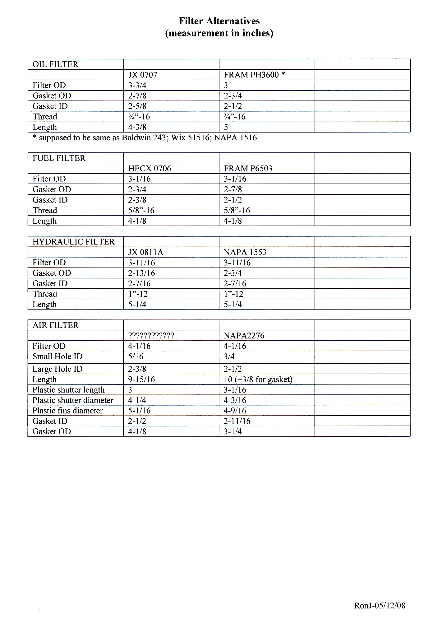

I haven't had much time to get on here lately but I'm still looking for after market filters for my Jinma 254. The stock filter numbers are: Engine oil filter JX0707 Hydraulic oil filter JX0811A Fuel filter HECX0706
Thanks for any help,
Ash
   / Jinma Oil Filters #10
Ash,
I have the 284, but believe the filters are the same.
The attached picture shows what I have been using. Check your JX0707 threads. It appears that there are 2 types with that same number. Mine was 3/4x16 thread and I used the Fram PH3600.
There is also a JX0707 with M20x1.5 threads. This SUPPOSEDLY can use Wix 51381 or Baldwin B-173S.
RonJ
