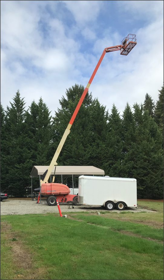

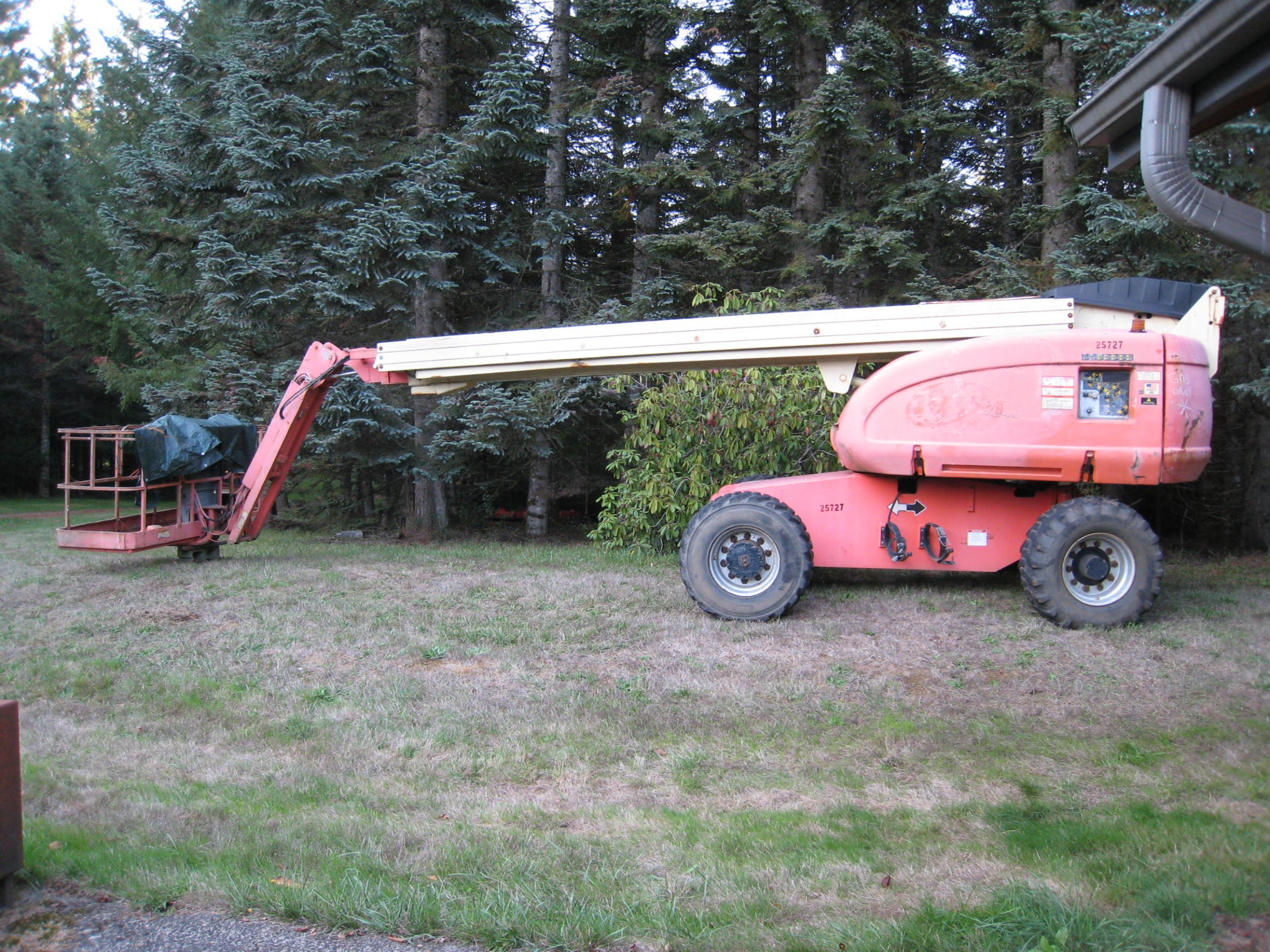

Few months ago I bought well used boom lift from a local contractor and decided to start a thread regarding my experience with it so far, and also perhaps find members here who may be willing to share their experience with a similar boom lifts.

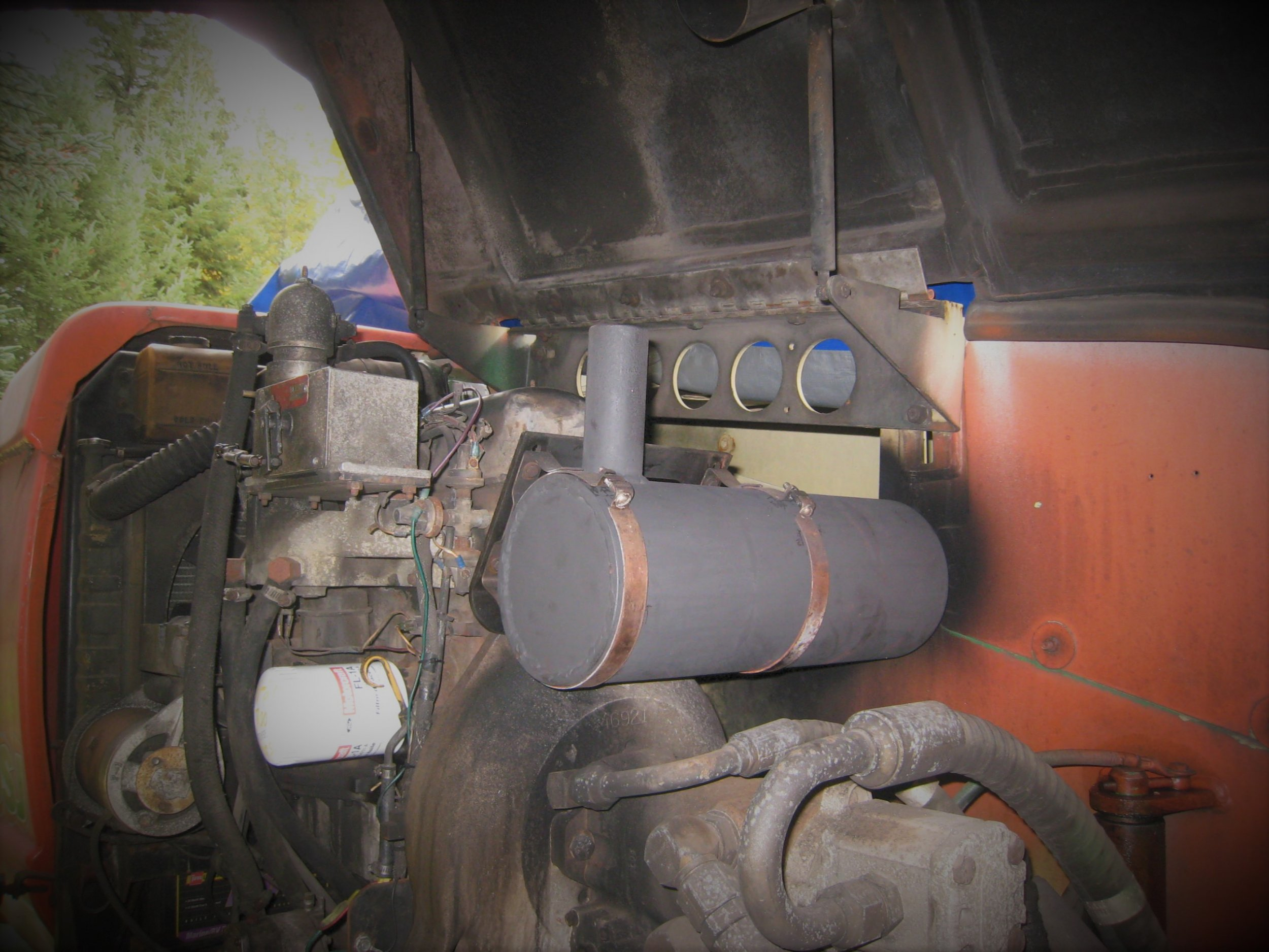

This unit has a Ford LRG423 gasoline/propane engine with plenty of operating hours and was in need of some maintenance & repairs obviously.
The engine starts easy and runs nice & clean.
The first priority was the muffler which was in terrible condition, leaking badly and beyond repair - also a big a fire hazard:
Due to the side inlet/outlet & length restriction I was unable to find generic replacement, so I made my own muffler out of same diameter steel pipe since the OEM muffler was priced at about $900 + shipping.
The new muffler is all made of 1/4" thick steel and works very well - hopefully it will never need replacing!

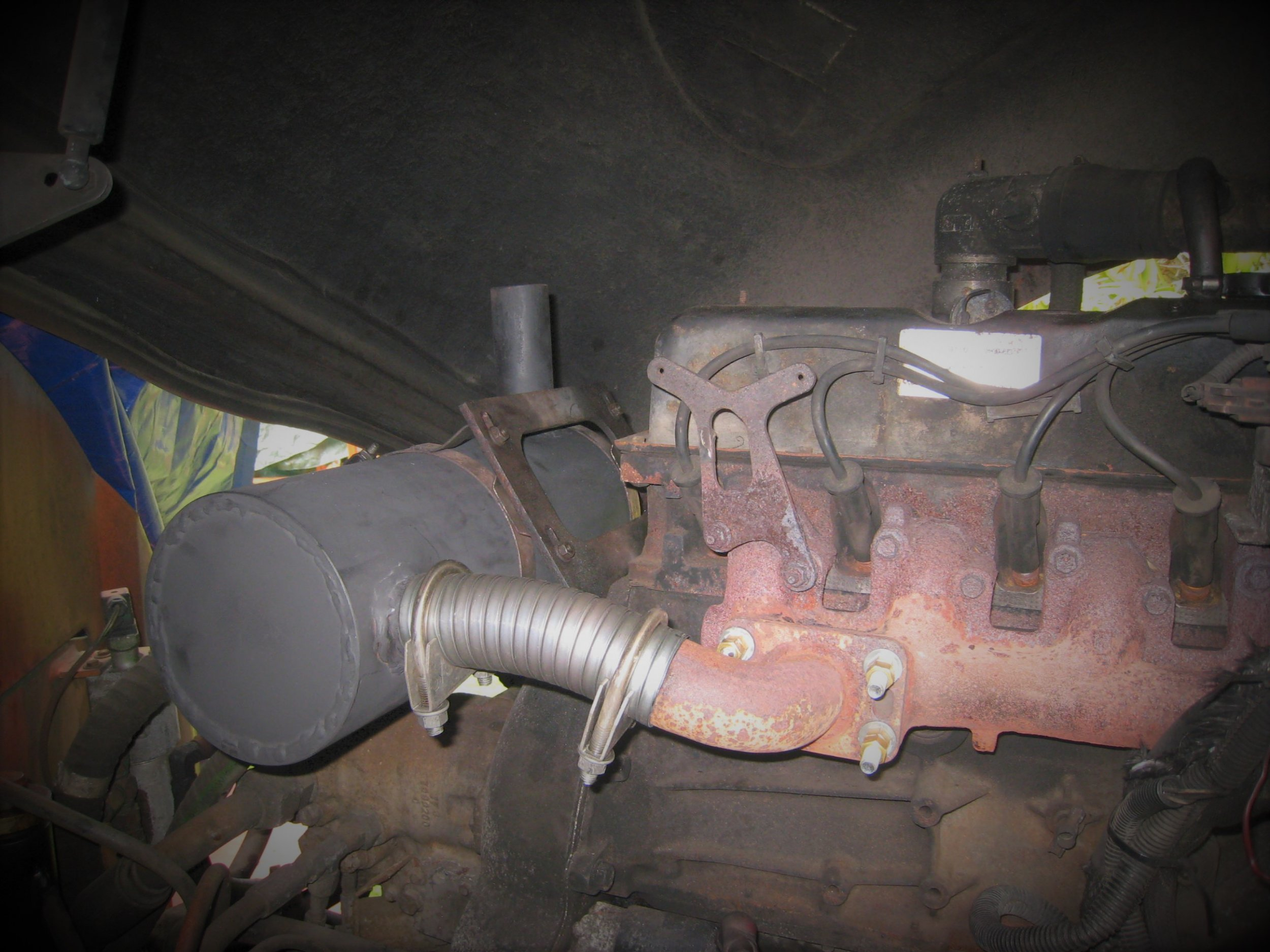

The soot above is from many cold starts with badly leaking muffler!
So far I have changed engine oil, 37 gallons of hydraulic oil, all filters, cleaned up the carburetor (which was surprisingly clean inside) and replaced one long hydraulic hose.

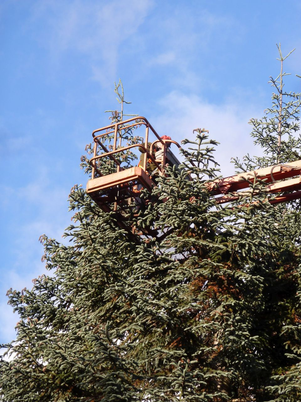

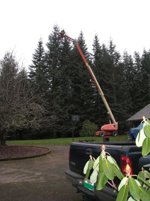

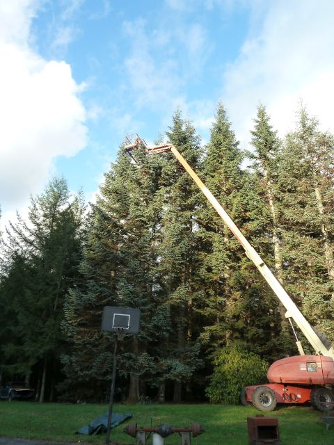

As for testing the capabilities of the lift, I have so far taken out one hazard tree, starting from top down at about 65 feet from the ground.
It's little hard to see, but I am up in the basket with a chainsaw:
It was a quite an experience to be there and I have many more trees to take care of - so far so good.

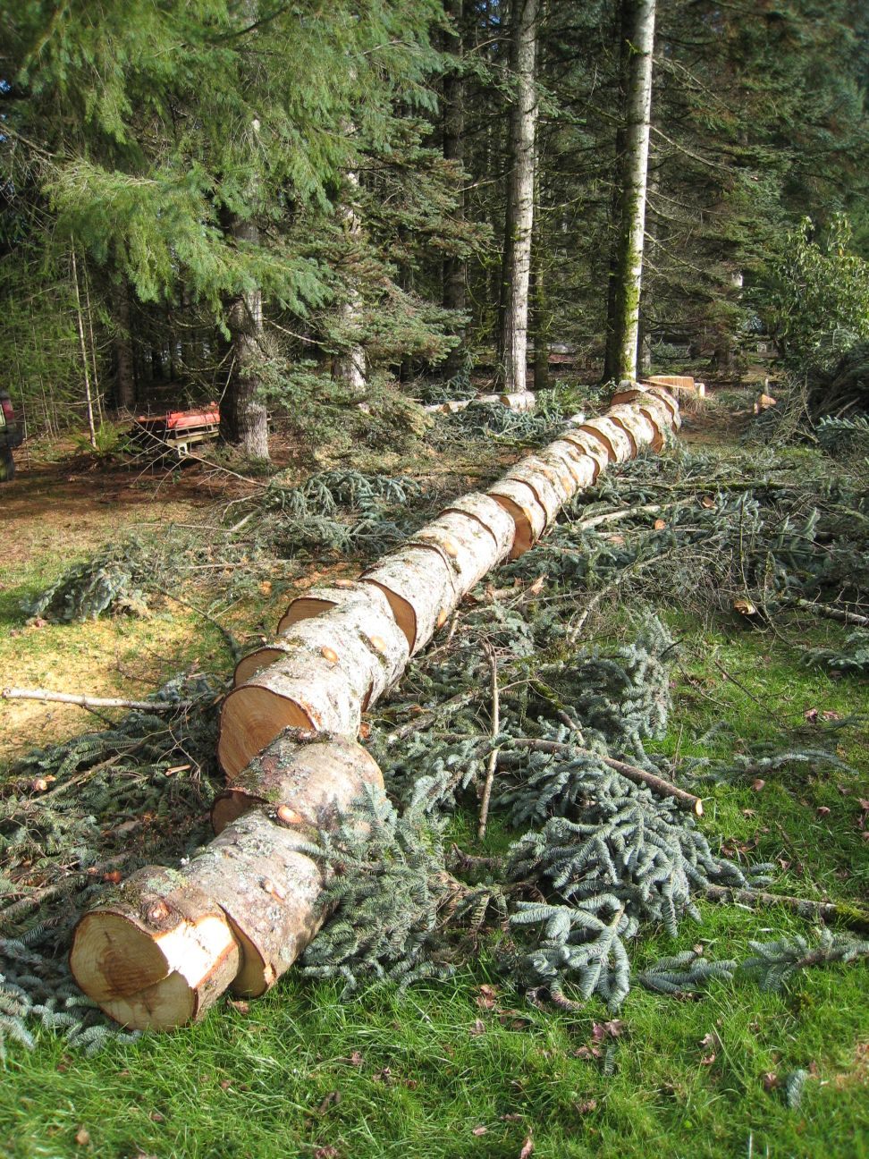

This was felled down once the top was removed piece by piece:
Should have cut down bunch of these trees 20 + years ago when they were small enough to not to hit my shop!

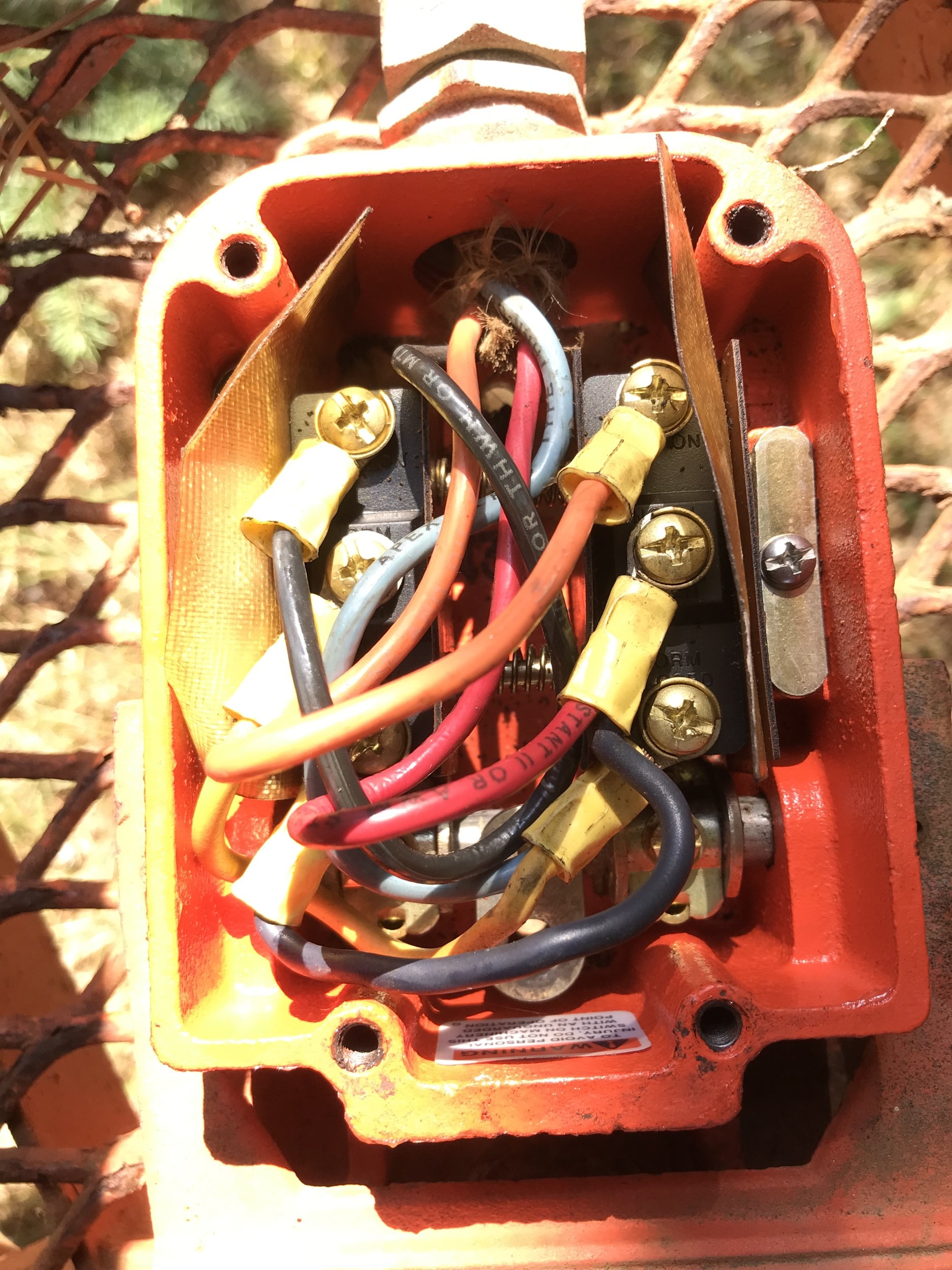

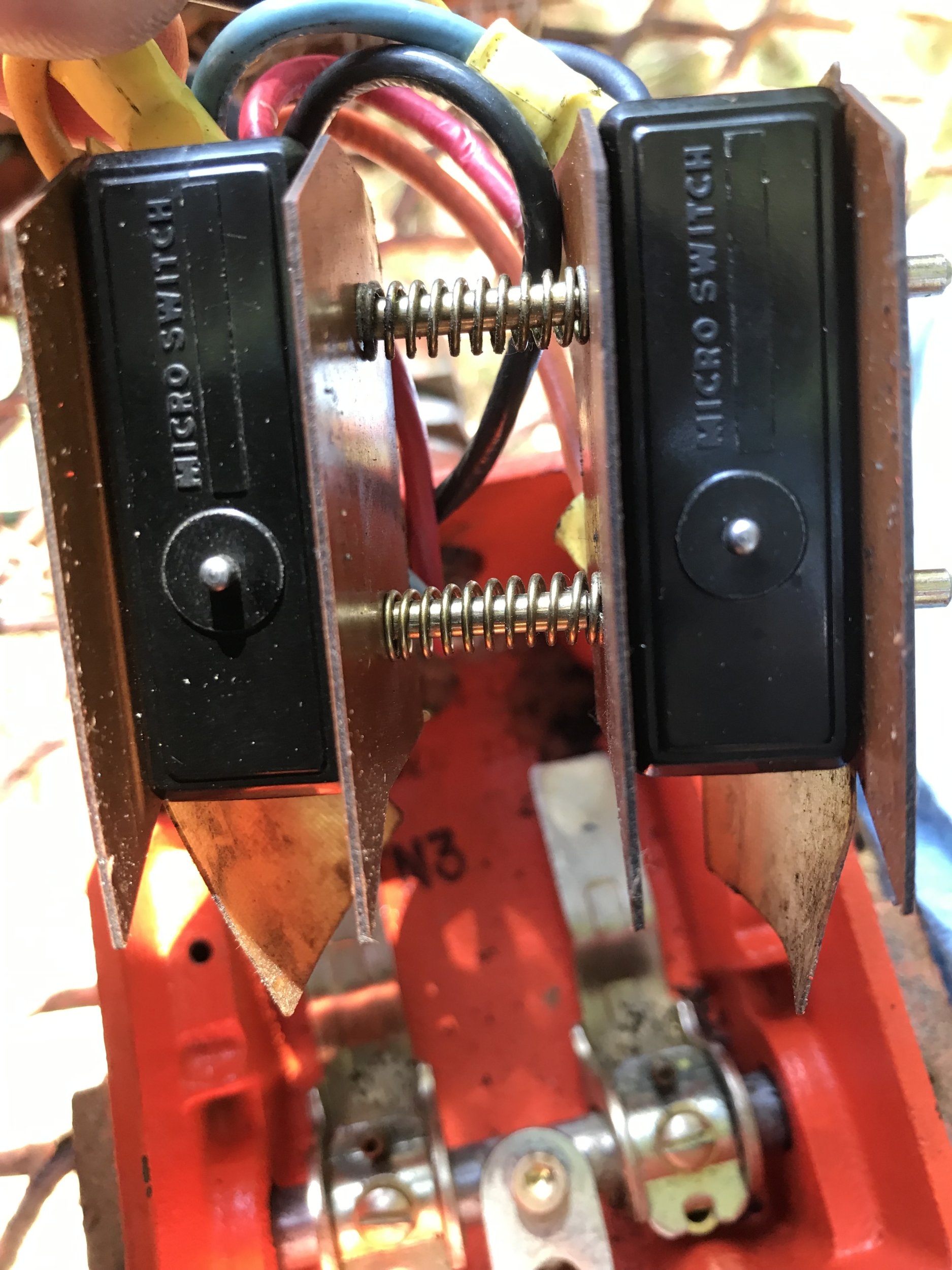

Update

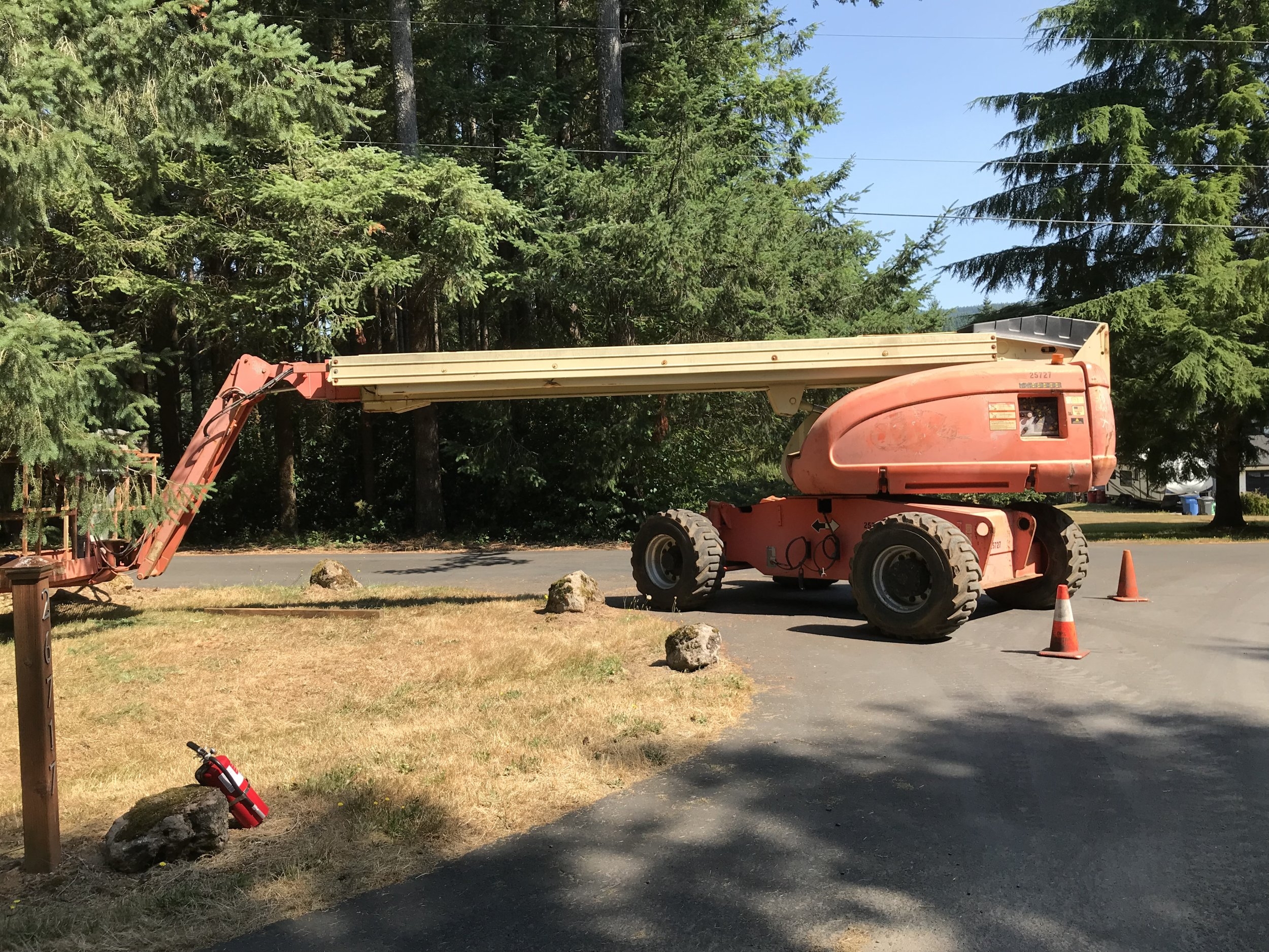

I had decided to help a neighbor with my boom lift and ran into a problem.
Have been struggling with an interesting problem which began six days ago, when the platform control panel started acting up for no apparent reason!
The ground panel controls worked normally, but things went hay-wired as soon as switching to platform panel.
I was somewhat under pressure since it was stuck on an easement and decided to call for service help.
1. The brakes seemed to be locked on and would stall the engine on overload as soon as trying to drive forward or reverse.
2. At times the engine would cut off ignition as soon as switching to platform panel control.
3. At times the engine would overload as soon as we tried to rotate the platform
4. Service rep was trying to diagnose everything but could not figure out what was wrong, he suggested replacing $1000 "drive" electronic control board.
5. Service rep also suggested cleaning out all electrical connections - now that would take days since there are lot of of connections!

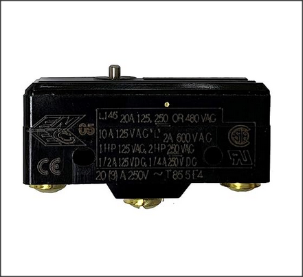

6. I had ordered two foot switch micro switches few days ago since I suspected them based on phone conversation with another service guy at local rental shop.
Stuck on shared private driveway for five or six days:
I decided to replace the micro switches this morning, right after USPS delivered them and VOILA - all controls are back to working normally!
2 x $15 Micro Switches in the foot switch:
