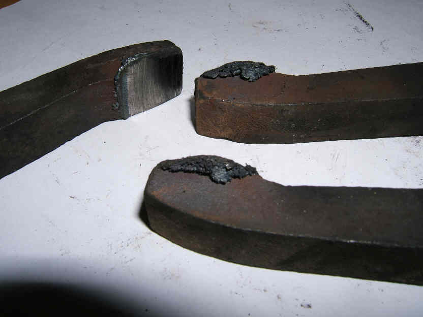

I live in France and have had my Shire 335 (35HP re-badged Jinma) for just over 12 months now. After having done 55hrs I was aksed if the farmer next door could borrow it to do some work in his barn and the Jinma was smaller and able to manouver a lot better. Anyway 3 weeks later he returned the tractor and it now had 117hrs on the dial and also a loud sound when the clutch was depressed. Took it down to the local tractor garage and they split the beast. Went down yesterday to see the damage and they said that I need the following replacement parts: 1 x Throw out bearing, 1 x PTO clutch driven plate assy, 3 x sub release levers, 2 x disk springs.
The mechanic said that he thought that the Throw Out Bearing Seat had stuck and that this had caused excessive wear and overheating of the various parts. The ends of the Sub Release Leavers were totaly worn away. As they normaly deal with MF and other major brands, he could not fugure out how the Throw Out Bearing Seat was meant to be lubricated and sated that he considered this to be a major design fault.
Has anyone any ideas how the Throw Out Bearing Seat is lubricated? Also anyone any idea as to why this type of damage would have occured. The farmer next door was mainly using the tractor to run a PTO driven generator (with tractor engin running at max speed).
Any advice appreciated as the repair bill for this looks like comming to about £1,000 and the French Farmer is likely to say that if this is a design fault he should be responsible!!!

I can't speak for the bearing lube, as my KAMA has a grease point. But the photo of the release levers suggests that that problem was in the clutch linkage adjustment, rather than a lubrication problem. The release fingers are not supposed to contact the throwout bearing when the clutch pedal is fully released. Yours were obviously making (quite excessive) full-time contact. I believe a gap between 0.1mm and 2.0 mm is specified.
This is an adjustment that should be performed by the selling dealer, hence a warranty issue. If you put it together yourself.....

When we have seen this type of failure, it has been from failure to maintain 1" of pedal free travel on the clutch. the throw out bearing is not designed to be in constant contact wiht the fingers on the clutch, the bearing will overheat, sieze and burn the tips of the fingers off, just as your photos show. this can also be done by resting your foot on the clutch pedal during operation. The fit between the bearing seat and the support is very loose, I thik it would be hard to get it to seize and if it did, it would seem you would tell by clutch pedal not returning to normal position.

That clutch/throwout design is not much different than that used in many forign automobiles. I know Toyota has used something similar throughout the 80's and the only real difference is the use of a hydraulic slave cylinder to actuate it and more fingers/levers on the pressure plate. They probably still use something similar but I havn't cracked a toyota any newer than an 88.
The Bearing is pressed onto a carrier assembly. This assembly slides on a tube(moved by a fork) through which the transmission input shaft passes. That assembly and tube is greased upon installation, or any time the unit is broken down for clutch or bearing repair/replacement. there is no grease fitting on them for routing maintenance. If greased properly at install, these things should operate fine for a long long time. The toys and nissan/datsuns I have worked on have never had any problems between required clutch disk replacements. Was there grease on the inside of the bearing carrier and the tube it slides upon?
As mentioned, the bearing carrier should fully retract so the fingers/levers on the pressure plate do not touch the bearing. In this case that is accomplished by the return spring on the clutch pedal.
My vote would be either a mis-adjustment, in which case it would have happened to you eventually. Or something inadvertantly set/fell against the pedal taking up the freeplay/gap between fingers and bearing while it was being used as a generator, Or somebody riding the clutch pedal/slipping the clutch, instead of selecting a slower gear...
What did the wear on the clutch disks look like? If they are really burnt up with only a hundred+ hours, that might lead me more in the direction of operator error.

The throw out bearing is not lubricated it only turns when you depress the clutch, what happens most of the time is the clutch was out of adjustment from day one so the throw out bearing has been turning the whole time the tractor was running.which has caused some heat damage and wore off the release fingers. Do you have a source for the clutch assembly, we have all the parts in stock to replace this, send me a PM and I will get you more information. Also do you have the manuals for the tractor?? we can help you with them also

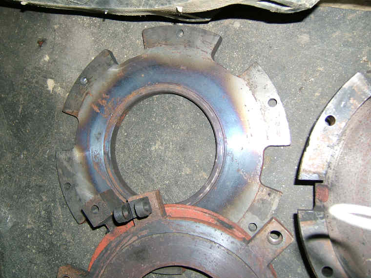

Hi there and thanks ever so much for the replies, they have been very useful. One thing that occurred to me is that the PTO Clutch pressure plate was badly heat scared (picture attached) and the PTO Clutch driven plate assy needs replacing. I am not a technical or mechanical guy at all (god how I wish I was) but wondered, if the guy linked up a heavy generator (which he did for a few days to power grinders etc) to the PTO and ran this for a number of days. Would this cause the damage to the PTO plates? (i.e could the generator have been to much for a 35HP tractor).
Could anyone advise how long it should take to rebuild the tractor once the French mechanic has the new clutch parts? He has said it should take about 2 days!!! Not sure if this sounds right.

Tommy. I may be in contact with you shortly. Want to see what the dealer in the UK says first about sending parts out here. Don’t have much faith in this happening because the tractor arrived late and the attachments came out 2 months after the promised delivery date. Also had no manuals or anything with the tractor. The French mechanic at the garage is working from a picture of the Duel Stage clutch that I got from the internet..that is all he has.

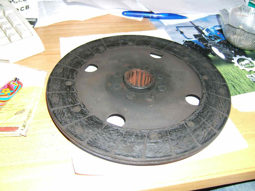

I have attached a picture of the PTO Clutch Driven Plate Assy which the mechanic said needs replacing. The other side is as pitted and marked as this picture. It looks pretty badly marked but not sure what thickness it should be in good condition.

That looks like a pic of the main disc,not the pto,but it does not matter as it will have to be rebuilt at this point, our assembly will have the new clutch,pressure plate,pto disc.We also have the throw out bearings and a complete set of manuals.Let us know if we can help,shipping cost would be high unless you wanted to wait on the slow boat from China.
