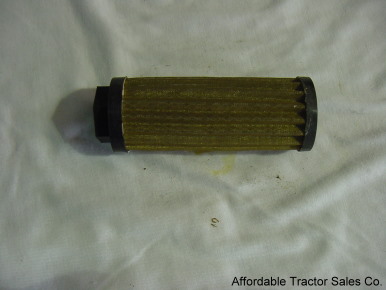

I've the older ('02) JM354 that had a kinda paper suction filter originally. I replaced it with homemade pipe threaded suction screen. I had to make a new block that the suction tube thread too on the side of the lift housing. Do the newer Jinma's have updated better suction screens? This was a fairly major conversion for me and I'm hoping the new tractors are better. bjr

And if you just want some brass screen for your pipe, I've got plenty of that left. It's 80x80 mesh, which I think equates to about 178 microns.
