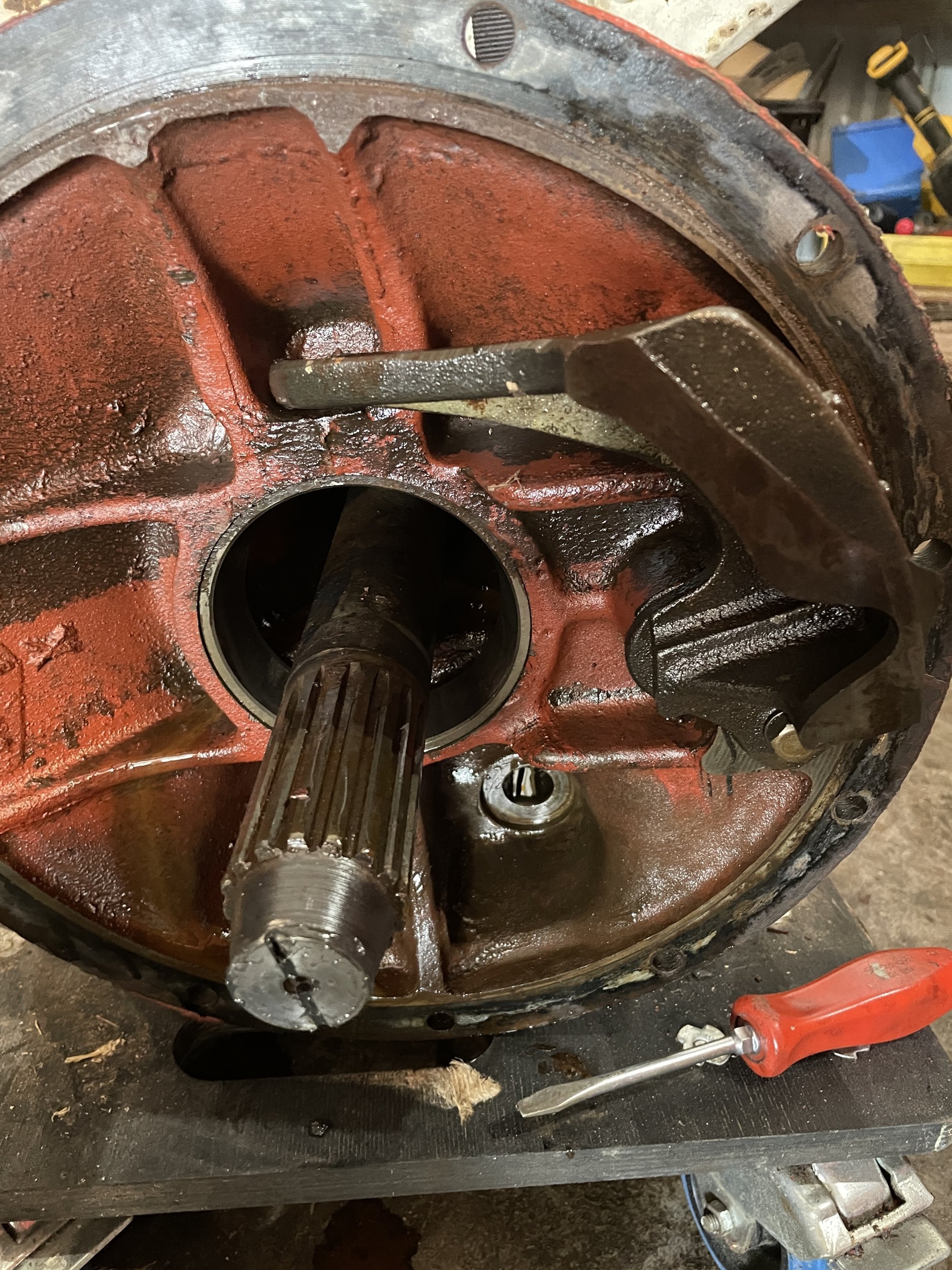

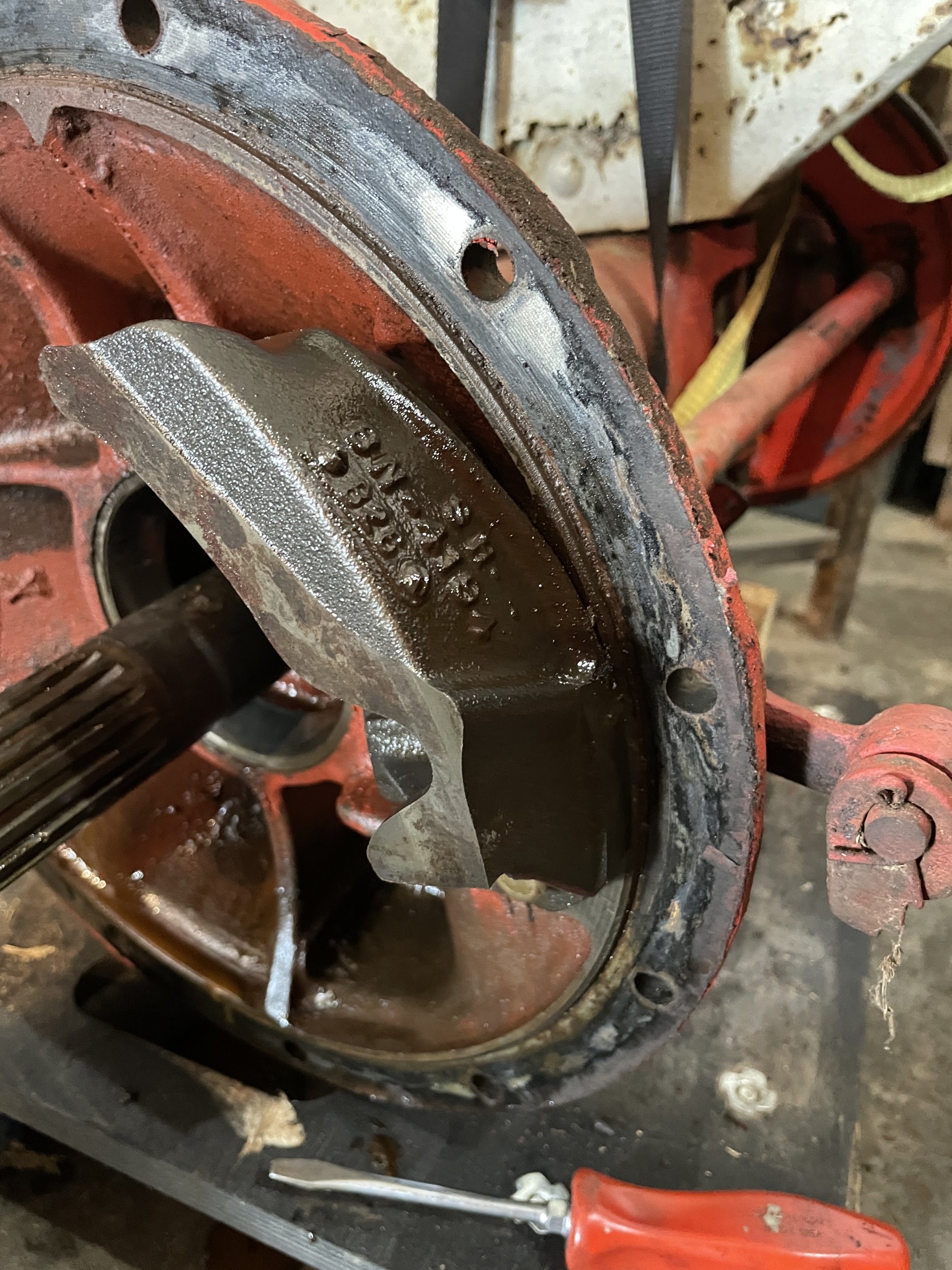

Massey Furgeson 2850M
What’s it’s job? What’s it’s purpose in life?
   / Job description act! #2
Since the rod coming into it is for brake I'd say the gizmo is part of the brake.
   / Job description act! #3
It is the thrust block for the ring gear.
   / Job description act! #5
It is meant to give additional support to the ring gear. Extra anti-deflection support, usually only found on floating axle diffs.
