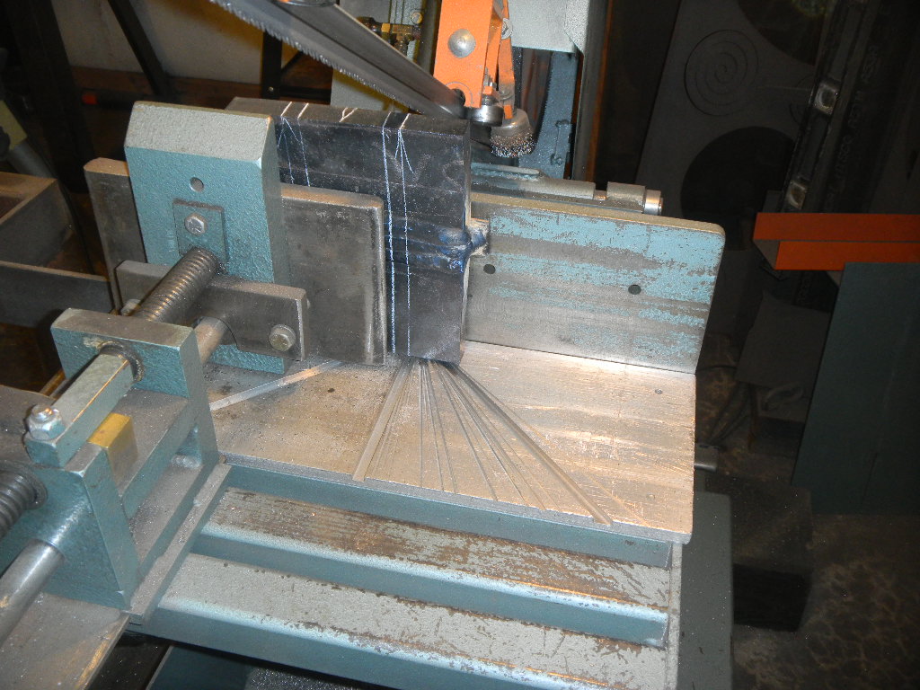

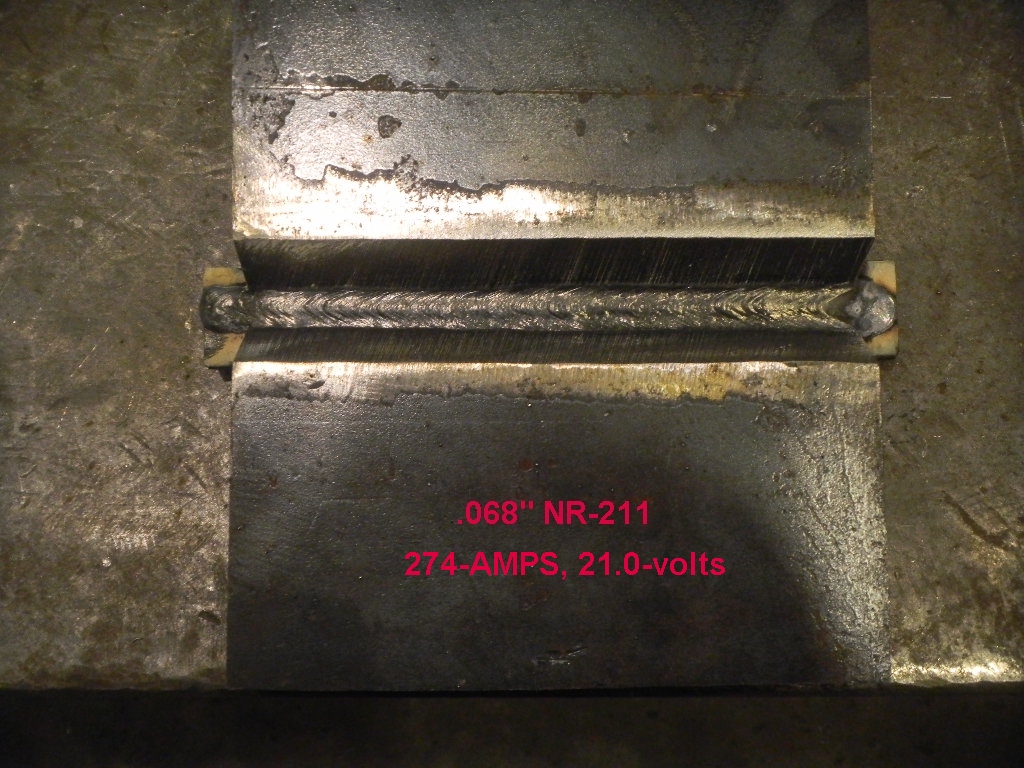

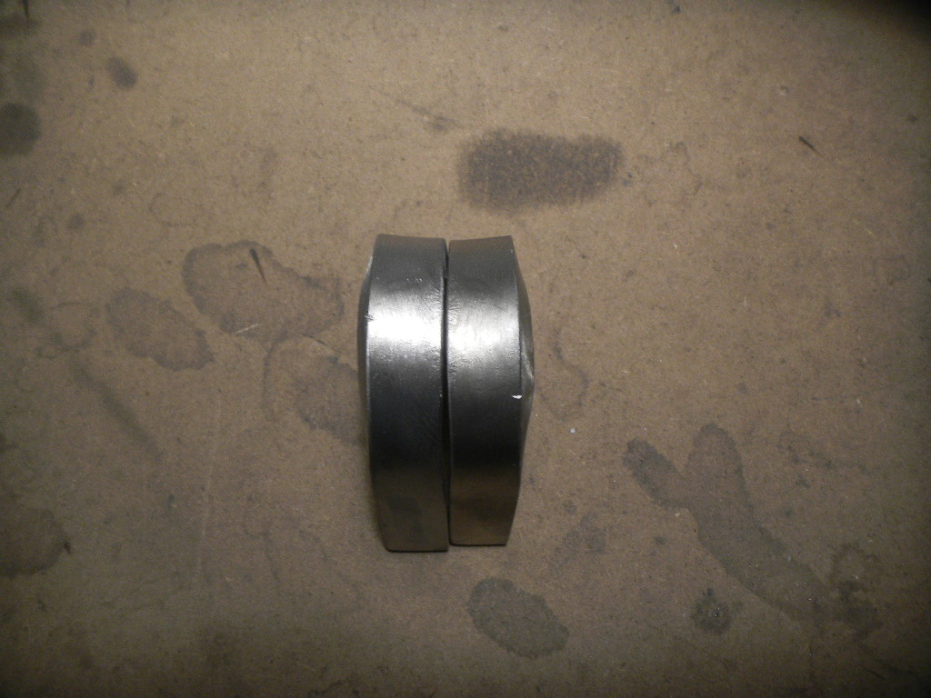

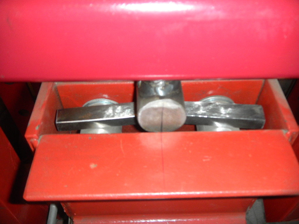

I've run a little flux core in my time. On thick plate, all it takes is power.:D
