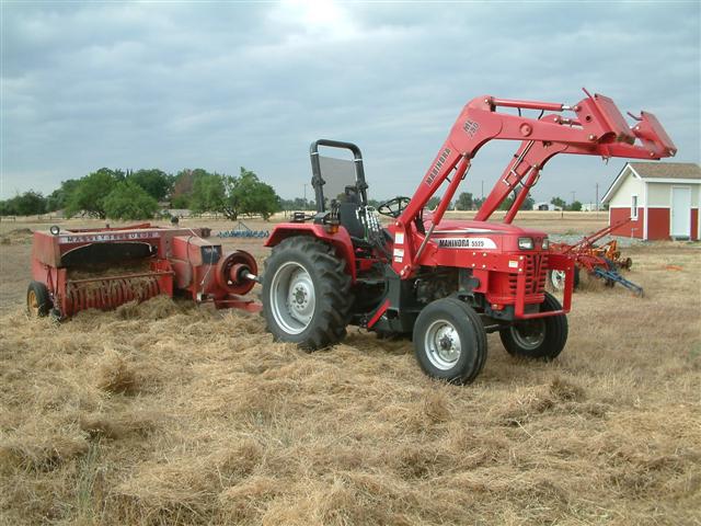

My MF124 baler (small squares, two-twine) weighs about 3000 lb.
