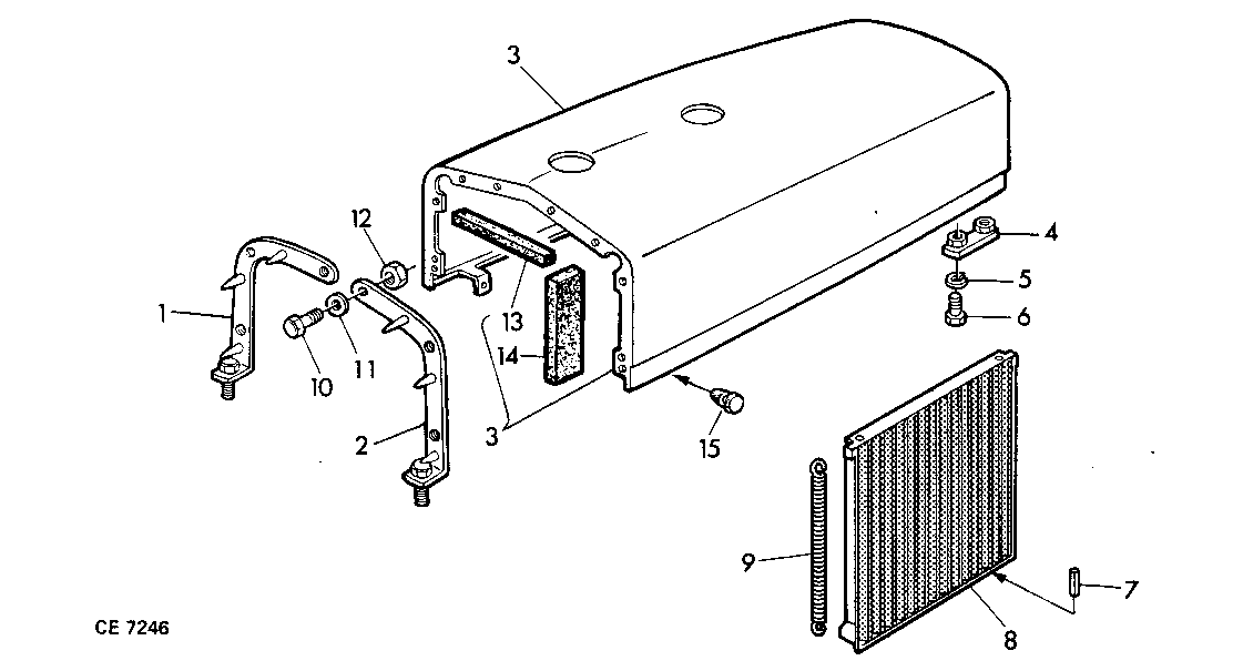

Hi There:
I have a John Deere 1030 with a leaky fuel tank. I started to try to remove the hood and found the bolts were all hidden away behind very hard to reach spots. Am I missing something here or is the hood very hard to remove? Any body have a diagram of the area so I can understand what I am looking at?
Thanks alot Jeff
   / John Deere 1030 Fuel Tank Leak #2
There should be 4 bolts/nuts holding the hood on. Look under the hood, just in front of the side cowling around the batteries. There should be 2 bolts on each side. (#6 in diagram) Remove the rear bolt on each side. Then on the front, remove the side screens. Behind the fuel tank cover/grille, there should be a nut on underside of hood screwed onto a stud that is attached to bracket 1&2 in diagram. Remove those 2 nuts and the hood should then be free to lift off.

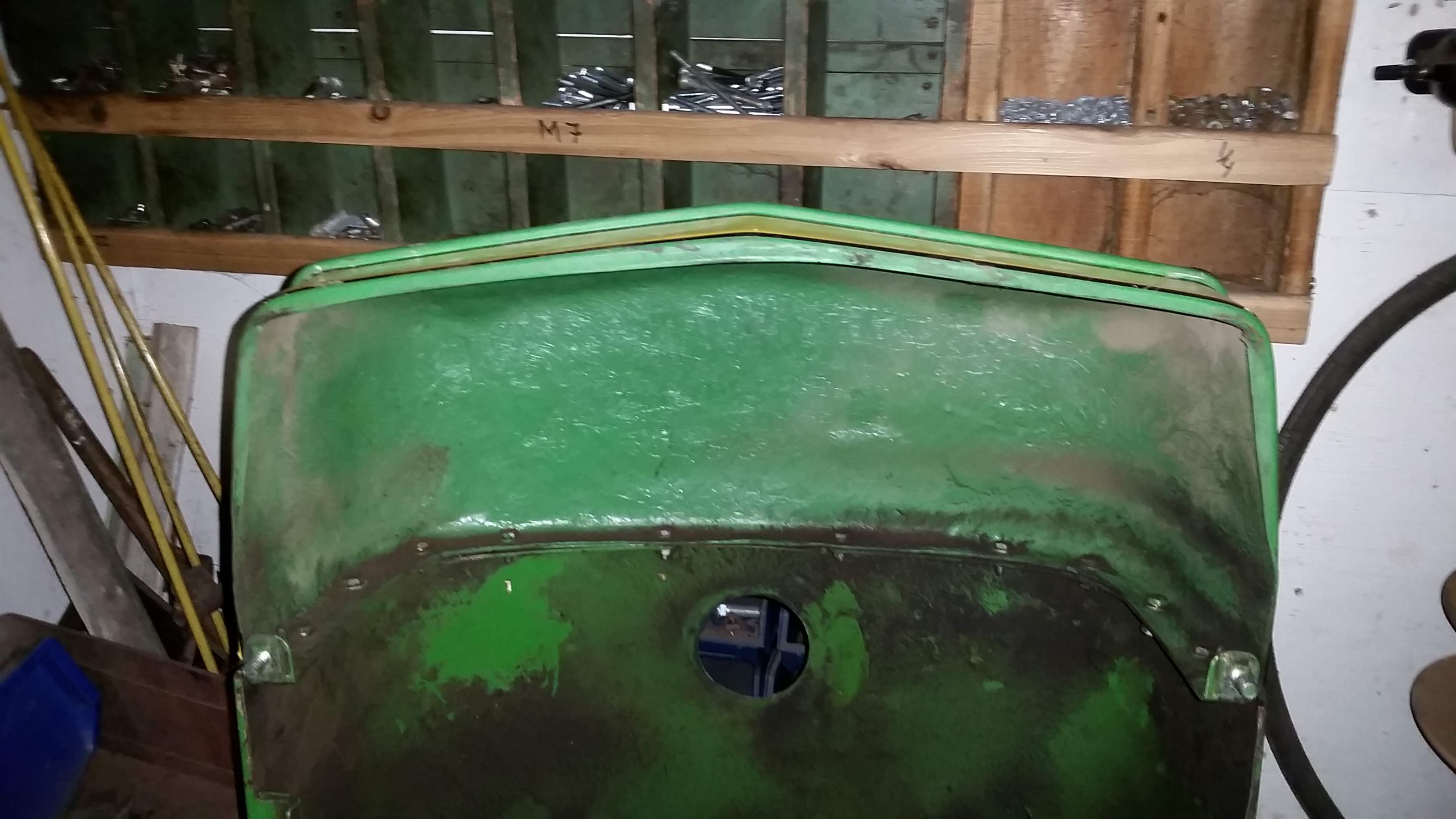

Thanks I was able to get it off. I didn't realize that the front part of the hood w20151028_094328.jpg20151028_094405.jpg
as probably an aftermarket fix. (Fiberglass) . I thought I had to remove all of the bolts across the flange of it. It was just the four bolts. Appreciate the help.

Nose piece on hood is factory not aftermarket.
