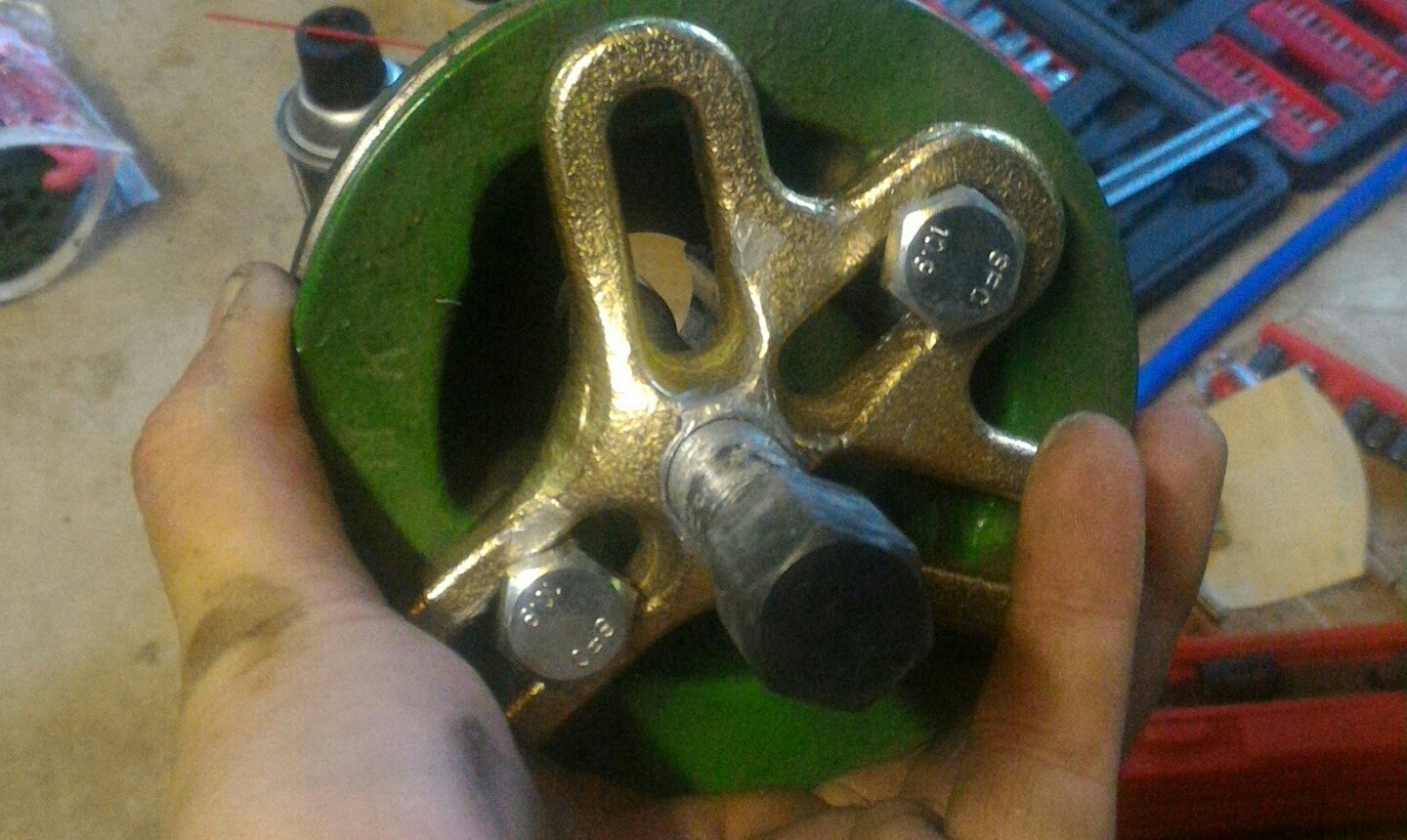

So I started on this job today and am ready to take the front timing cover off the tractor. The crank pulley came off without much trouble but I had to run out to buy some different bolts to mount my puller.
Chriswheeler, thanks for the tips...
Pics in next post.

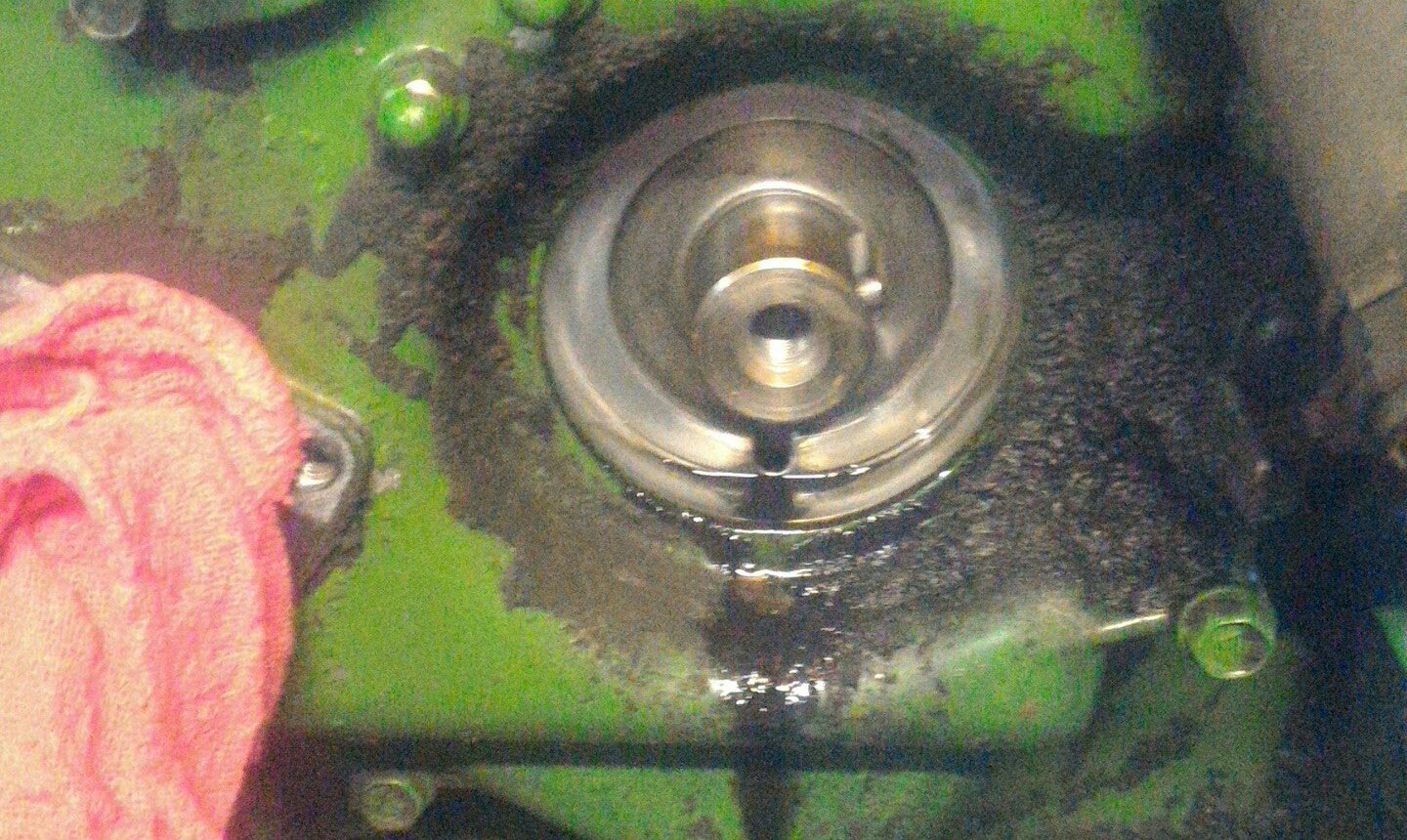

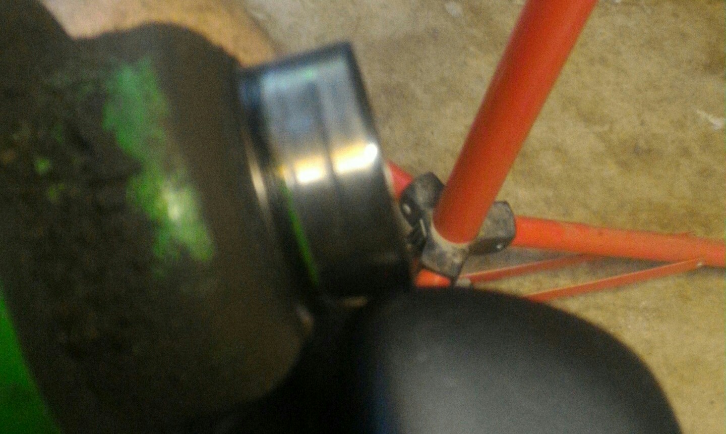

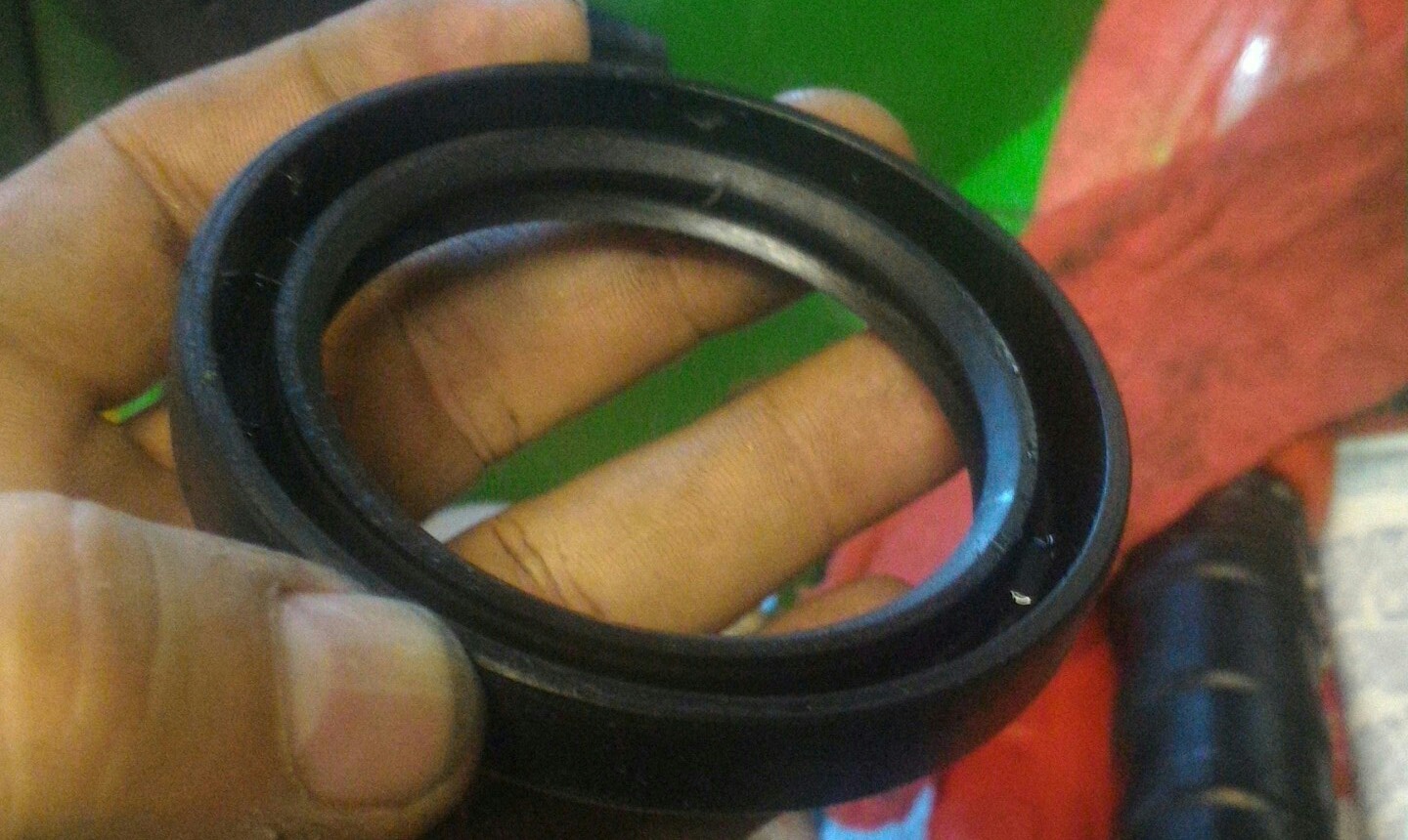

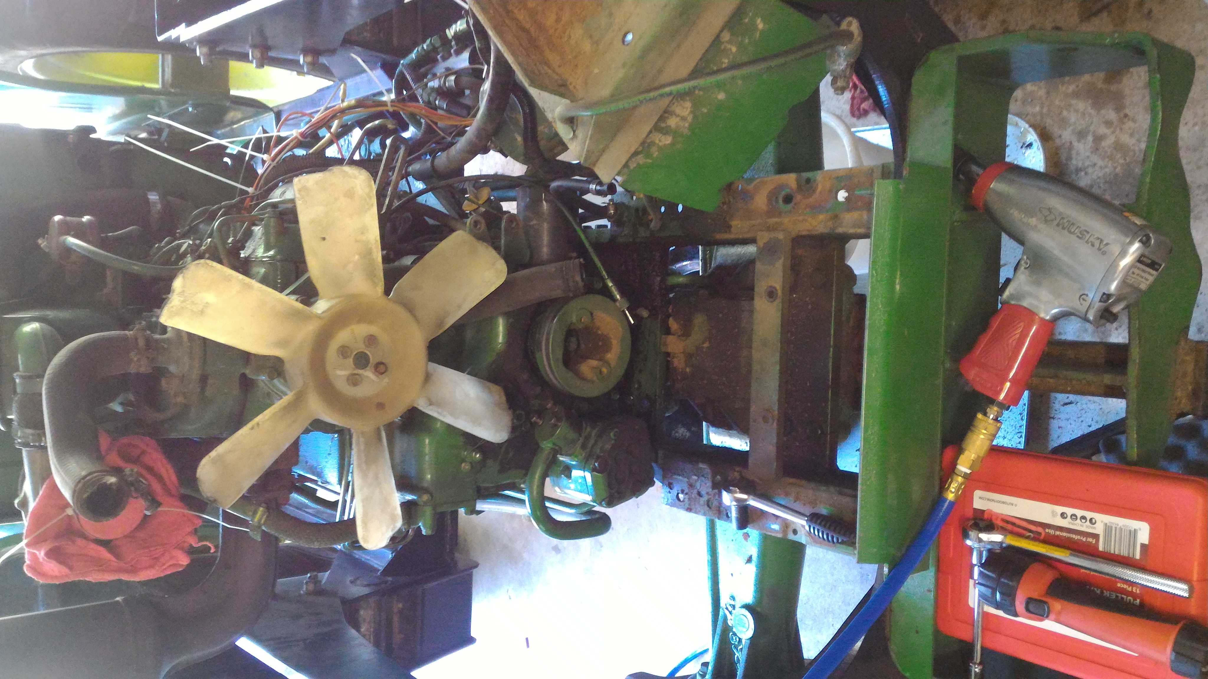

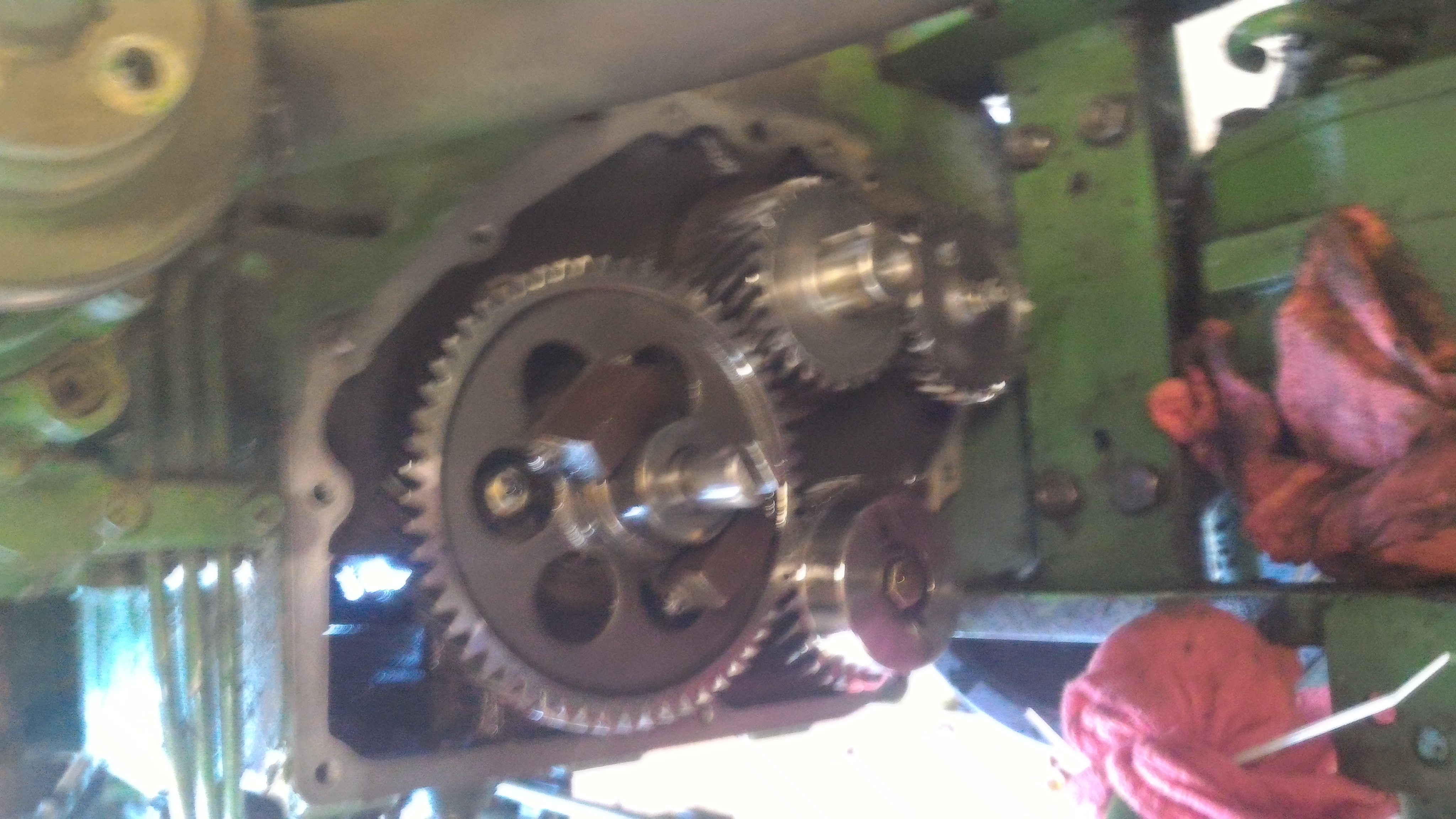

   / John Deere 1050 Front Oil Seal & Other Stuff
#9
Partially disassembled
End of crankshaft
Crank pulley with puller
Crank pulley machined surface
Old seal
Well, got her back together yesterday... the second picture is of the tractor running... no more huge oil leak from the front end. Hardest part was reconnecting the injection fuel pump linkage and spring. Cleaning the old baked on gasket material off of the various surfaces was also somewhat difficult.
Again, thanks for the tips, Chriswheeler.
