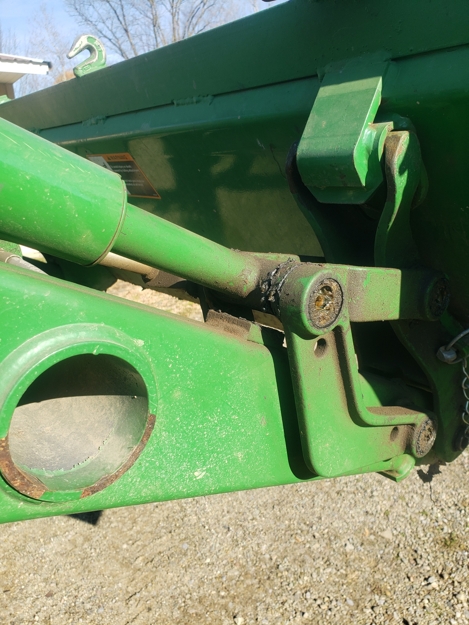

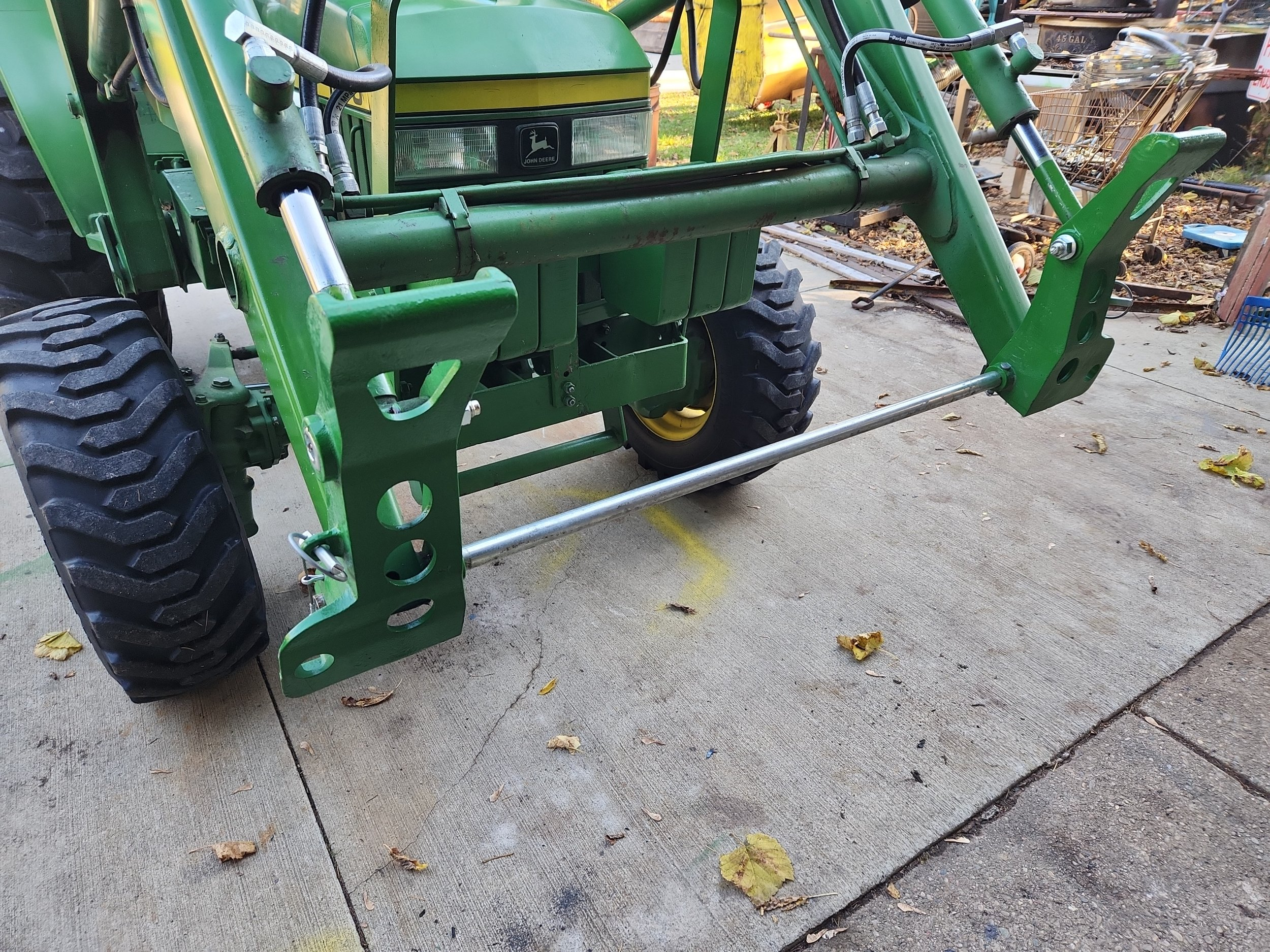

BTW: My 1070 came with an 80 loader with the pinned bucket. I found a JD kit BW15939 which gave me their Hook & Pin quick attach loader feature. Had to trim off 1/8" from the curl cylinder collars to fit the cast steel rockers. Found a 7' JD snow pusher, set of 48" forks, and a new bucket that goes on the Q.A. setup real nize. Bought Q.A. plates on Amazon and fabbed a frame for mounting an offset hydraulic post hole digger, trailer mover, and will soon have my 8' truck snow plow mounting brackets on it.

My 400x loader has a stop block at the rod end of the curl cylinder. It looks like your curl cylinder just hits the loader arm at full curl. This stop block keeps the curl cylinder from hitting the loader arm. I can send a picture later.

Your loader frame is different than mine. One of my pics shows the max curl with the bucket on. There is about a half inch of clearance then. I can hand roll the bucket where the rod end of the cylinder almost hits the stop block. With any amount of weight in the bucket and doing a full curl the rod end will easily hit the stop block as you can see from the other picture. This does not need to be a bucket but any device will cause it to hit with a full curl. The stop block is .50 X 1.62 X 2.0 for reference. Just for information.

The loader arm has built in triangular cylinder stops that engage the cast steel Q.A. brackets to limit travel. BTW: There is also a similar JD Q.A. kit which has U channel brackets instead of the cast versions. Not sure of the difference, but my dimensional measurements from a dealers display machine made me select the cast versions. This supposedly works on a 440 loader as well.
