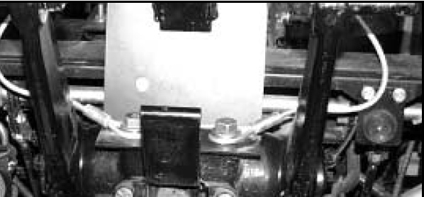

Does anyone know where the back up horn is located. Mine is driving me crazy and want to disconnect it
   / John deere 110 TLB Back Up Alarm #2
Trapper1,
Facing the rear of the machine, it's underneath the bottom of the backhoe seat platform on the right side. In the pic, on the right, about an inch and a half in diameter, with two bolts in the bracket.

I think I would install a switch. Might be times when you want it "ON"
   / John deere 110 TLB Back Up Alarm #5
Mine drove me nuts too. I put a couple pieces of duct tape over it, quiets it a lot. You can still here it, but just barely. Those same little pieces of duct tape (actually may have been gorilla tape) have been holding on there for years.
