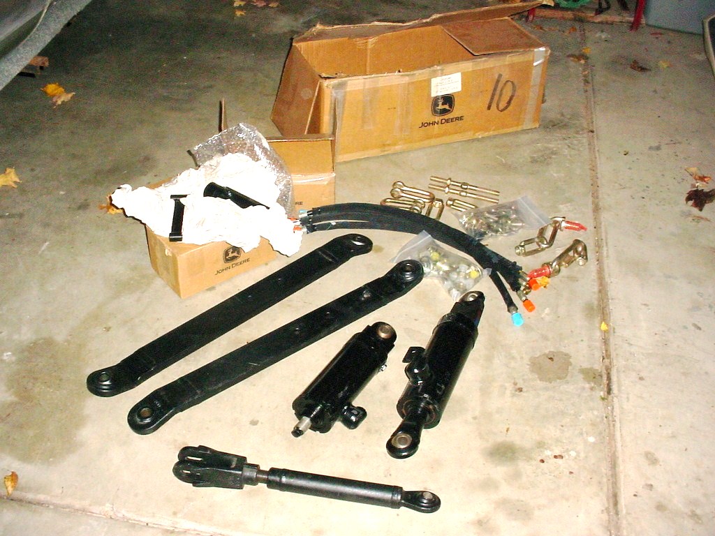

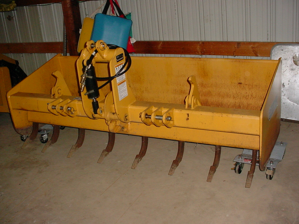

If you buy the 110, I have a nice Frontier Box Blade (BB1284) and 3pt top&tilt kit (new) for sale.
Ann Arbor is about 90 minutes from me.
