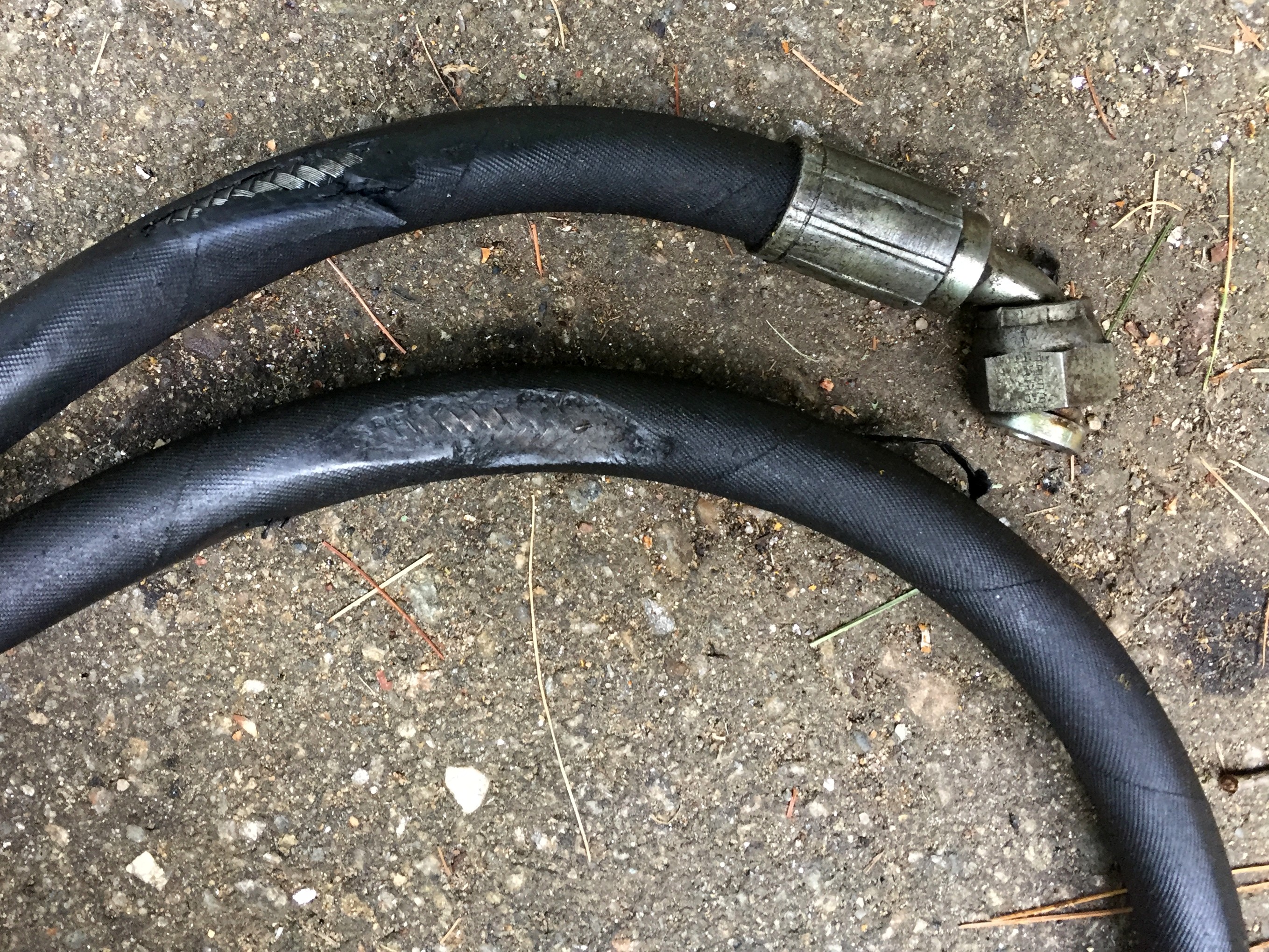

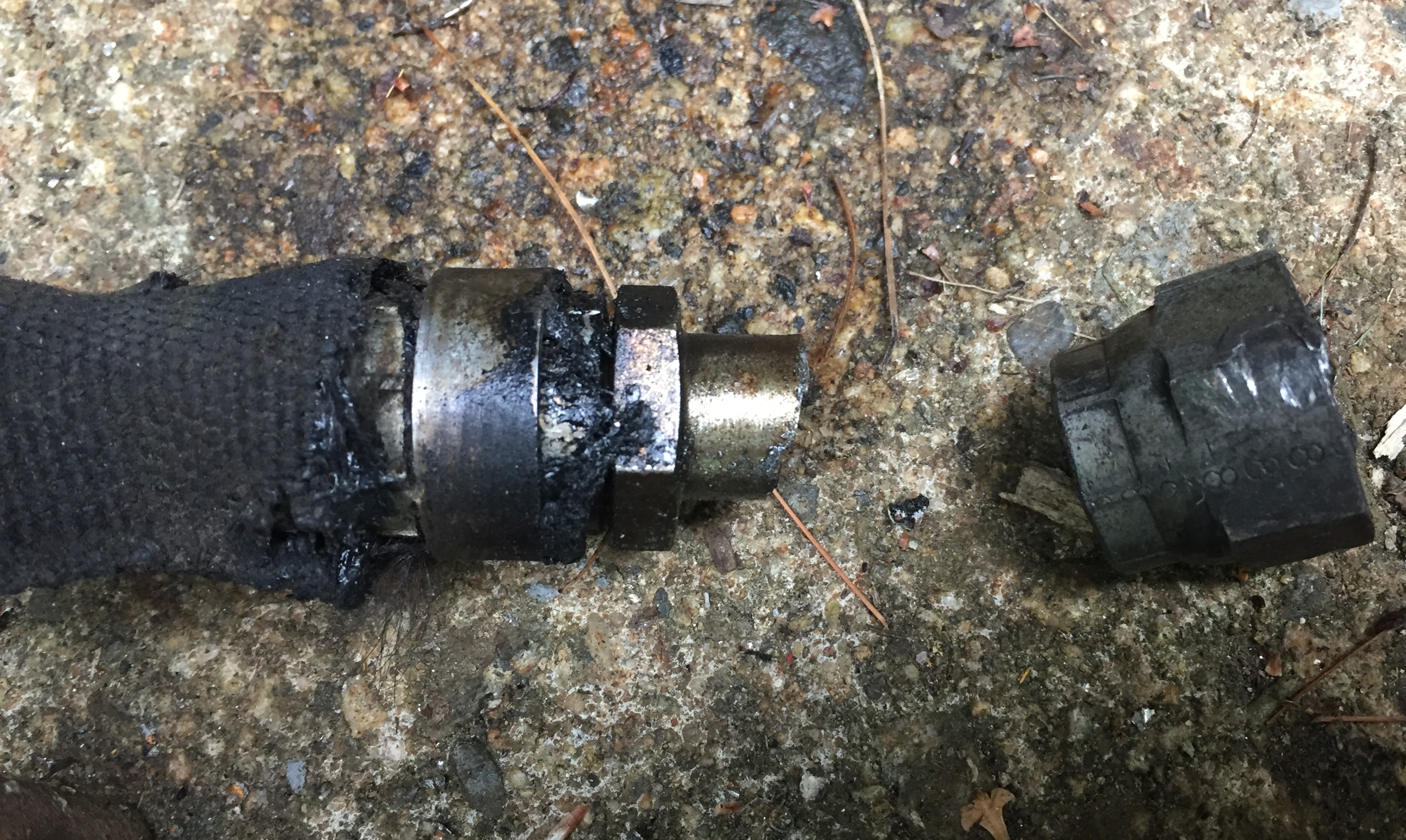

Nearly five years later, I tackled and completed the right side, what a PITA, especially with a cab. Two of the hose nuts were seized to the hard lines in front of the floor pan. The outer hose is reasonably accessible, as you go inboard, they get less accessible as each one gets further up in front of the floor pan. The furthest out, I managed to wedge a pry bar between a flat and the tower and whack with a ball peen and free, that is after all got soaked with PB Blaster. The proximity of each line to each other is marginally inadequate for wrench clearance. The third in, I formed a sheet metal shield around it and hit it with the oxygen acetylene torch until red. It still wouldn't budge. I only managed to round two corners! What a nightmare! I ended up cutting the hose end pipe and disconnecting the hard line from below. Fortunately, I could fish the hard line out from the spaghetti of hard lines and work on the bench with an impact and a six point socket. It did roll the threads somewhat but I took another used hose from the backhoe and chase the threads. What a suck job! My advice to likewise owners is to spray and coat the eight connection points by the floor pan now.
Here are some before and during images.

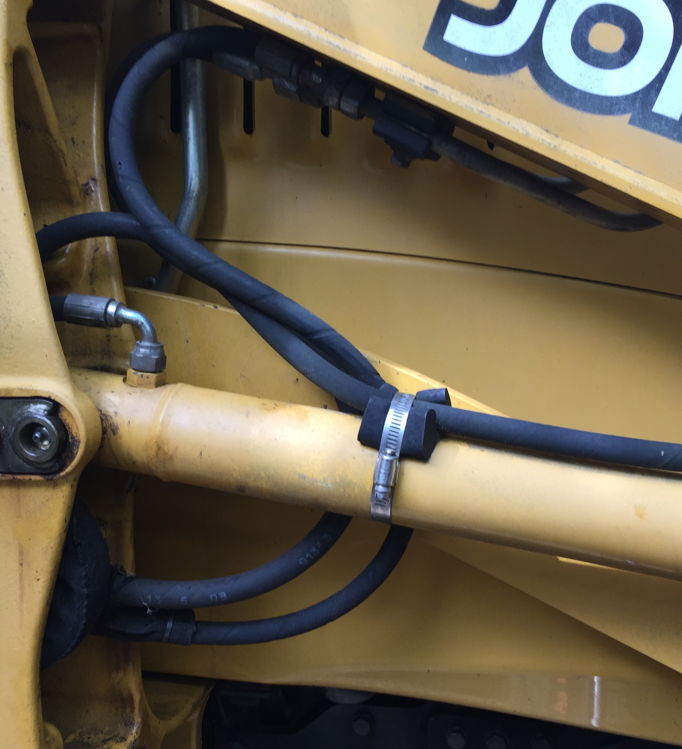

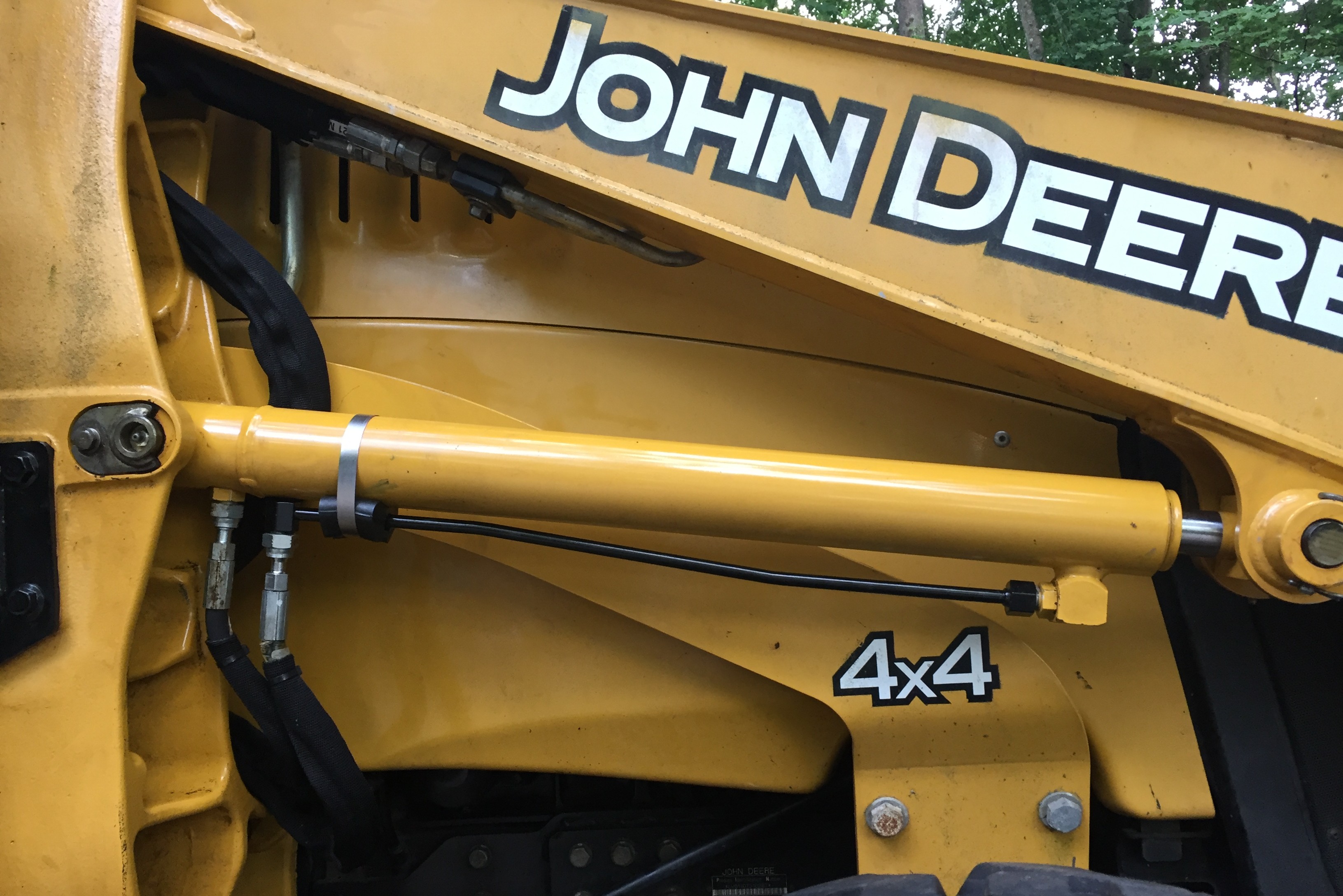

While I had this apart, I also disconnected to anti-spillover link and torqued the rear lower loader boom tower bolts. They were tight. Being a 2004 machine, my loader boom piston hoses went over the piston. With the need to service the hoses, I further opted to retrofit the later hose/pipe arrangement as found on 2006 and newer machines, not sure what 2005 had. Apparently JD had chafing issues and redesigned. I also added nylon anti-chafe sheathing to the hoses. I feel that it additionally protects the rubber on the hose from UV damage and cracking. Here is the final product. Onto the left side, will likely pull the battery box for access. I hope for a smoother easier job but certainly, I know what I am likely in for!

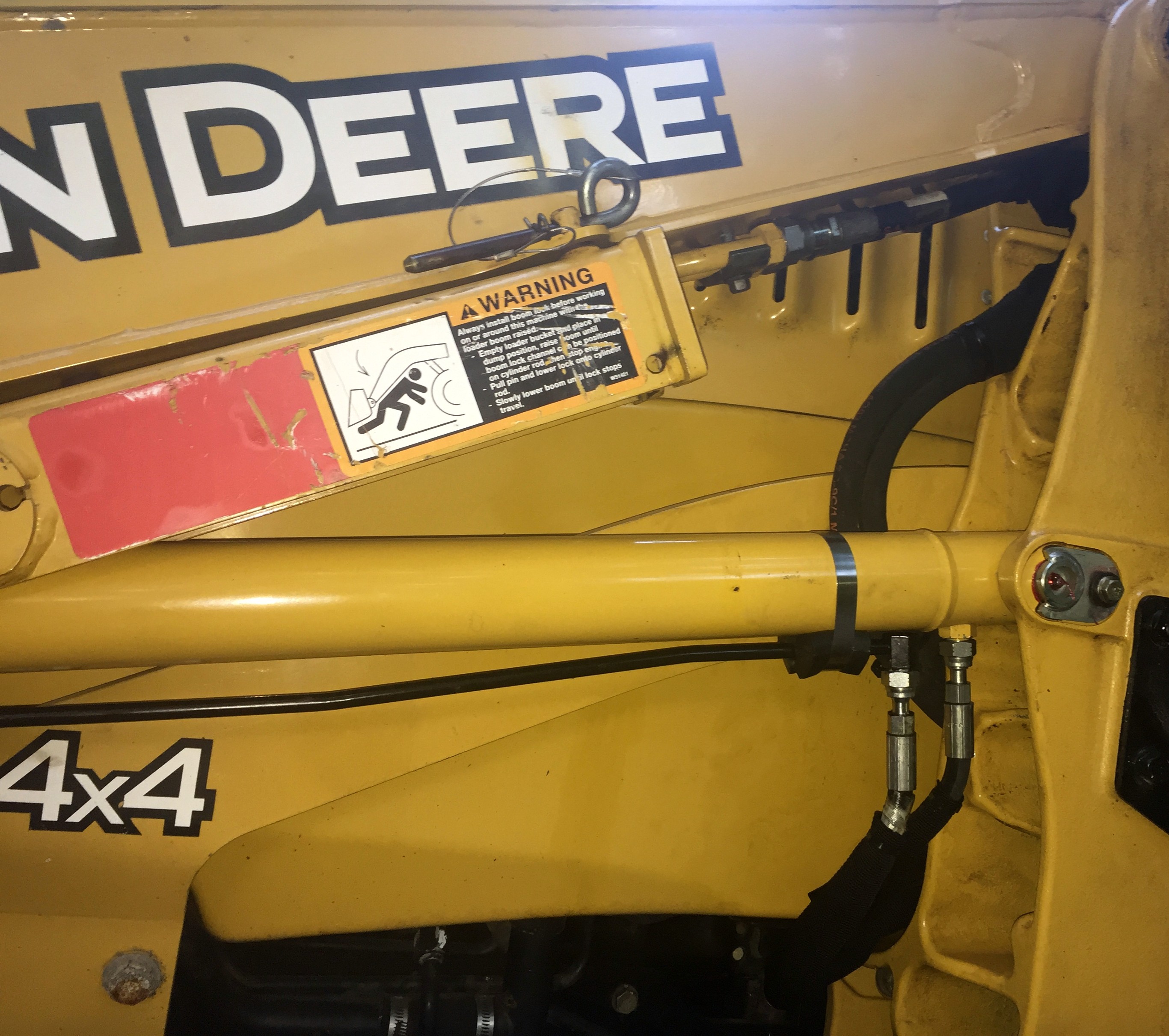

Got the LH side done. I didn't change the Auxiliary hydraulic hoses. They looked OEM, properly run, and decent with just one nick in the outer rubber. I just disconnected and fished a piece of ant-chafe over both of them. Of course, I did flip the cylinder and change all the loader boom piston hydraulics. The fittings came free without much grief and I managed to do so without pulling battery and box. Before and after images attached.
