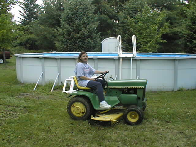

   / John Deere 111
Thanks, Paul. You're right, it wasn't a lack of power, but a lack of traction. I'm so used to my tractor with R-1 tires, that I didn't even notice that when I couldn't get up the hill, the wheels were spinning. I'm so used to the traction of R-1's, a lack of traction never even occurred to me. I just go up the less steep side, and it's fine.
However...just my luck, my wife was using it yesterday, doing alot of hills and trim, when it stalled on her. I couldn't get it started until it cooled down, and had a friend look at it. It may have been low on oil. With no dipstick, I thought the oil line should be just below the threads, which it was, but it took over a half quart of oil. We finally got it running again, but now it's acting like it's starved for gas, so I'll pick up a new fuel filter tomorrow, and clean out the sediment bowl. Hopefully that's all it is. It ran great for one time out, and then stalled as it was almost done, the second time out! Just my luck. Hopefully it's just the fuel filter, I'll bet it's never been changed.

   / John Deere 111 #8
Could be the coil going bad. My STX46 lacked power and then it started to die unexpectedly. It wouldn't restart untill it cooled off about 2 hours later (tough to mow 2 1/2 acres 15 minutes at a time!). Just a thought if a regular tune up doesn't help.
   / John Deere 111
#9
Hey Pitbull! You registered!!! Congrads!!!!/w3tcompact/icons/laugh.gif
Thanks, you're right. My friend and I were thinking with the lack of oil, it may have gotten so hot that it just couldn't turn over and stalled. If the right amount of oil, and a new fuel filter doesn't work, we were thinking we'll try the coil next. It's always good to have someone else with the same opinion!/w3tcompact/icons/cool.gif
Thanks,
Rich
