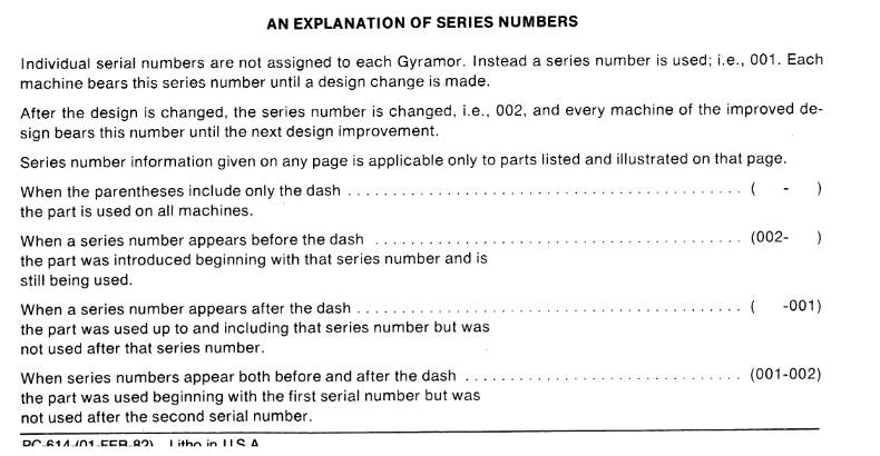

How can you tell how old is a 127 gyramor rotary cutter 3 point hitch mower, mine has 003 for a serial number.
   / John Deere 127 gyramor #2
Welcome to TBN
1958 was the beginning build date and they were built at least through 1970. 003 is series number not serial number and series 001-004 were built.
