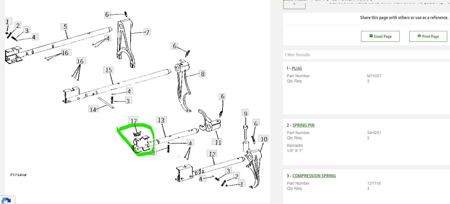

Can anyone tell me if there is a part that can bend or wear out and not put the tractor all the way into reverse and can I get to that part without splitting the tractor?
Sometimes it stays in reverse for a good while, but sometimes it pops out as soon as I let out the clutch. I think it feels like its not going all the way in.
   / John Deere 2020 Pops out of Reverse #2
My guess is this tractor has a broken shift rail detent spring(key 3). R&R of a spring would require splitting tractor & removing shift rail. It's possible tab that shift lever fits into on shift rail is cracked. One could remove shift cover & levers for a visual inspection

   / John Deere 2020 Pops out of Reverse #3
That, key 13, is the high range shift rail. It is the one I have seen broken in several tractors. I doubt it would affect reverse. Last time I split my 2030, I found it broken.
Key 12 is the shift rail for reverse.
I would guess the spring, key 3, TxJim mentioned is the more likely suspect. It could be broken or just "gummed" up.
Another possibility is the shift fork, key 10, is worn, bent, or the set screw, key 6, is loose, or sheared, and fork is moving on the shift rail (just a little, enough to not fully engage reverse)

No worries, You have probably forgot more than I know. I think detent spring you mentioned is most likely cause.

Am I understanding correctly that all of these possible fixes require splitting the tractor? A local mechanic told me I just had to remove the rockshaft cover. Would that give me any access to these problems?
