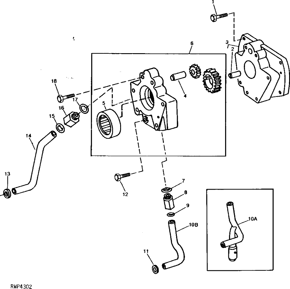

got a 2040 john deere got a new veil hydraulic pump new filter cleaned cart., new fluid still can't fluid threw the lines just spurs out what could be the problem?

What's the serial number of your tractor as early models are open-center & later models are closed-center hyd's?

255246L is serial and code is 204SA any help I would be grateful right now I'm lost. Thanks

It's possible the trans pump lost it's prime or one of it's gears broke.

it's supposedly a new pump and I prime when I installed it the first time. I had a little water in fluid at first so I changed the fluid and filter, three times thinking that maybe the water was my problem now I don't have any moisture still no pressure.

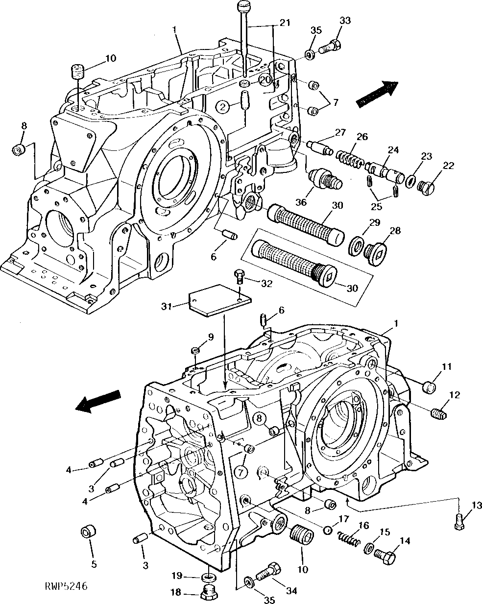

   / john deere 2040 #7
Have you checked sump screen(parts key 30)?

Remove coverplate over shiftcover ...on the righthandside you will see 2 testplugs ......to test your oilpressure ......front 1 should be near/just over 10 bar .....rear 1 also about there .....rear 1 delivers oil to front pistonpump
