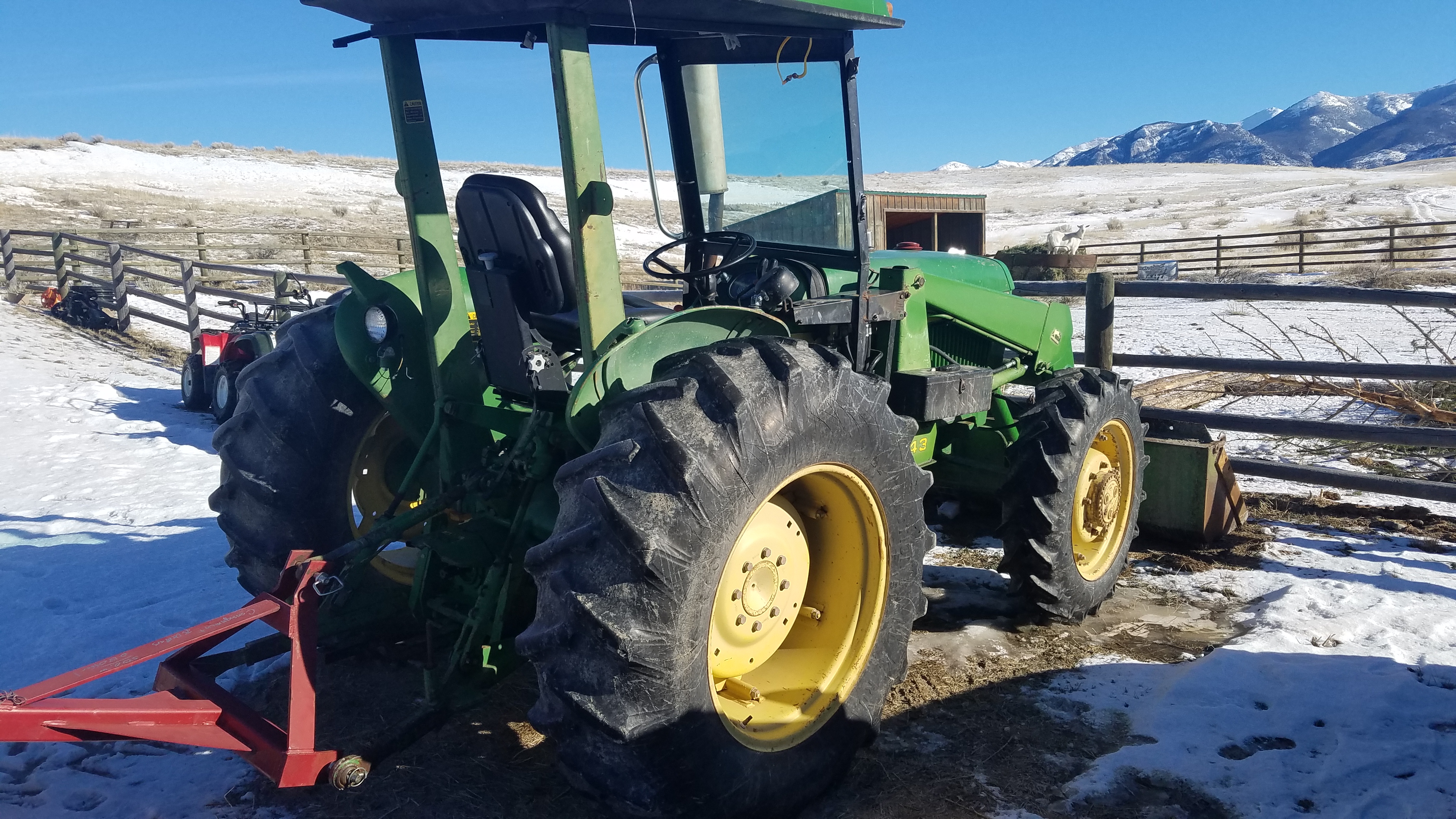

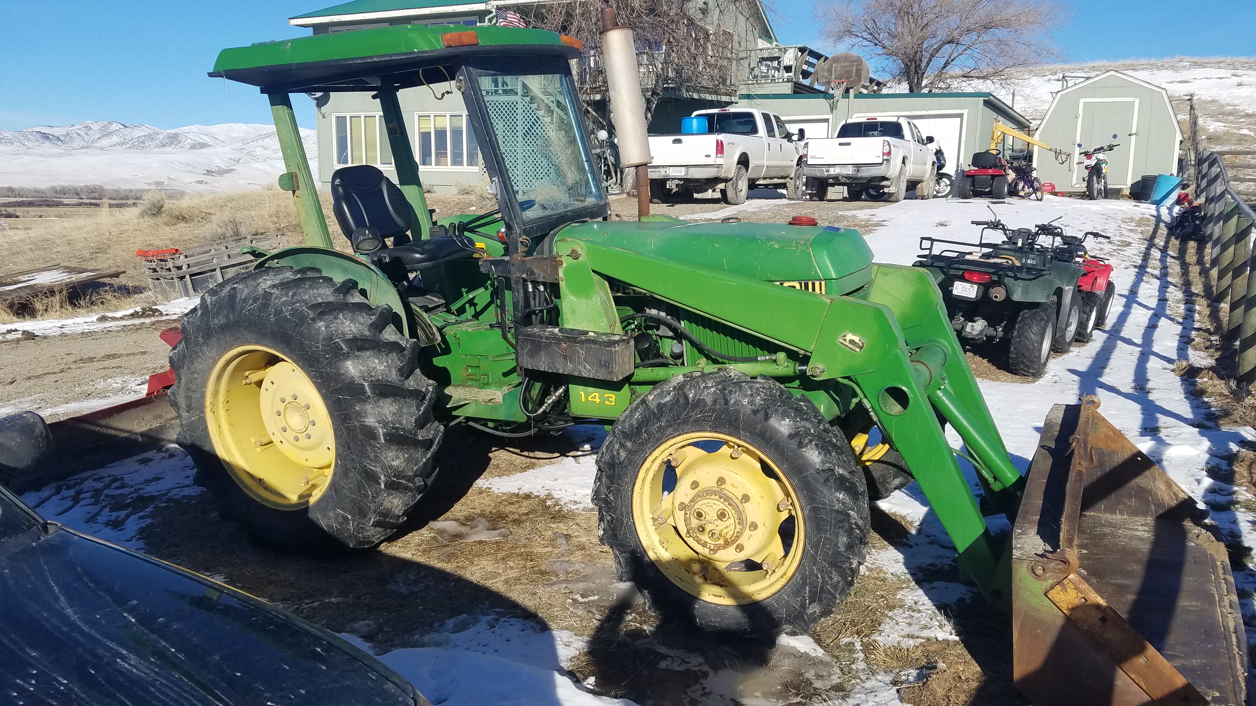

Ok, so I got the tractor. It has been pretty handy so far! I was able to lift my 1600 lb. bale with the use of a ratchet strap and set it into my half-full round bale feeder. I picked up a back blade for it and that has been handy clearing the driveway...a FEL does not work as good as i would have expected for scraping packed snow and ice!
The next tool im looking at is a post pounder. Ill meet up with a guy this week to look at an older danhauser PTO driven pounder. It should work for what i need it for. Im also looking for a box blade. Ive got a large area id like to level. I found a large quonset hut that was taken apart and put up for sale and i think it would fit well in this area.
Heres some pics of the tractor...sorry, they are a bit overdue. It has a 143 loader on it and the basic 2-stick 8F, 4R transmission.
They got the one fitting that was puking fluid replaced before delivering it to my place. There are a couple of other seepages, but nothing major. All hydraulics work fine, but one thing that i didnt notice when test driving it was that there seems to be some noise that sounds like a hydraulic pump. It kinda sounds like an 80's ford truck power steering pump that is growling a bit. Nothing to compare this to, so i dont know if it a normal sound or not. It seems to be coming from the area under the shift sticks.
Also, didnt notice this before, but it is almost as if there is a tooth missing somewhere in the steering linkage. When going straight at higher speeds the wheels seem to have some freeplay side to side (think shopping cart wheels here). When turning, they lock in tight and hold solid. It is almost like a tooth in a steering gear is missing right where it would hold the wheels straight. Its barely noticable though as i have taken it on a 16 mile round trip to load some heavy steel into the back of my truck without issue.

Congratulations, it looks like a nice machine. It's rare to see a tractor with a windshield, but it sure makes sense. Make sure you keep the hydraulic fluid reservoir filled up with trans-hydraulic fluid - low fluid is probably the number one cause of hydraulic pump issues. The other thing to avoid is using 4wd when you don't have to. Use 2wd as your normal mode, and reserve 4wd for low speed problems and just when you need it.
As for the steering looseness, it is probably wear in the steering components that allows those aggressive front tires to wobble. That's common enough and is probably the erratic steering you are feeling through the steering wheel. The good news is that all the normal wear parts on the steering linkage are expected to wear and therefore easy to replace and don't tend to break - they just get more and more worn until you can't stand it and replace them.
Worn steering rod ends and bushings can be replaced one by one when you have the time. Typical parts are the rod ends, ball joints, and even king pin bushings. Expect to spend a few hundred dollars for each group. Of course it might be that those parts aren't worn at all and you are just feeling those aggressive front tires along with some power steering kickback. But I'd bet on worn parts as this is normal tractor wear for a machine with that many hours. Expect to do it about once every two or three decades. My advice would be to use it this winter and count on doing that job in warm weather. I gotta say that sixteen mile road trips on a tractor are a bit excessive... I bet that was no fun!
Someday when a mechanically inclined friend is over, you might draft him to help you use the loader to lift the front wheels clear of the ground, block up the axle so it doesn't fall and so both tires are just clear of the ground, and then grab one of the front tires at 3 and 9 oclock and shake it. The slop in the worn components should be obvious. Two people can identify the worst worn parts pretty quickly.
