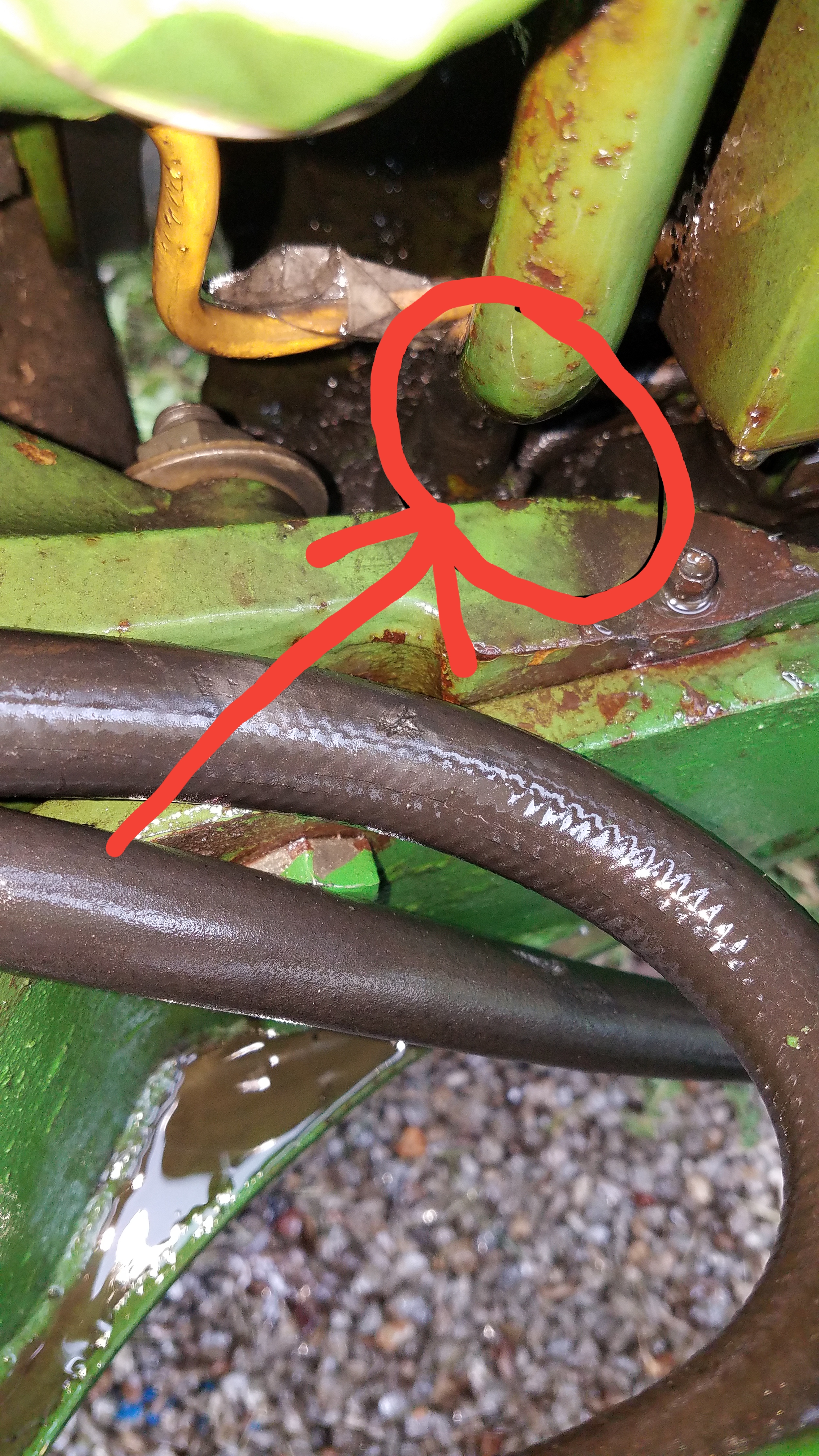

Hi,
I recently purchased a John Deere 2240 with the front end loader attachment. Yesterday the hydraulic fluid (gray with m aybe water in it?) started blowing out the right side of the motor just past the oil filler tube near the bottom of the engine. Any ideas? :thumbdown:

Check flexhoses or steeltube worn throu .
   / John Deere 2240 leaking hydraulic oil geyser front right side with front end loader #3
Even leakoff hose from teservoir to shiftcocer

Thank You for responding. I am attaching a picture in hopes this will shed some light. Tractor.jpg

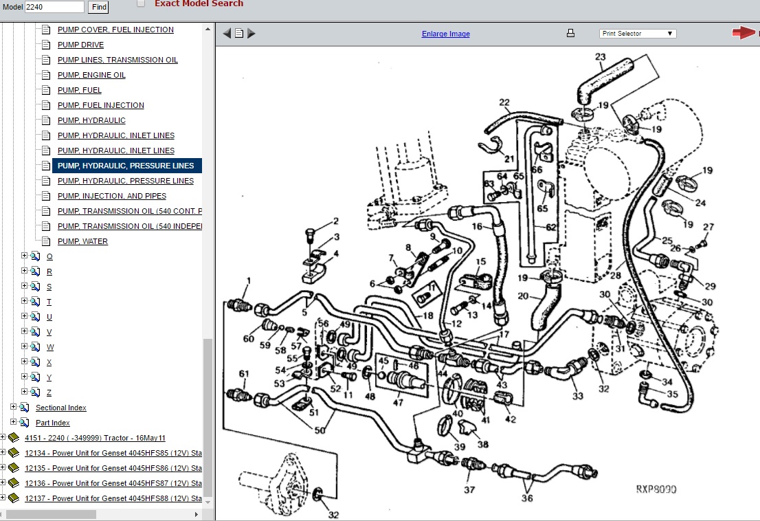

Here is a pic from jdparts showing parts associated with the hyd. pump.. on front of engine. Don't know if it helps you directly.
You can go to this link and put in the model no. and browse to track down the part suspected of leaking and get the part #.

Update: It turned out that there is a 3/4 inch hose at both ends of the metal tube on the right side of the motor just behind the radiator. I replaced both hoses and all 4 clamps, added hyrdraulic fluid and all is well.
Thank all of you for your reponses they were very helpful.:thumbsup:
