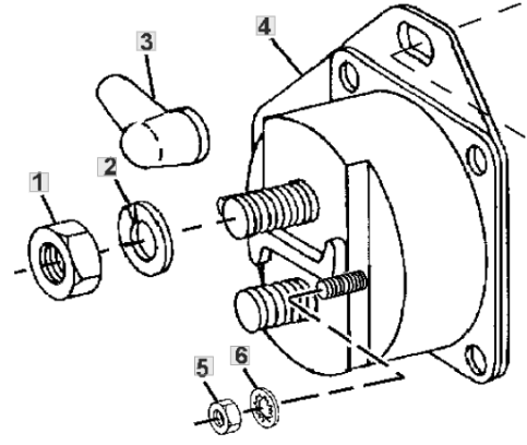

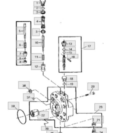

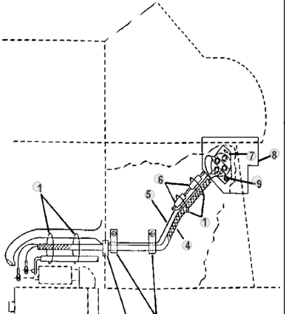

JD offered a relay kit to help stop warm engine starting problems. A simple relay(2nd photo) can be added cheaper than JD kit. Another possibility is hyd pump is attempting to build pressure during engine starting. Moving steering wheel rapidly from side to side while attempting to start engine helps relieve hyd pressure. Another option is utilizing a hyd pump de-stroking screw(item 17) during starting procedure.
Upon reading your response, I took a closer look at my tractor and I think I already have the starter relay. See picture. Yes, whoever owned the tractor before me had it repainted and now everything (except for that new regulator) is JD green. Makes it fun trying to find wire color to diagnose electrical problems...
How would I test the relay to see if it is working properly? Where would I be able to find a replacement relay if needed?
Thank you very much for your time and insights!
   / John Deere 2510 Diesel Restart Problems #7
You're welcome,
Electrical object in your photo sprayed with green paint is a circuit breaker not a relay
