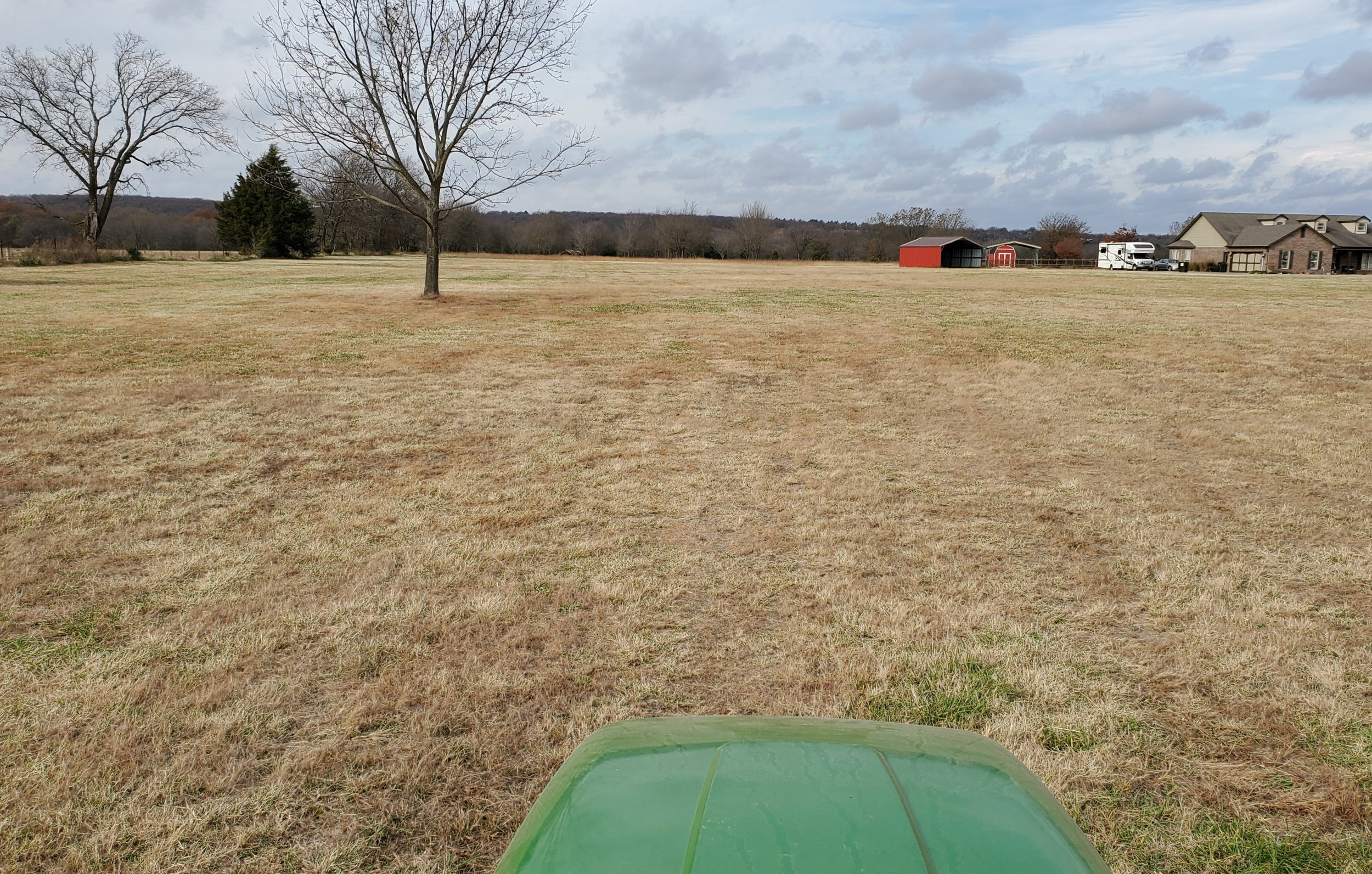

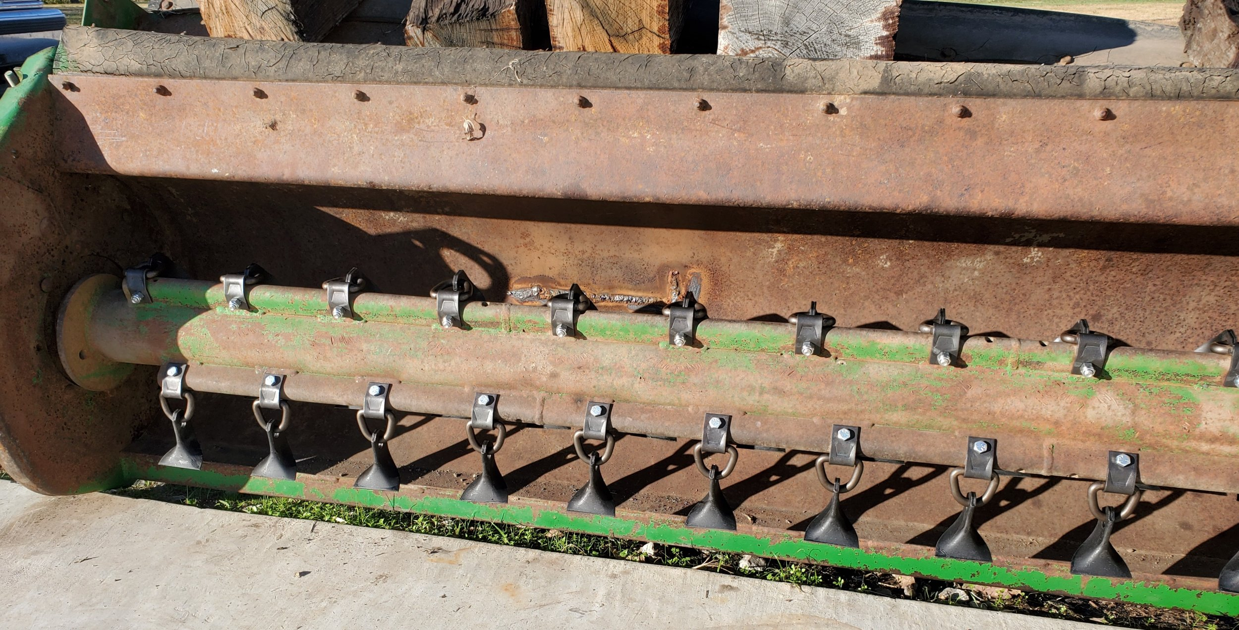

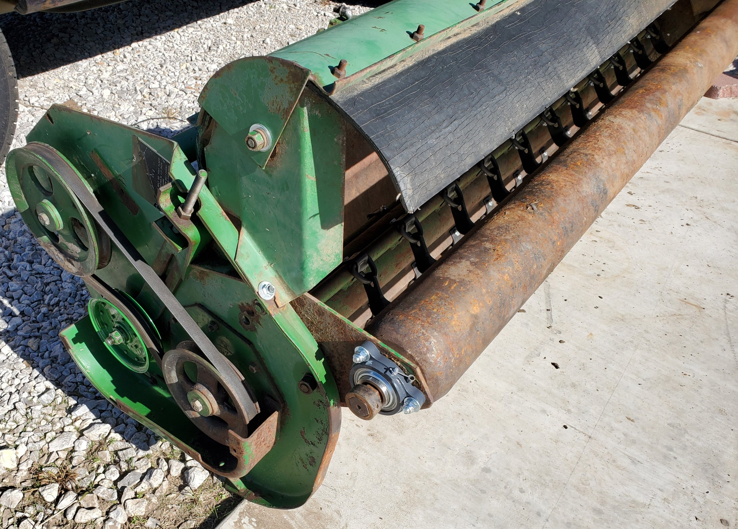

Purchased for $900 and after a bit of a delay, I finally got the 25A finished up and working.
All new flails and mounting hardware.
Welded cracks in the main housing due to a loose gearbox.
New bearings and housings for the roller.

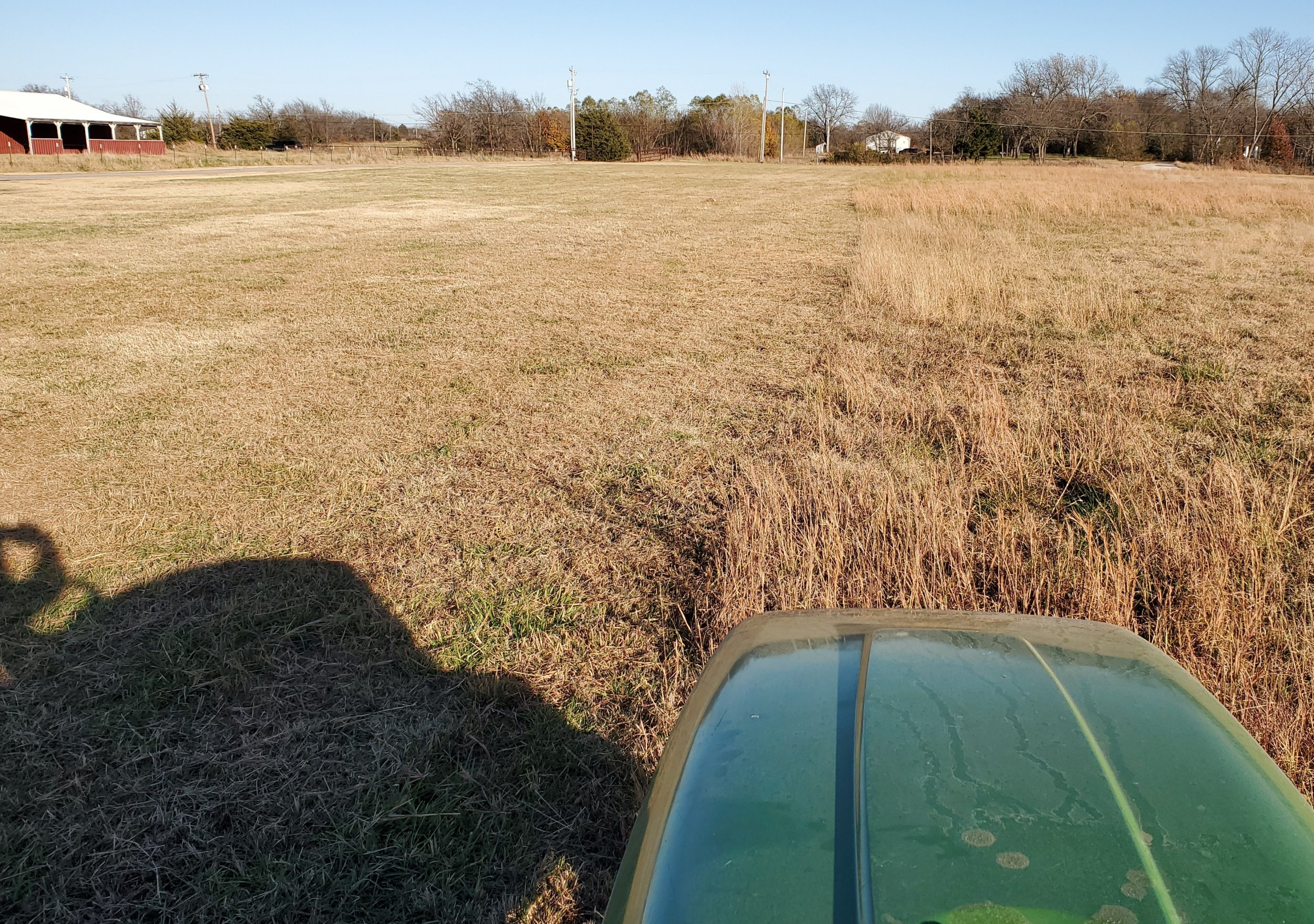

Set at a 2-inch cut height and it did a great job on a 10-acre field.
Great flail for larger areas but transporting it is the issue. Too wide for a conventional trailer.
