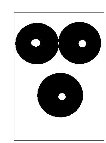

My dealer suggested 3 hockey pucks bolted to each foot. He says it works just as well as the ones he sells. Now, beeing a good canuck, I've got dozens of them lying around anyway, but I've yet to actually try it.
   / John Deere 260 Backhoe Street Pads
I'm having a hard time imagining the hockey puck idea. How would they be oriented? Stacked or put together in a triangle on top of a block of wood? Oriented sideways so that the curved edge touches the ground?
   / John Deere 260 Backhoe Street Pads #6
They would lie flat under the foot, no wood needed. Just put a hole through the centre to bolt it on, counter sink the bolt head and bolt it through an existing hole in the foot. My dealer said guys have used 3 pucks and it worked really well, but if 4 fits, go with 4, the more the better IMO.
Here's what I mean, excuse the 30 second drawing in paint, I think it'll still get the idea across.
