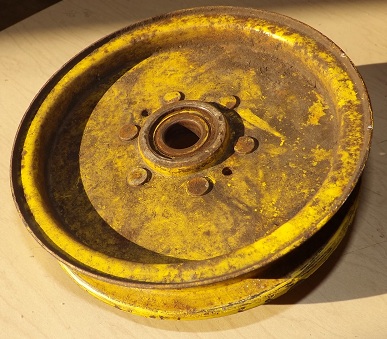

Fast forward to this week as I went mowing the pasture at the end of the season down here, the belt had started SMOKING. I had then torn the mower apart once again. The two flat idle pulleys seized up their bearings now. :rolleyes: The problem is, these pulleys are not cheap at all, nor the size readily available. The flat pulley diameter is an odd 5.5-inches vs. the standard 5-inches found on most mowers.
So, has anyone ever taken the rivets out of a flanged flat pulley to just replace the bearings? If so, what did you use to fasten the two halves back together again?

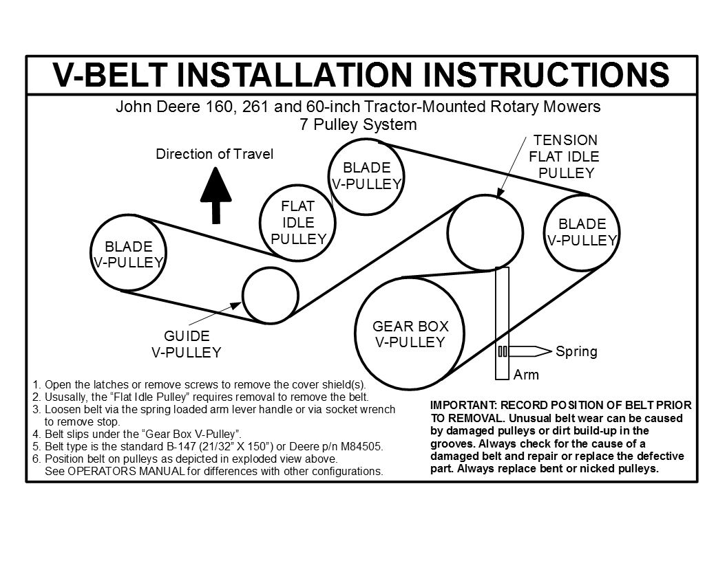

Here is the JD-261 belt and pulley install diagram too.

I'd try to make use of the 5" idlers and alter the belt tensioning link to take up the slack. Or, find some bearings and use steel pop rivets to put the halves back together. I use 1/4" steel pop rivets for a lot of similar assemblies. You need a special rivet 'puller' to squeeze them, though. Available at most auto shop stores. They are used in doors etc for a number of applications. Or, just use some short bolts and nuts. Grind off the extra length.

I like the idea of the steel rivets or the short nuts-n-bolts. I've already grabbed 3/8-16 stainless bolts, nuts and washers that fit through the spindle shaft bearings. Those were rather hard to removed due to the rust.
