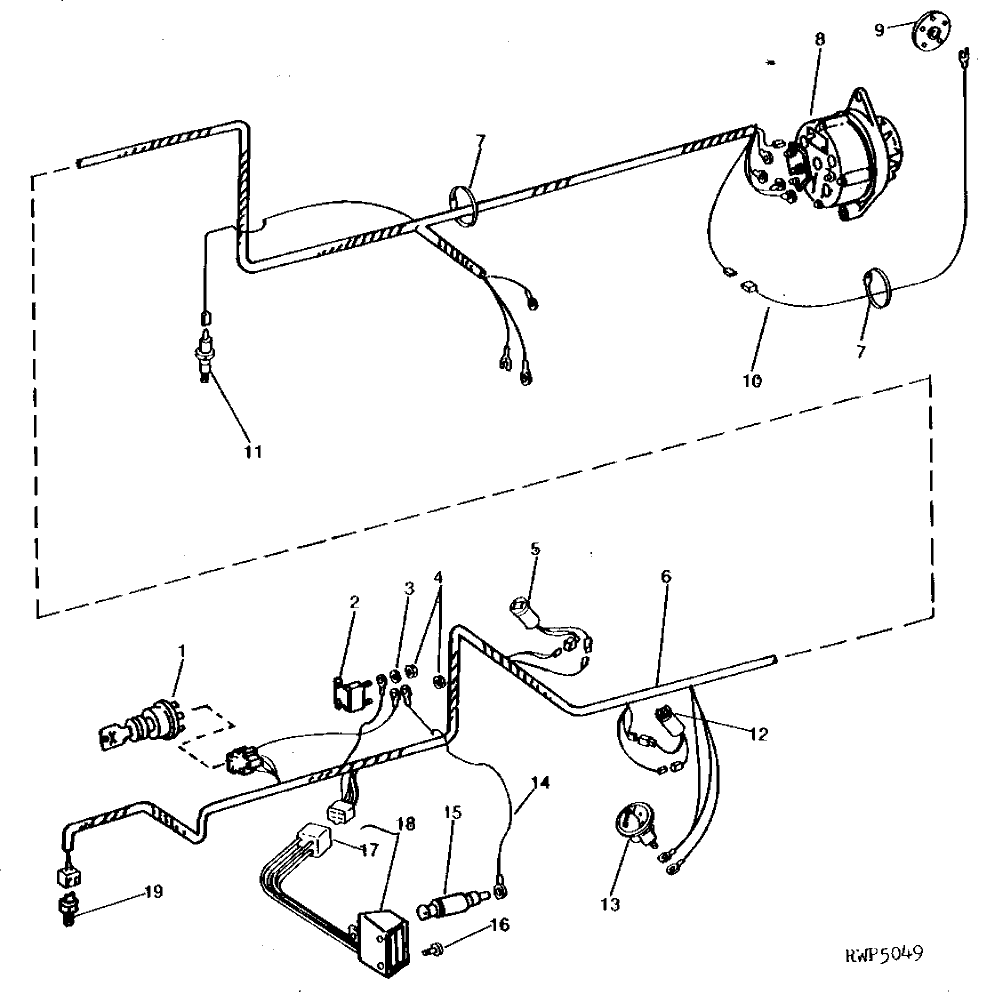

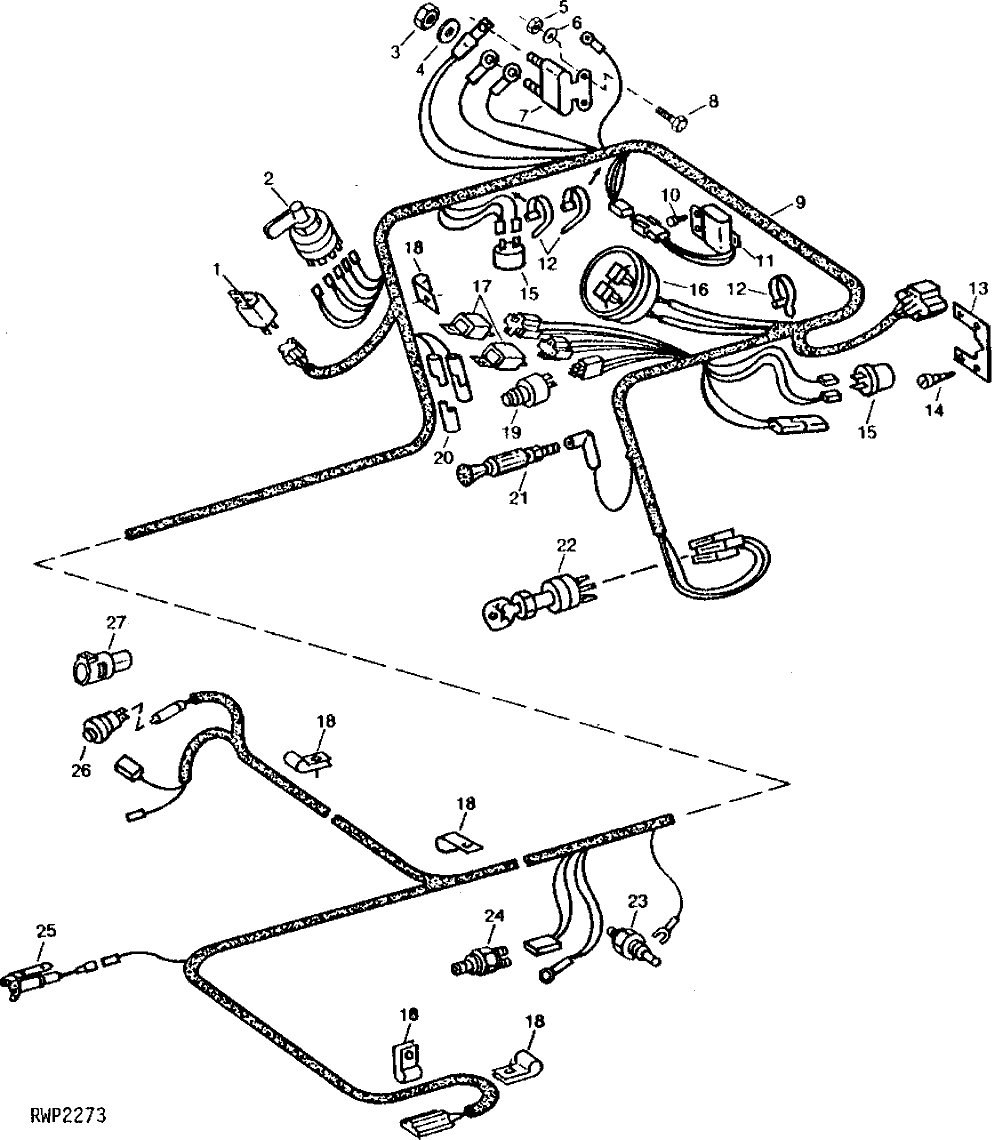

They DO have a circuit breaker. Search part number AR28403 or search for "main electrical harness"
Key 2 in first drawing serial number 340,999 and lower. Key 7 in second drawing serial number 341,000 and higher
If not the circuit breaker, check the ignition switch, then the light switch. My guess is ignition switch failed.
