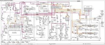

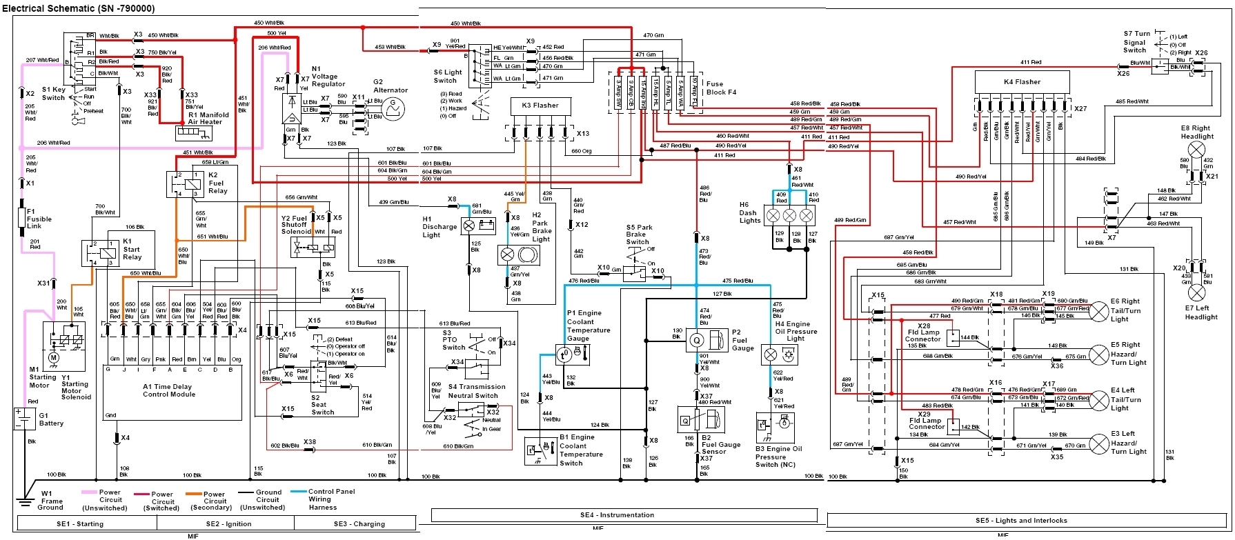

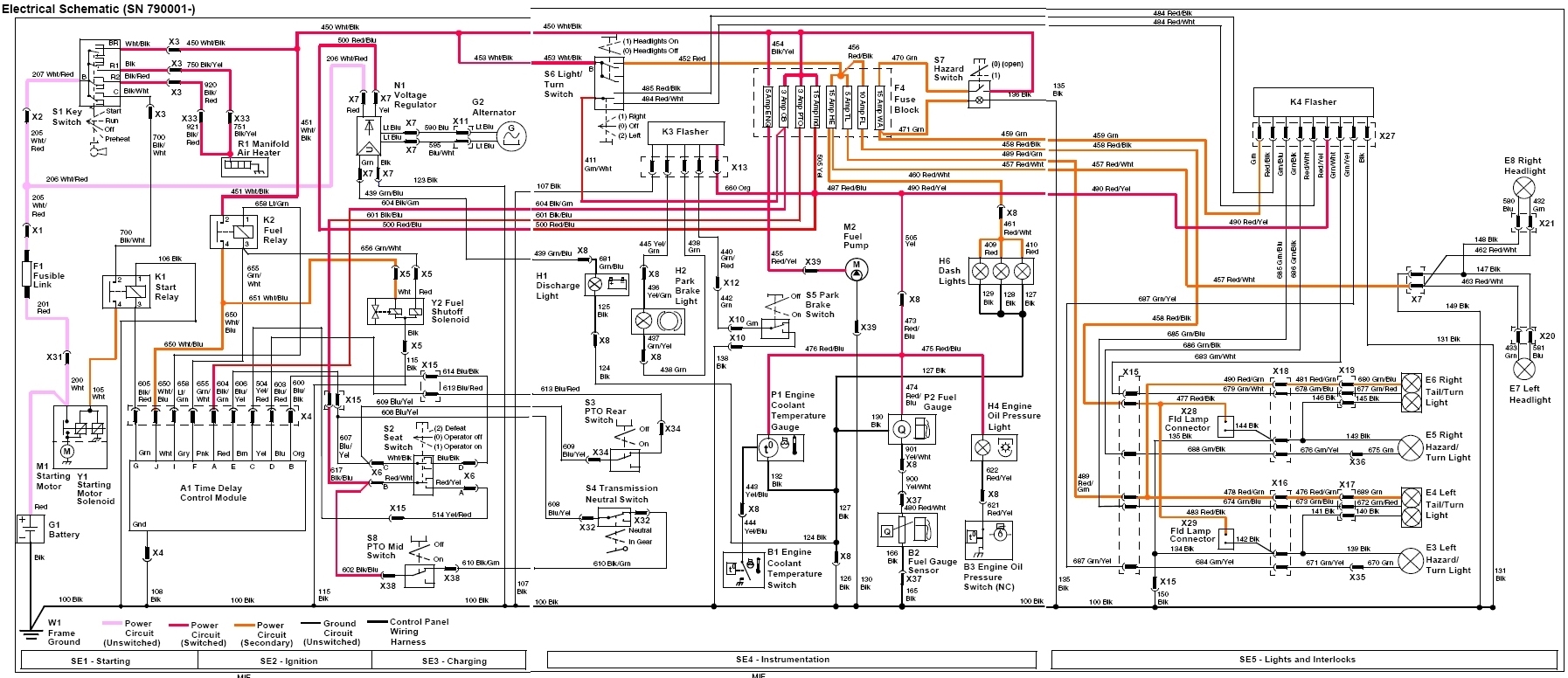

Does anyone on here have a wiring diagram for a J.D. 3005? I have a 2007 790 and I believe the wiring is exactly the same. All of the wiring diagrams I get for the 790 are for the older models. I have an 07 and in 08 they changed from a 790 to a 3005. The 790 with serial numbers beginning with 390, 470, 570, and 670 are all the older models. my model begings with 190, which is for the 07 model year. I believe the 04 to 07 model years might also be the same the 04 starts with a 790, the 05 is an 890 and teh 06 is a 900. Hope someone has the right diagram. I have been having issues with the lighting and would appreciate if I could get a diagram to maybe help me out. I have no head or tail lights, and no signals or flashers. Just bought a new headlight switch today and it didn't fix the problem. Tested all the lighting circuits from the battery to the fuse block with a hot wire and they all work fine, so I would like to see an entire diagram of the system so maybe i can look for something else. I appreciate any help I can get. thanks!!

My manual is for the 2004 year model, and like you said, serial # 790000
Here's a shot of the wiring anyway, 2 versions, 790000 and below, 790001 and above (I think I got that right)

not sure if you got my private messages, but thanks for the drawing. i have a buddy helping me with it. hopefully we can figure it out. thanks again. :thumbsup:
