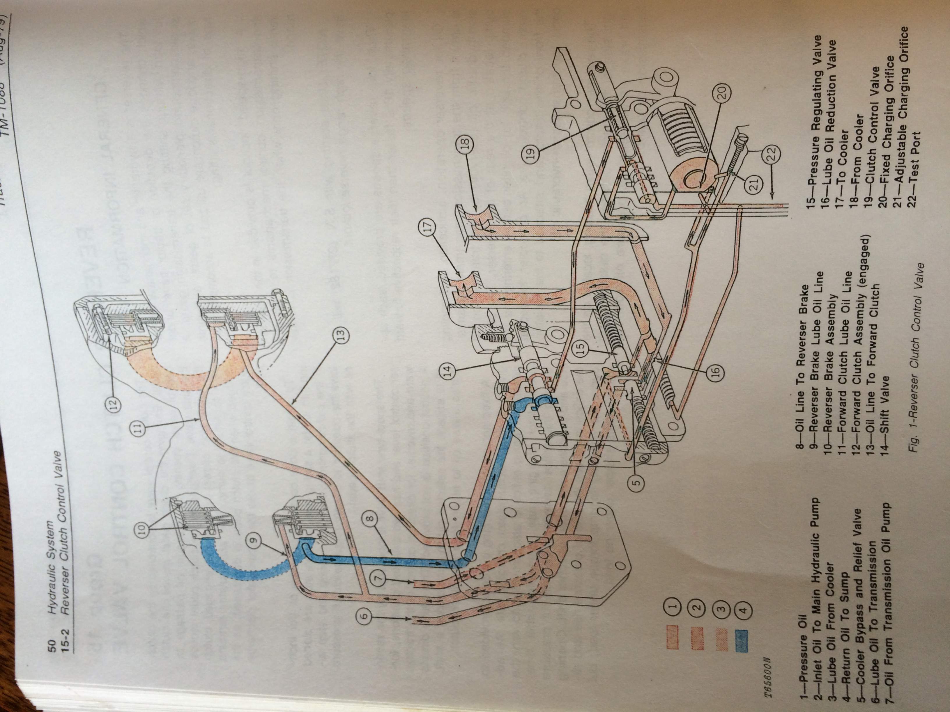

I'm new to the forum and have a tractor issue that has stumped me.
Last week I was using my tractor and noticed that it would go forward but would loose forward motion under load while climbing hills, pushing dirt etc. It had full power in reverse. I got an oil gauge and checked the reverser pressure. With tractor in park, I had 150 lbs in neutral, 150 lbs in reverse, 25 lbs in forward. So I figured I had a bad seal in the forward clutch pack of the reverser. I broke the tractor in two, pulled the forward clutch pack, put in new seals, and rings, put it back together and now...
I have 150lb in neutral, 150lbs in forward... when I shift the reverser to reverse the engine loads down and stops. Mind you the tractor is in PARK. If I put the tractor in a forward gear instead of park and move the reverser lever I get the following: shift to forward I go forward, shift to neutral I for FORWARD, shift to REVERSE I go FORWARD.
So I thought maybe I did something wrong with the clutch pack and it was frozen up, so I broke the tractor apart again. Leaving the forward clutch pack in place I can still turn it by hand with the tractor in PARK, put the tractor in gear and I can still turn it with a little more resistance, so I am assuming the clutch pack is not frozen up like I was afraid of. If I engage the PTO and turn the clutch pack the PTO will turn.
I have the Tech Manual and it shows a Reverser Brake Assembly that I am assuming is in the housing between the forward clutch pack and the transmission, could it be that part?? Any help would be appreciated, I am lost. The reverser is over my head, I'm used to tractors that you just shift forward and reverse. Thanks

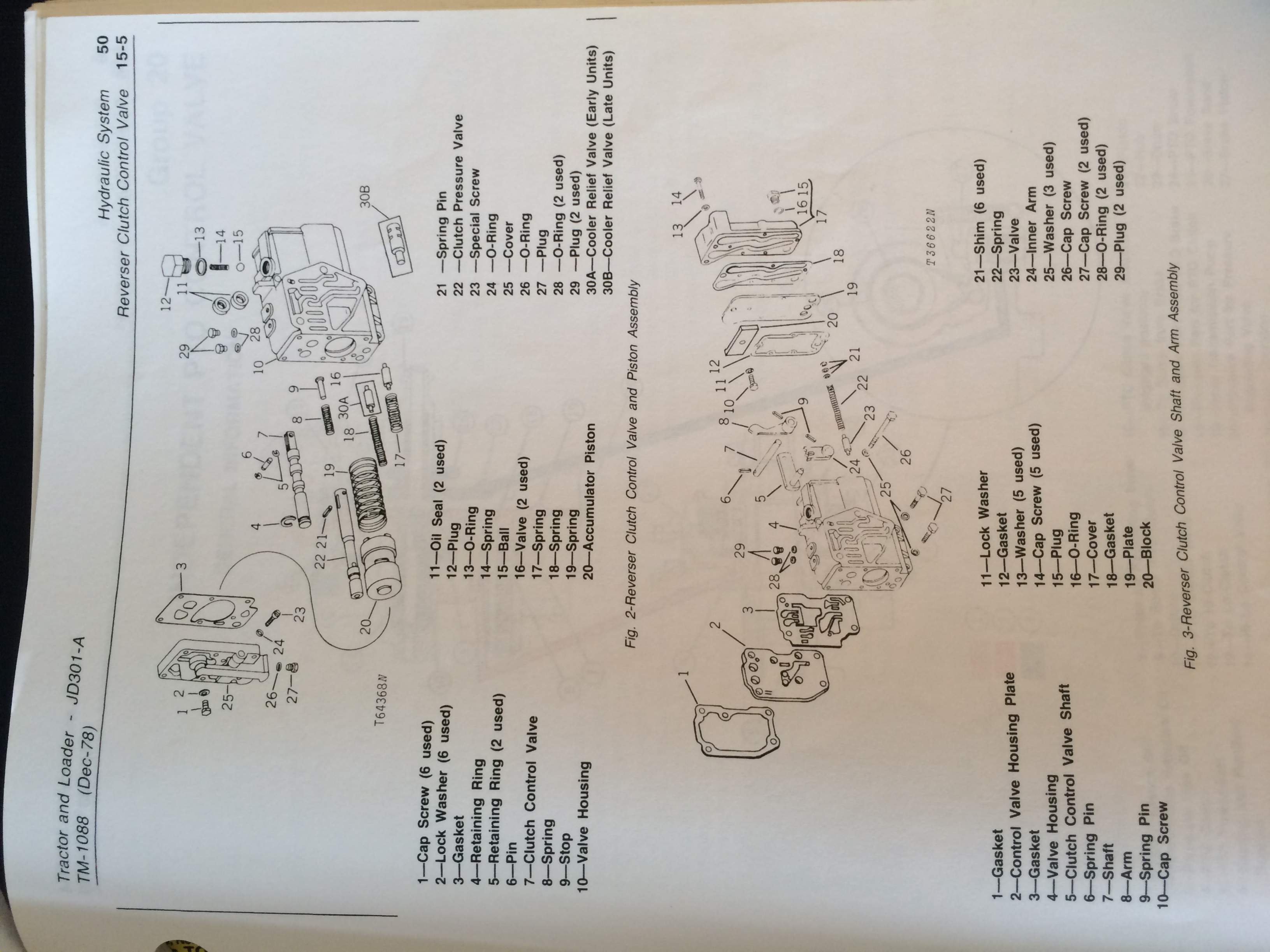

I pulled the control valve off and disassembled it. I didn't find anything obvious other than the input shifter shaft is bent (#5 in the lower parts diagram) but it was shifting it to each detent for forward, neutral and reverse so I don't know if that was a factor. Do you know where I would find the seal between the reverse and forward clutch? Is it in the control valve? The only thing I see is the valve (#14 in hydraulic flow diagram) that shifts oil from forward to reverse. The bent shaft controls #14. In the tech manual I see a "forward clutch pack" and a "Reverse Brake Assembly". I assume the "Reverse Brake Assembly" is the reverse clutch, it looks like one in the diagram. Thank you for your help, I'm having trouble understanding what is causing the problem. Hydraulic diagram.jpgParts Diagram.jpg

Your knowledge is definitely greater than mine. I have ordered the gaskets to put the control box back on and repair the bent shaft, I guess I will get that put back together and see how she does, if that doesn't do it I guess I will have to look at the reverse clutch. I was trying to avoid opening that housing if possible. Thank you very much for your help, I will let you know how it goes.
