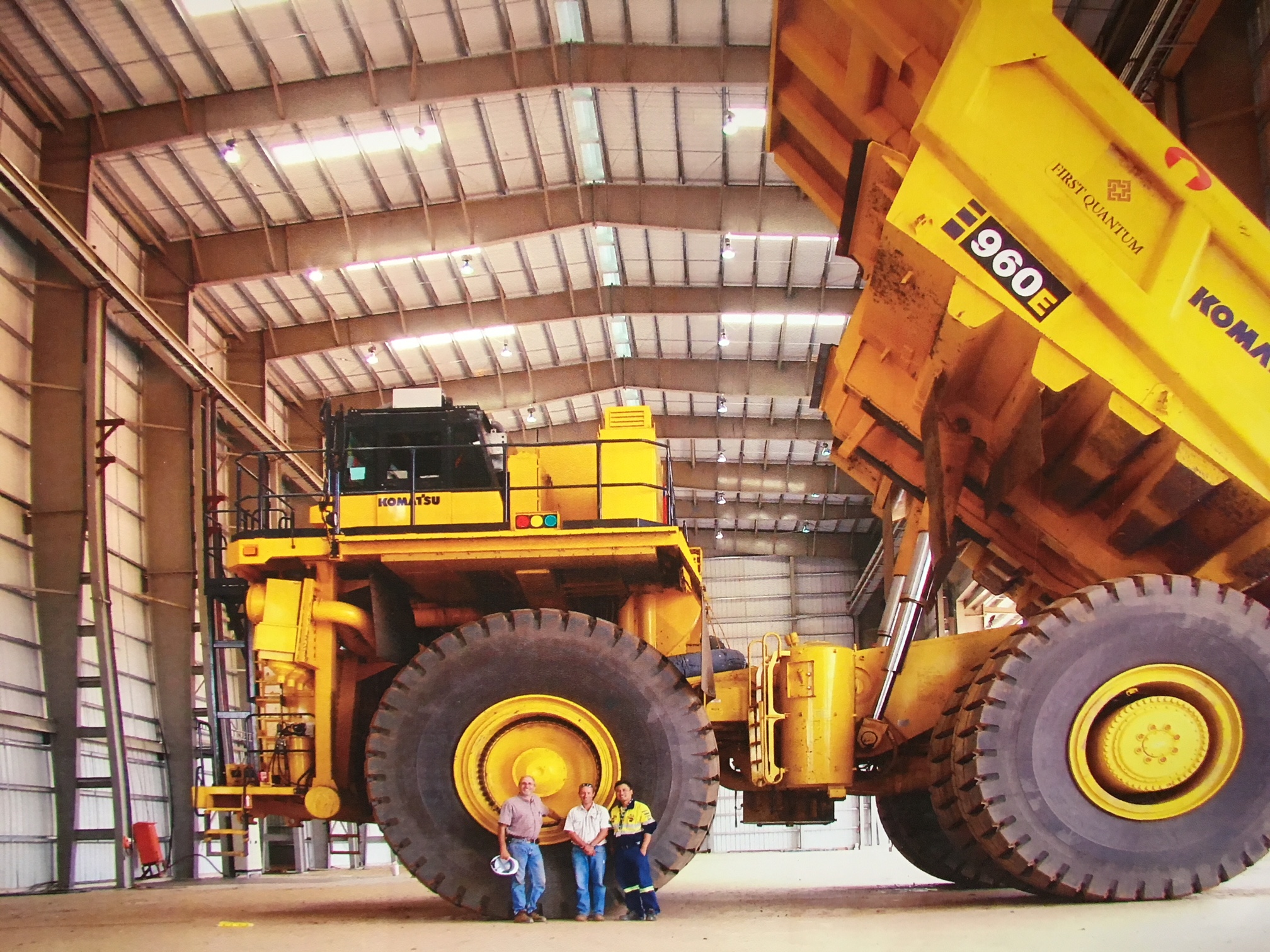

Thank you for your input. I will check it again at the priority valve. I see you are from S. Africa. After I retired from Komatsu I spent time in Zambia implementing Komatsu haul trucks, dozers, and shovels at FQM Kalumbila. I have a lot of friends in S.A. I hope you are keeping safe.
