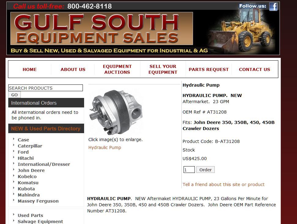

I have a John Deere 350 dozer and today I noticed it spraying hydraulic fluid every where. Got it back to the barn and took the grill shell off and saw that the hydraulic pump case is cracked. Fluid flying everywhere. Does anyone know where a guy could possibly buy a used one at a bulldozer junk yard or would I be further ahead to just go to the JD dealer and take it on the nose? I've been looking on the web and it sounds like it is a Cessna pump that JD used. I wonder if I could get the Cessna number if I could buy one somewhere besides a JD dealer and maybe save a buck or two. Thanks in advance for any and all advise and suggestions.. RRM

Look on the flange of the pump for the pump number.
If you know the pump size, bolt hole spacing and shaft size, you might be able to find a replacement pump.

Here's a pump I found on Google.

Gentlemen, thank you very much. RRM
