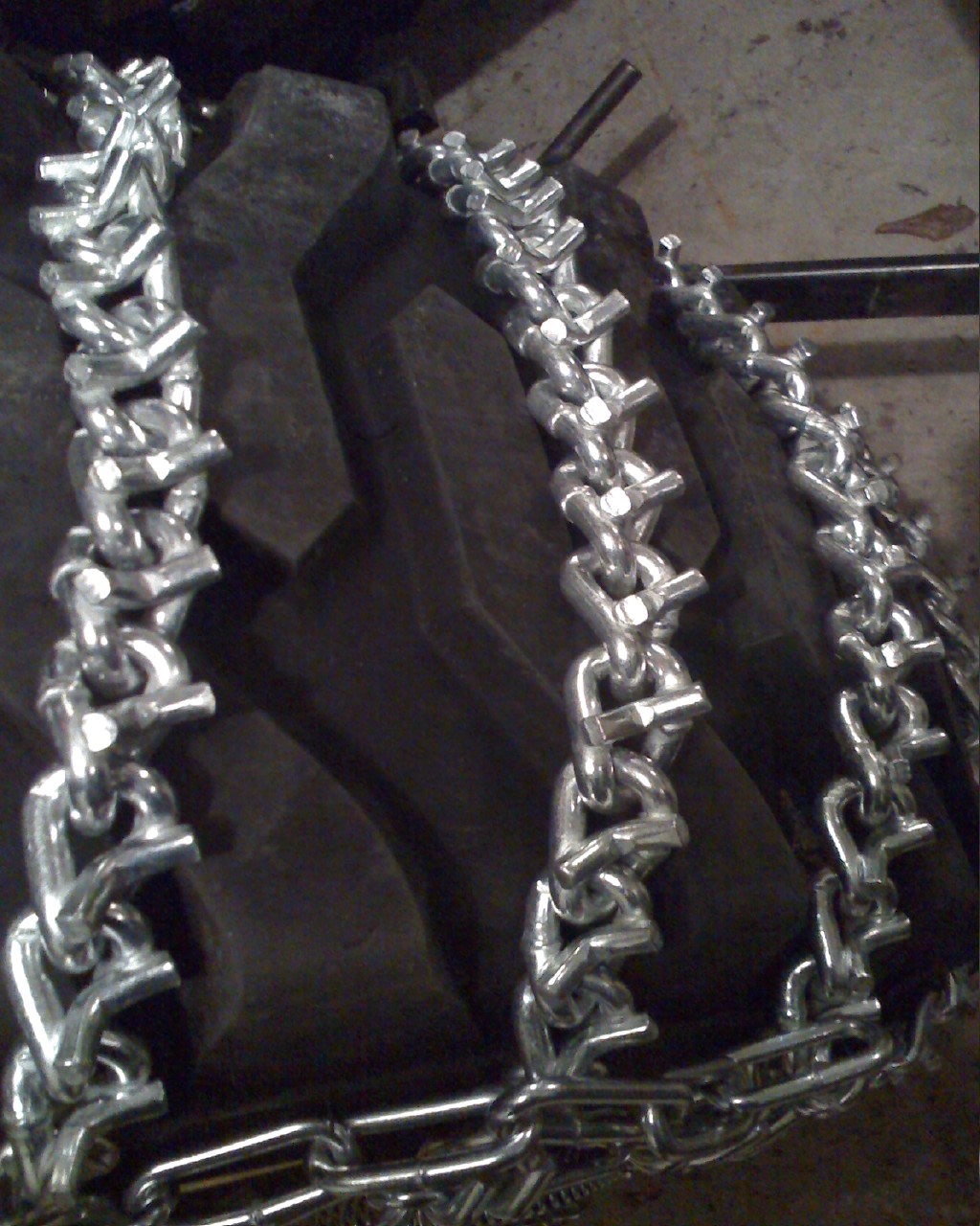

Mine on my 2520 do WONDERS!!!!!!!!:cool:

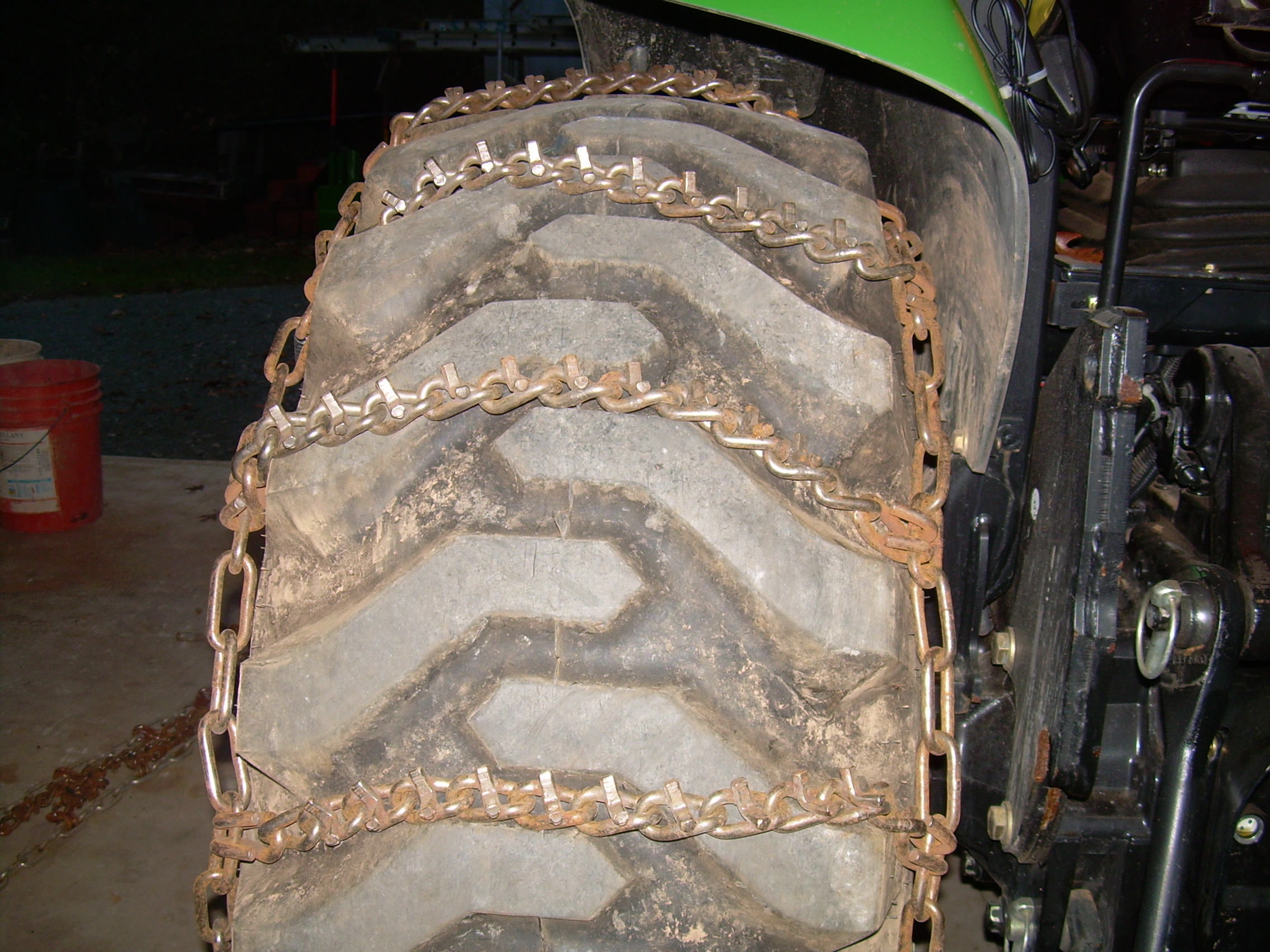

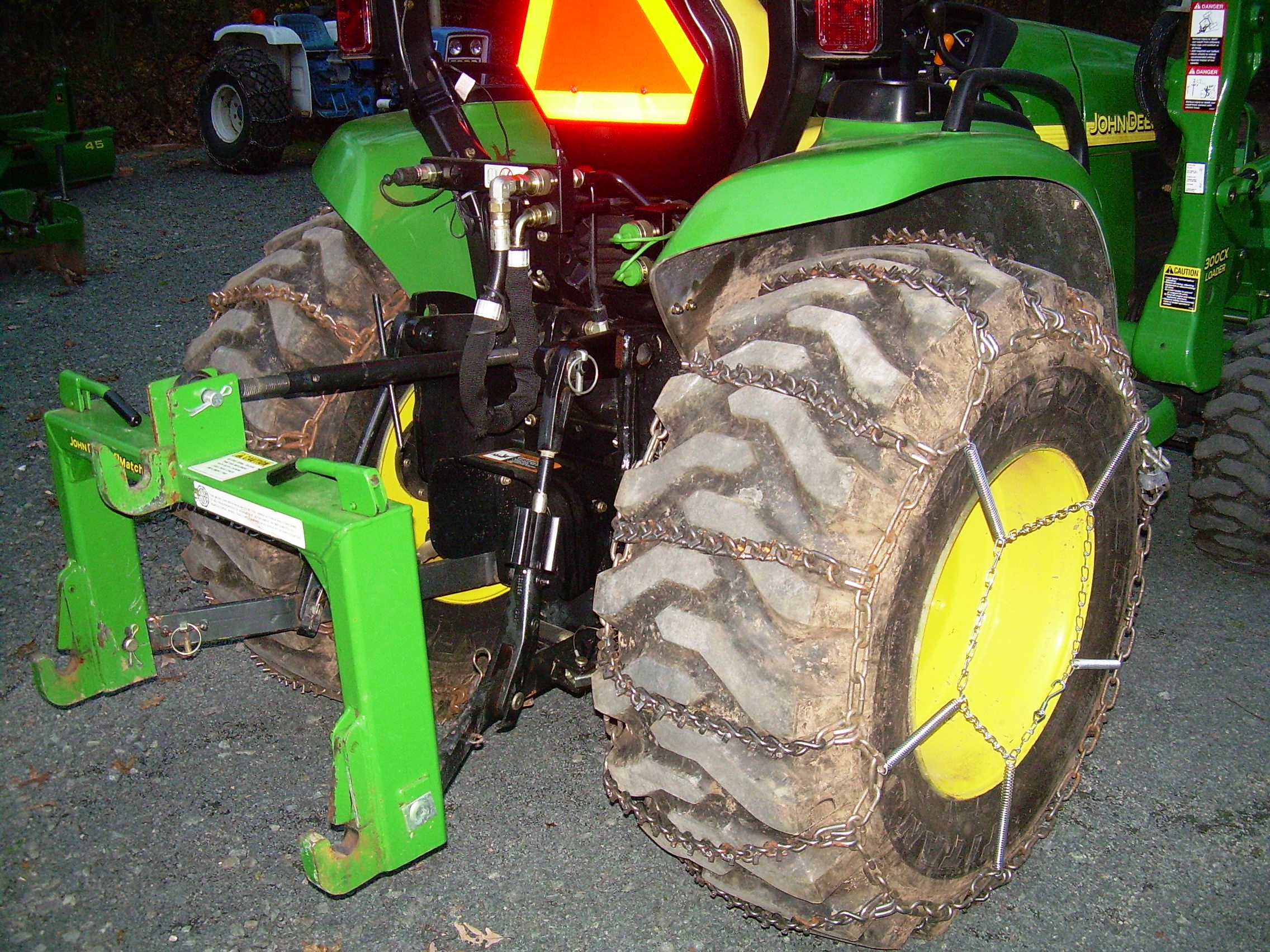

I had to swap rims side to side for inner fender clearance (also some vulnerable hydro lines) on my 4310, was easy but mine were not filled, just be real careful keeping them upright when moving them. If they start to go don't be a hero and try and get between them and the floor. An extra set of hands might be advised.
You only gain that little that you need for the chains, hardly noticeable, I was gonna swap back after the winter but figured it's a little more stabil like this so just left them wider. Only problem is the rim isn't as nice looking on the back side.
Congrats, with 2 link spaced V-bars you just turned your CUT into a Dozer.
Pics shows after, as you can see not much difference.
