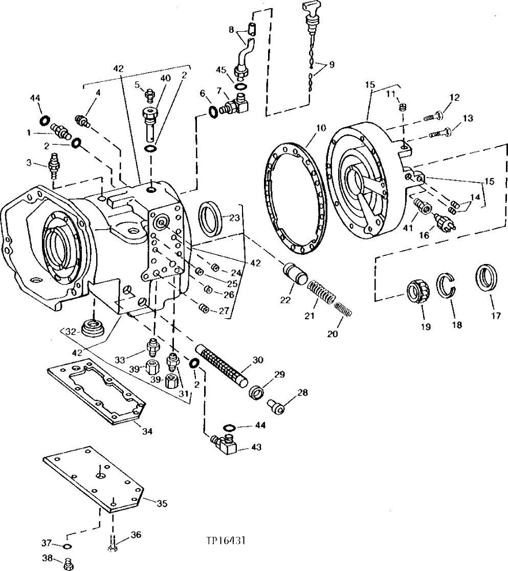

where is the hydraulic tank located on a 1986 john deere 410c turbo backhoe? I also cannot seem to find the fill cap or dipstick? any help would be appreciated.
-thanks chris
   / john deere 410c backhoe hydraulic fluid #2
hyd oil dipstick parts key #9. I couldn't locate hyd oil filler cap in parts schematics.
That seems to show the dipstick going into the shuttle, i would think there would have to be a hydraulic fluid tank? As it holds 21 gal of fluid.
   / john deere 410c backhoe hydraulic fluid #4
The trans/differential housing/hyd system is the hyd reservoir.
