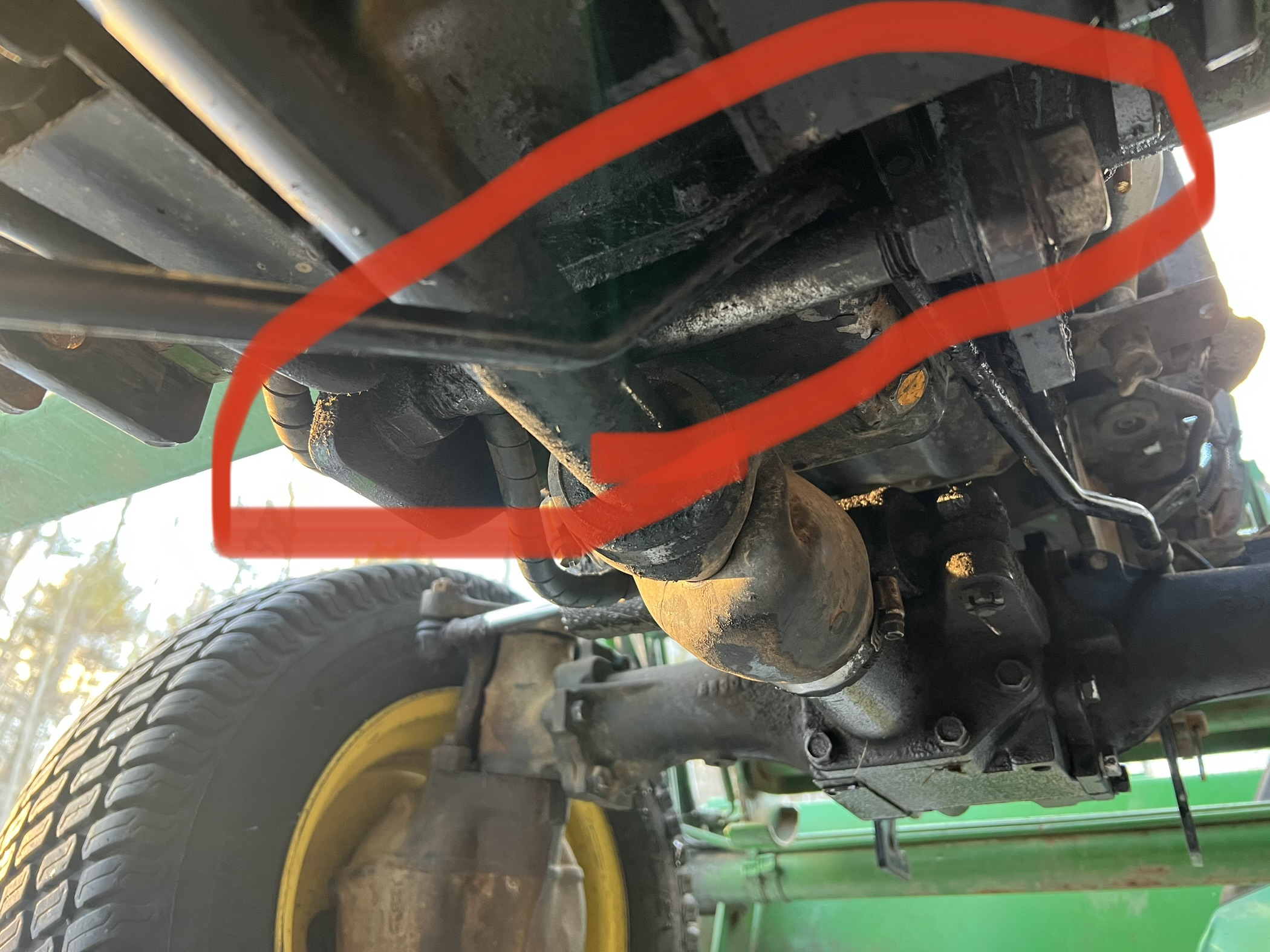

Hi there, I’m about 7 years late to the party, but I’m trying to change my oil tube LVA800157 on my 1998 JD 4100. Changing the tube out I’m struggling with where the tube goes over a large bolt right around the middle on the underside of the tractor. The tube has a bunch of bends in it and I can’t snake the old tube out or the new one in. Wondering if I need to remove that bolt or if I’m missing something. Thanks if you’re still on here and have any suggestions.

It would appear that you are correct and the bolt is going to have to come out, never had the pleasure of this repair, maybe someone will speak up who has
