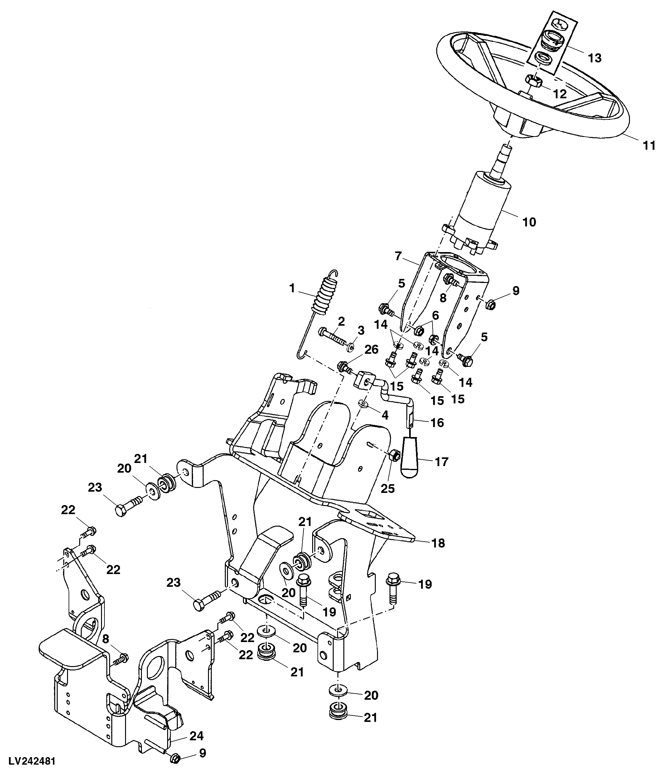

Jul 18, 2015 / John Deere 4200 - steering wheel just spins #1 D Donnie7 New member Joined Jul 18, 2015 Messages 1 Location Harrison, Ohio Tractor 4200 John Deere Steering wheel spins freely not turning tires. When front and is jacked up you cannot move tires by hand.
Jul 18, 2015 / John Deere 4200 - steering wheel just spins #2 kennyd Advertiser Joined Jul 6, 2003 Messages 13,755 Location Westminster, MD Tractor John Deere 3720 CAB/TLB, JD455 If your really lucky, the steering wheel is loose on the shaft and not turning the orbital steering valve (#10). Otherwise it could be a bad valve, or the hydraulic pump that's dedicated to the steering.
Jul 18, 2015 / John Deere 4200 - steering wheel just spins #3 DLTTrekkers Veteran Member Joined May 12, 2014 Messages 1,587 Location Paarl South Africa All hydraulics gone ? or only steering ?
Jul 20, 2015 / John Deere 4200 - steering wheel just spins #4 P pat32rf Veteran Member Joined Jul 21, 2004 Messages 1,986 Location Bancroft, Ontario Tractor JD4300 The piston rod in my steering cylinder came unscrewed. The replacement cylinders are rebuildable but not my original....
