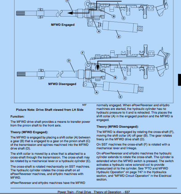

JD 4310 want come out of 4x4. I think my transmission pin is stuck or broken. Can anyone tell me how to check? The MFWD cylinder is working but the tractor will not come out of 4x4.
I have disconnected the cylinder and there is no resistance on the transmission lever. I noticed that you can pull it out about .5 inch I can move it back and forth and do fill It hitting something.

Check your fuses, you have lost power to the MFWD solenoid. The solenoid has lost 12v to it and defaults to MFWD engaged. If the fuse is ok, check under the floor on the right side near the pedals. The area is very vulnerable to have the wires pulled out of the connectors.
   / John Deere 4310 4x4 want disengage #3
Here's an attachment of the theory of operation of the MFWD. As stated above the default mode is 4wd engaged until the solenoid opens and apply hydraulic pressure to disengage it.
It's either the electrical isn't opening the solenoid, Hydraulic pressure is low to move the shaft out to disengage or there is some issue with the shaft that it is binding up not allowing enough travel for the shaft to disengage.
Good luck let us know what it ends up being. Always try to follow threads closely of tractors I own.

Fixed, the lever had been broken and when put back on the shaft rotated 180 which caused the shifting shoe to fall out of the shift color. Had to brake tractor in half but cost nothing to fix.
