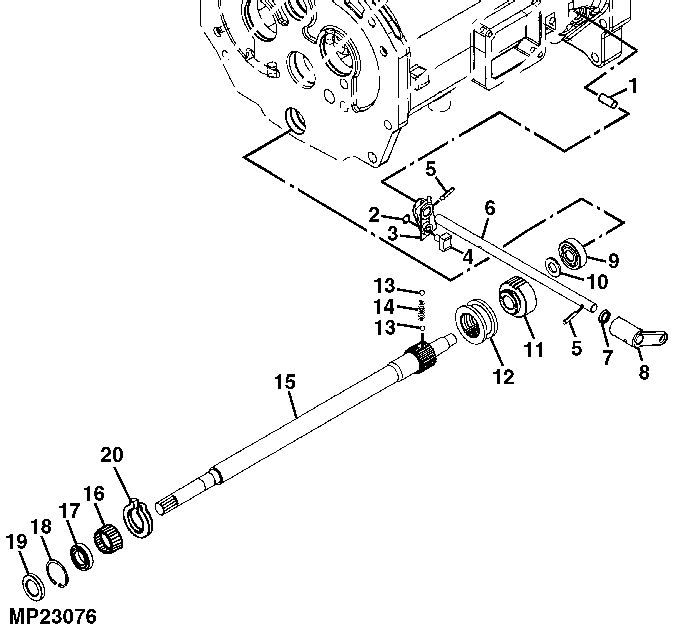

So I recently noticed a small leak from the drive shaft seal on rear end of driveshaft exiting centercase? next to hydraulic oil filter. it seems to be getting much worse very quickly.
The seal is number 19 in image and I was wondering if that can be removed and replaced by just removing center driveshaft section. Has any of you gents tackled this job? it looks kinda tight in there but with some picks, I'm thinking it may be possible. any and all advice would be greatly appreciated.

I believe you can get to it. Use a chisel and small hammer and knock seal in to get it sideways and put new one in. If memory serves me right that’s what I did on the same model!

Ok great thank you good to hear. Its tight in there but i think with middle shaft piece out it should be pretty easy. so the shaft coming out of transaxel stays right? I don't
see how that could be removed with all the snap rings. new seal is on the way so I guess I will find out soon
   / John Deere 4400 driveshaft seal leaking. need advice #4
Yes shaft stays. You can slowly seat seal by tapping it all around

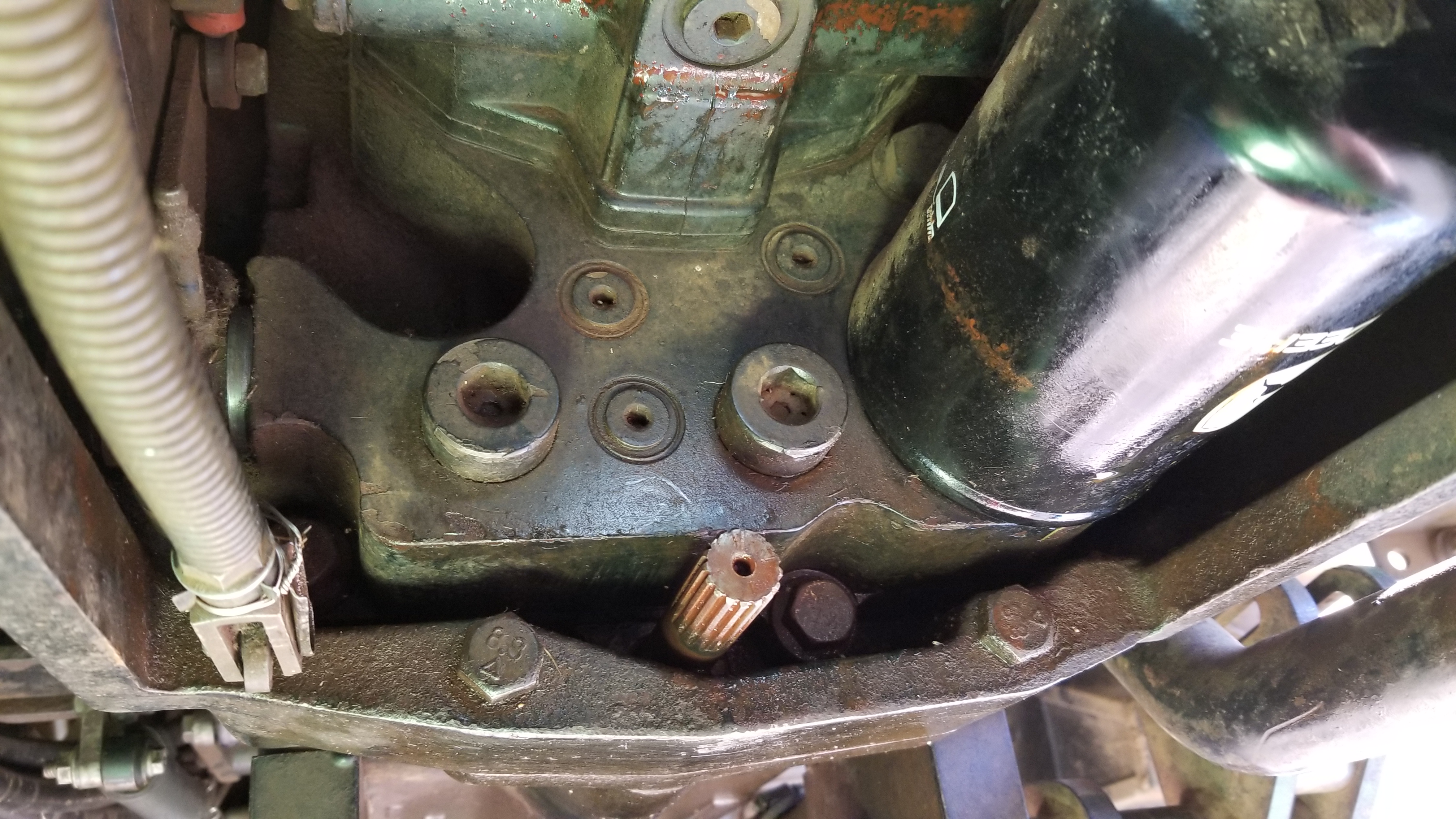

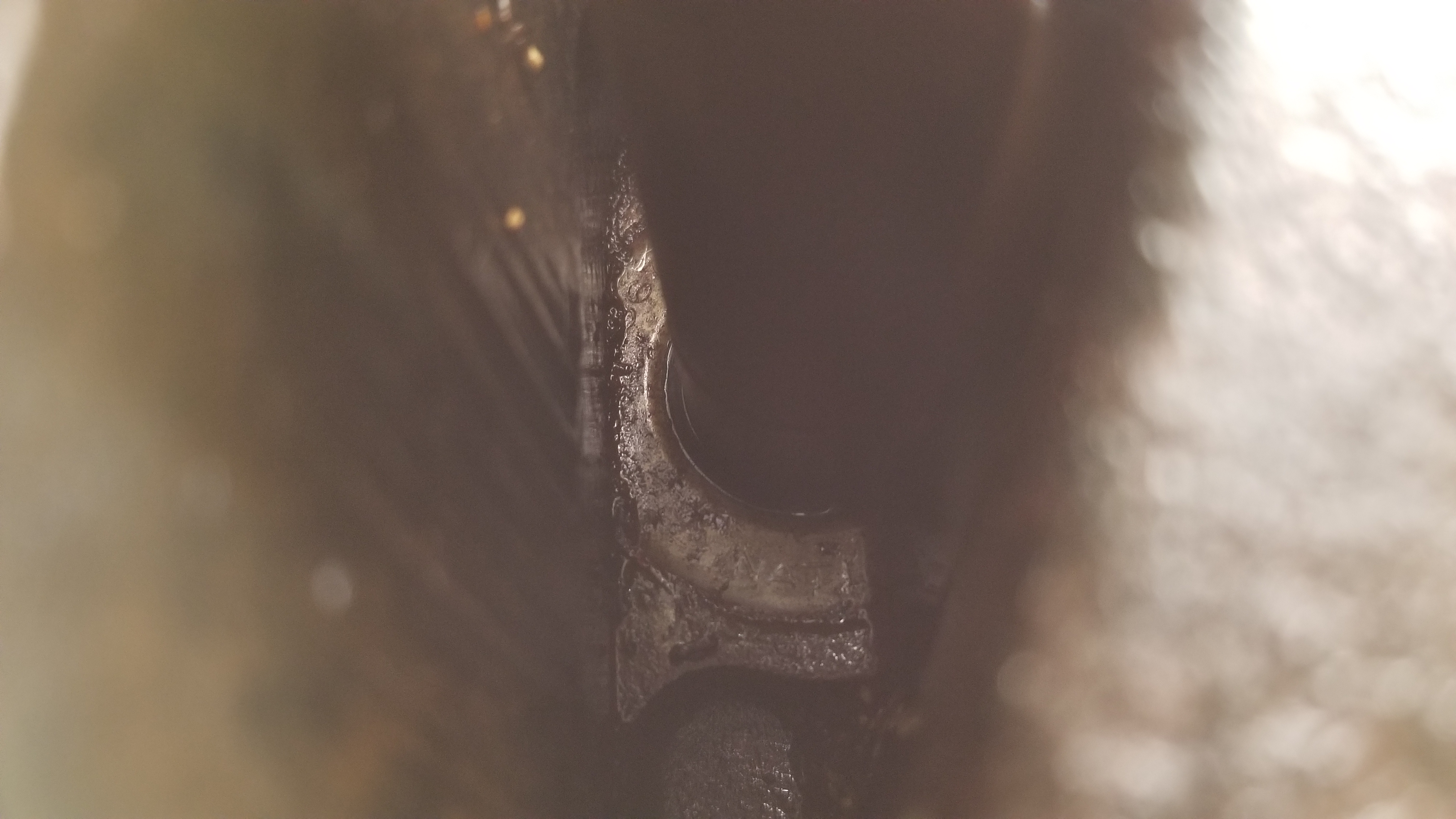

Man much more difficult than I thought, got the drive shaft apart this am to get a better look and it is clearly impossible to get to that seal without pulling the 2 main parts of the case apart. does anyone have a service manual that would show how to get to that seal I have a 4400 2001 model serial is LV4400H440010. any help would be much appritiated.... thanks guys

No worries sisupower, I got in there today and realized after removing axel to get a good look that there was no way to get to it with out splitting. any pics instructions and help would be greatly appreciated. you would think that the seal with so much use would be more easy to access but whatever. good to hear it is not that big of a deal, i got a full shop and pretty confident mechanically. just always feels overwhelming when I realize its not gonna be quite as easy as I thought.
