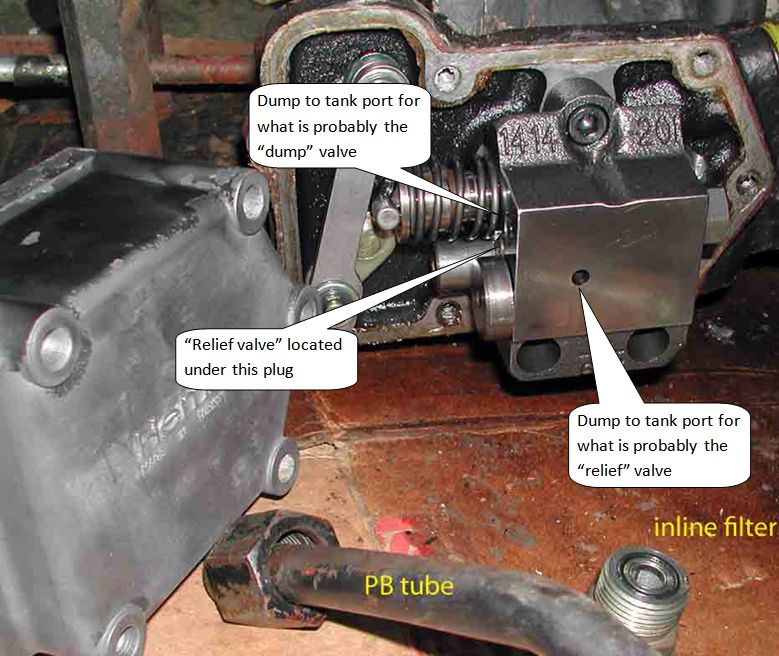

I recently spent considerable time spelunking through these forums trying to find out how to fix the problem with my JD 3-point hitch not lifting any weight. Or only lifting slowly at full rpm. While my only tractor is a JD 4400 perhaps this will apply to others as well. I was not satisfied with the end solution in the troubleshooting guide being to replace the rock shaft control valve at $500 or more.
Bottom line: The valve can be disassembled and fixed if has not been damaged by something harder than the steel. And no springs are broken or seals destroyed.
The first time the hitch would not lift weight was about a year ago. I read here and learned after disassembly that the in-line filter screen (inside of part AM123226) is prone to breaking loose and going downstream into the valve. And so it did.
In the first picture I have named what I THINK are the valve ports based on studying the hydraulic diagram for the internals of it. I will refer to them that way here. If the names are incorrect someone can correct me.

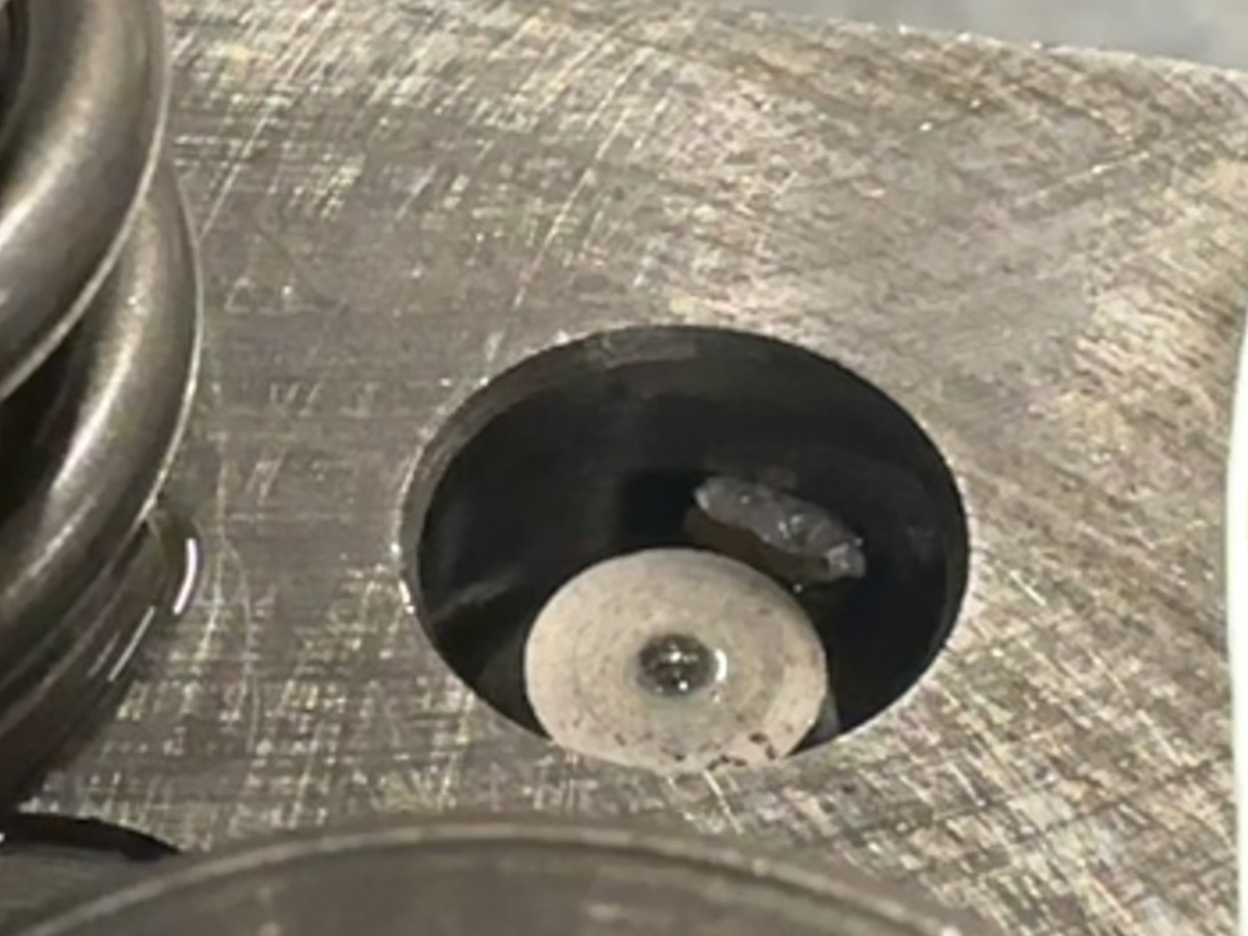

In any case, once the cover was removed it was easy to see a bit of screen sticking out of the dump valve port (see second photo). That valve is spring-loaded from the inside. All I had to do was to hang onto the bit of screen with the needle-nose pliers and then press the valve pin inward with a dowel to dislodge it. I then replaced the inlet part, AM123226, with a new one with a screen in it.

I had missed this valve on the first clean out. It is located under a plug that is overlapped by the large valve cap where a hex wrench goes. I thought it was a press fit but it can be removed with a little prying. First remove the large valve cap with the hex wrench fitting first. And there's the little gremlin (3rd photo). Again, this is a spring loaded valve so you just need to release the screen by depressing it inward a little.

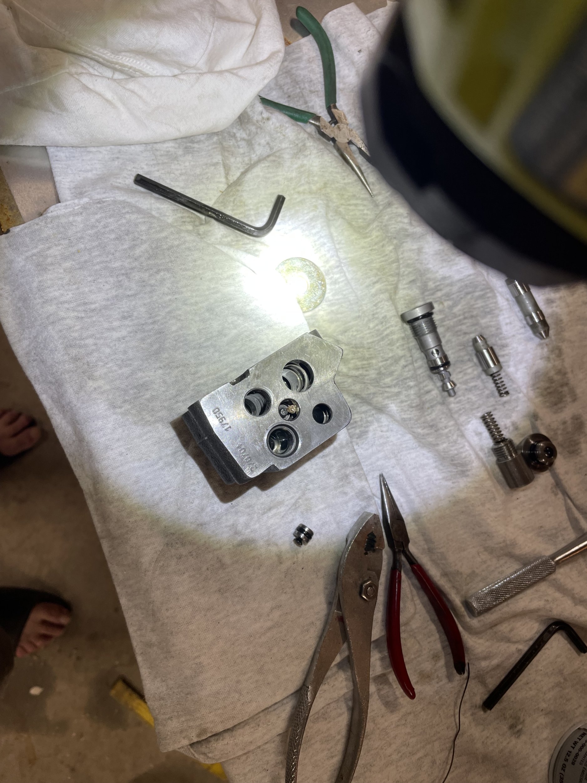

I tore the machine down, leaving the the rockshaft on the tractor and accessing by removing the left fender. I found this in the entrance to the rockshaft control valve. Here is where the screen ended up, along with a lot of bronze. I removed this debris and the control valve. I found one more piece of screen in one of the valves. Put it back together and it worked, sort of. Under idle, no movement, at 2000 rpm would move arms but not with a load. Knowing that my front end loader was working fine, I knew I had pressure but no volume to the rockshaft cylinder, something was bypassing.
Talked with nearest dealer, $750 for a near control valve. Decided to take valve apart again, and removed all the spool valves. Laying the pieces out on a clean cloth and taking pics along the way. I got down to the last valve spool and could not figure how to remove the cap. I finally figured the cap had a hole in center with threads, found a small screw that fit and could grab the screw and pull the cap clear (had an O ring on the cap, very tight). Here is what the problem was. I removed this bit of bronze, cleared the the relief valve. Now all parts were removed from valve body. I cleaned everything and put the valve back together. Put the valve back on the tractor, and it works like new.
