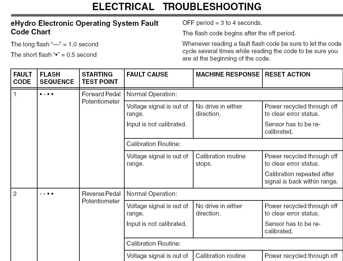

my jd 4410 will not move forward or reverse and the warning light is blinking in blink------blink------blink-blink sequence.what to do ???

Here is one code sequence for the 4410 from the tech manual CD that may be your 2 blinks, space space 2 blinks. See if it fits.
