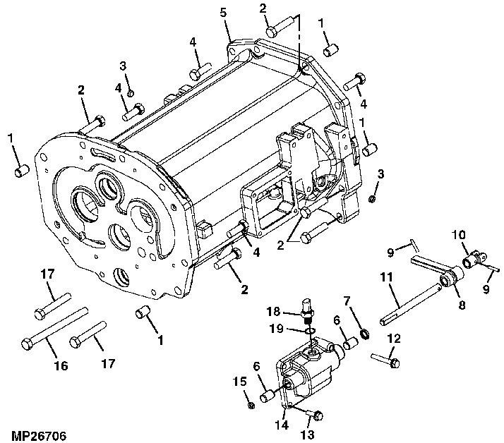

Neutral start switch key 18 in the drawing. I am not sure which transmission, or if both transmission options have/use this switch?

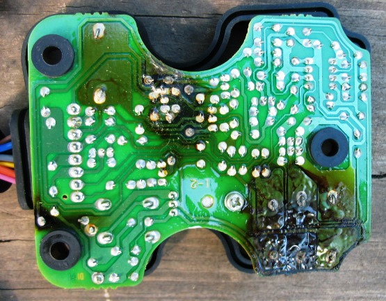

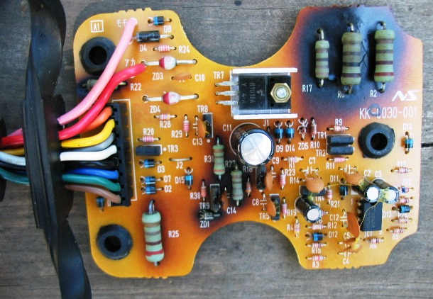

I own a 4110, don稚 know if any of this is relevant, but your symptoms sound familiar. Read this, look at the 4410 service manual "theory of operations" section for starting/fuel and compare---if not applicable ignore.
My starting systems numerous inputs/outputs are integrated by a control module located under the seat. It senses all the safety inputs (grounded to start), switch positions, and turns on/off the fuel solenoid. Solenoid take a higher initial voltage to pull it in, then system reduces the voltage to hold it in when the machine is running. When the ignition switch is turned off, the voltage is cut to the fuel solenoid causing the engine to stop.
My control module overheated when my battery went bad. I suspect the charging systems saw the voltage drop and increased output, causing the board to eventually overheat.
I壇 bypassed all my various ignition lockouts, so ran the problem down much like you did. After swapping out fuel relays, fuel solenoid, cleaning all the various ground point I pulled the control module. It had a definite smell to it, not unlike overheated brake pads. Came apart with a few screws; upon inspection the overtemp was apparent.
What is interesting is your condition where if you jump the starter, the tractor will run for 10 seconds then quit. Strong indication the fuel solenoid not staying open. If so, key will be to figure out why. You致e replaced the fuel relay; assuming that痴 good then the solenoid itself might be suspect or something in the electrical system-----something that痴 telling the control box to shut down (open safety switch) or a faulty control box (bad timer, shorted diode, etc). Post #2 is a good example.
Good luck
   / John Deere 4410 will not engage starter #4
Search this site, or google search using the word “thermister”, very common problem
