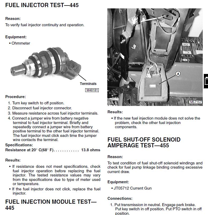

hello, i have a john deere 445 and i am not getting power to my fuel injector, have started checking fuses and connections but no good luck, any ideas?

   / john deere 445 no power to injector #3
Nothing electrical on the injectors.. IF your talking about the electric shut off solenoid on the injection PUMP.. just remove it to SEE if that's your problem.. if it is, the tractor will start..
   / john deere 445 no power to injector #4
Hope billeads comes back for a look.
Agree on the single injector.. shows electrical connect. Also found a fuel injector test.
