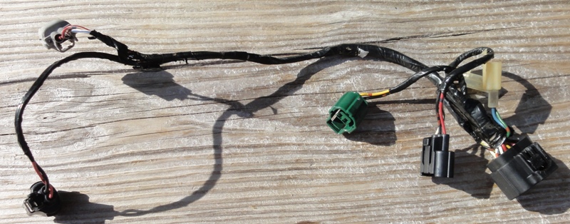

I replaced the wiring harness on mine plus the pins in the connector.
This harness goes to all those expensive sensors and I decided to eliminate bad wiring or connections.
Old wires will get stiff and crack.
I also replaced the wires to the ignition coils.
Replacing the connector is not so easy unless you have a real good crimping tool.
